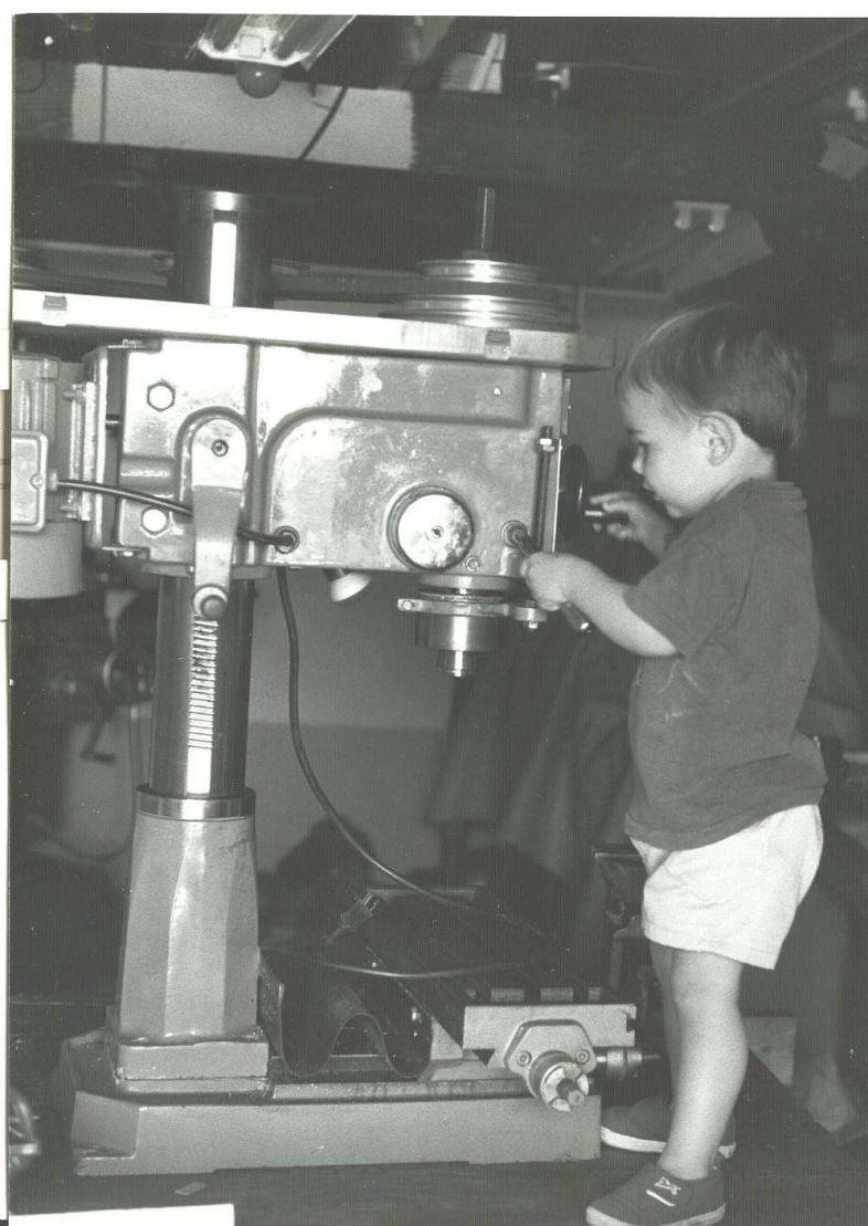

On the distraction of the round column mills
When I was young......
I had a RongFu round column bench mill. That thing made me a lot of money poking holes in aluminum investment castings.
But, every time the head needed raising or lowering (like to change tools) Tram was lost. What a ROYAL PIA!
Call em, nifty HD bench press drills, but when milling, they take a lot of additional time.
I wasn't sad when I sold it. Better machines can do that same work. bnut there is always the "why tie up a $6000 machine when a $300 machine will do the task.
Plus, labor can be had cheap to run that class of machinery. Wait! College was expensive!
(my son, now with a son of his own about that age ;-)

I can honestly say I haven't detected any movement in my Solberga drill press because of it's round column,
I think I could do some light milling on it, if I wanted.
SR

Yes it is, I in fact have "five" floor models, with the pictured gear head Solberga being my biggest one.
Do I need five floor model drill presses? NO, but I'm a tool junkie that just can't seem to turn down FREE or almost FREE tools!
Like yesterday, I brought home two electric chain hoist!
SR
