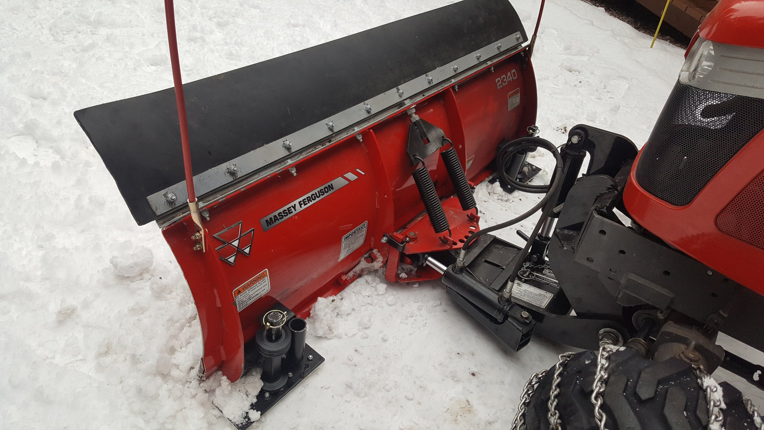

And I also fabricated larger skid shoes (4" x 10") with 3/4" x 4" UHMW on the bottom for my Blade and Snowblower.
Great improvement for a gravel driveway!
Sorry for the sidebar on your "Drift cutters" thread...

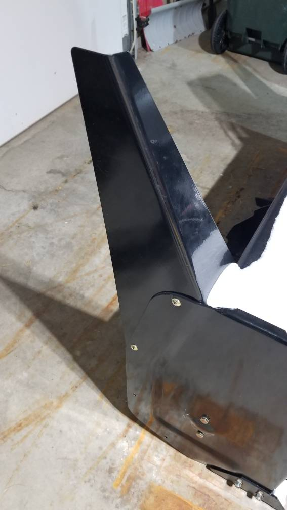

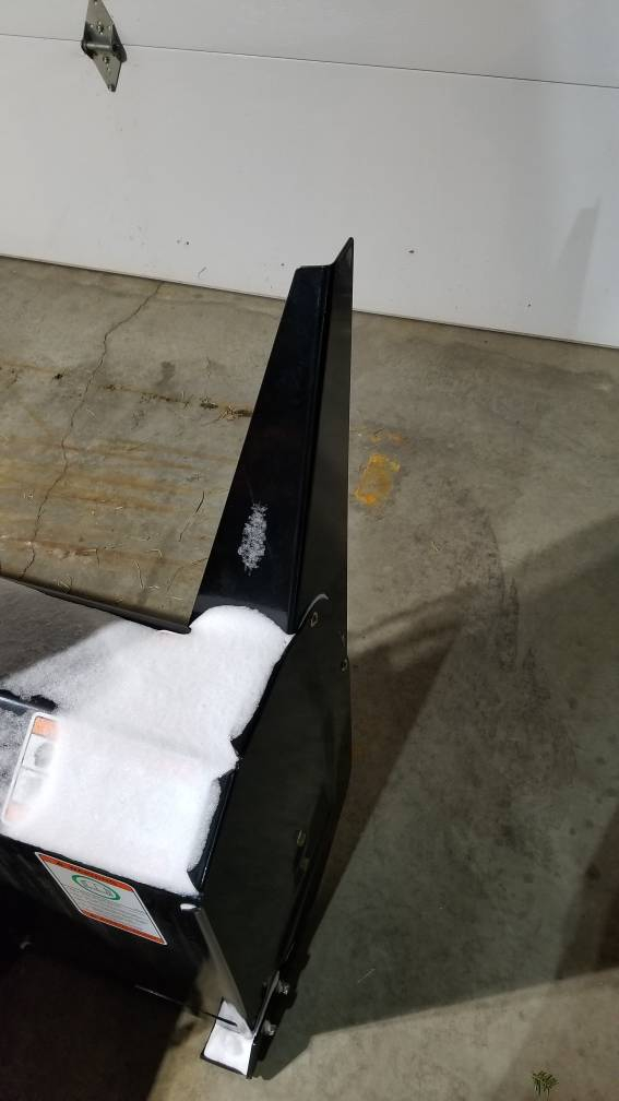

These are the cutters that Bercomac put out for my Pro 1000 56 inch blower. The material is maybe 2 mm thick. But they are very solid because of the 2 sided design. They extend maybe 15 inches above the body. The top is 1 inch wide by 2 inches deep.
