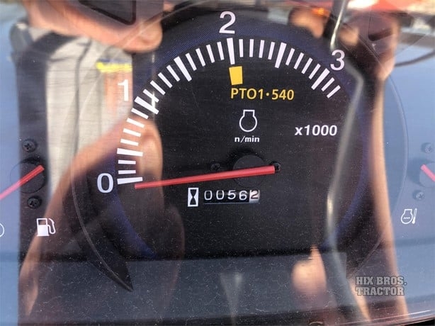

The brush hog will perform much better with the rear PTO turning 540 RPM, which means your engine will be near max RPM, my 5" Bush Hog brand has blades that have "lift " like a regular lawn mower blade, this needs speed to get and keep the grass to stand up to get cut.
IIRC my Massey Ferguson GC 1725 MB engine has a redline about 3200 RPM, the PTO needs about 2900 RPM ... My Kubota L5030 engine has a redline about 2700 rpm, and PTO needs about 2600 RPM.
My 1.1L 25 HP SCUT burns about 3/4 gallon of fuel an hour ...
The L2501 has a slightly larger engine displacement of 1.6L
Here is a picture of a L2501 dash, notice on the tachometer the indicator for 540 PTO at 2000 RPM ...

Ok; sounds like you should be able to take a full about 4.5 ft cut; probably about 80% actively cutting (turns, backing, slowing around trees/fences, ect); i get 1.31 acres per hour. So, 15-16 hours of mowing; or roughly two tanks of full. Maybe running at 1500 rpm (is that the 540E rpm on a l2501?) vs 2200 rpm (the rpm for the pto to be at 540) might save 30% fuel?
Couple notes; 60" rotary cutter in grass is a pretty full load on a 2501; your cut may or maynot be great at reduced speed; you might need the full rpm to avoid bogging. Id pretty much set it at 540 mark or 540e mark, and let her eat

"What is the correct RPM" every tractor I've used, that had a PTO, the tachometer will have 1, or 2 marks for pto. My Kioti has 2 marks; 540E (roughly 1800 rpm if memory serves), 540 (roughly 2100 if memory serves), and it will go up another 200-300 rpm. Now, 540E, isn't actually 540; its more like 480.rpm i think at the PTO but its what they consider "close enough, but most fuel efficent). If Kubota doesnt have two marked pto speeds; then it will have either a range or 1 speed on the tach, and from what I see on Google, its 2000-2200 engine rpm for the pti to be at 540. That is the "correct" pto speed. It doesnt mean you might not be able to run a bit below, and it also doesnt mean you can't press the throttle to the limit, and pedal down

RPM to get 540 PTO speed varies machine to machine, but every one ive ever used shows it on the tachometer. Some its a colored range, some have an arrow and say PTO at the correct RPM. Some its just WFO; but they all have a speed they should run at
