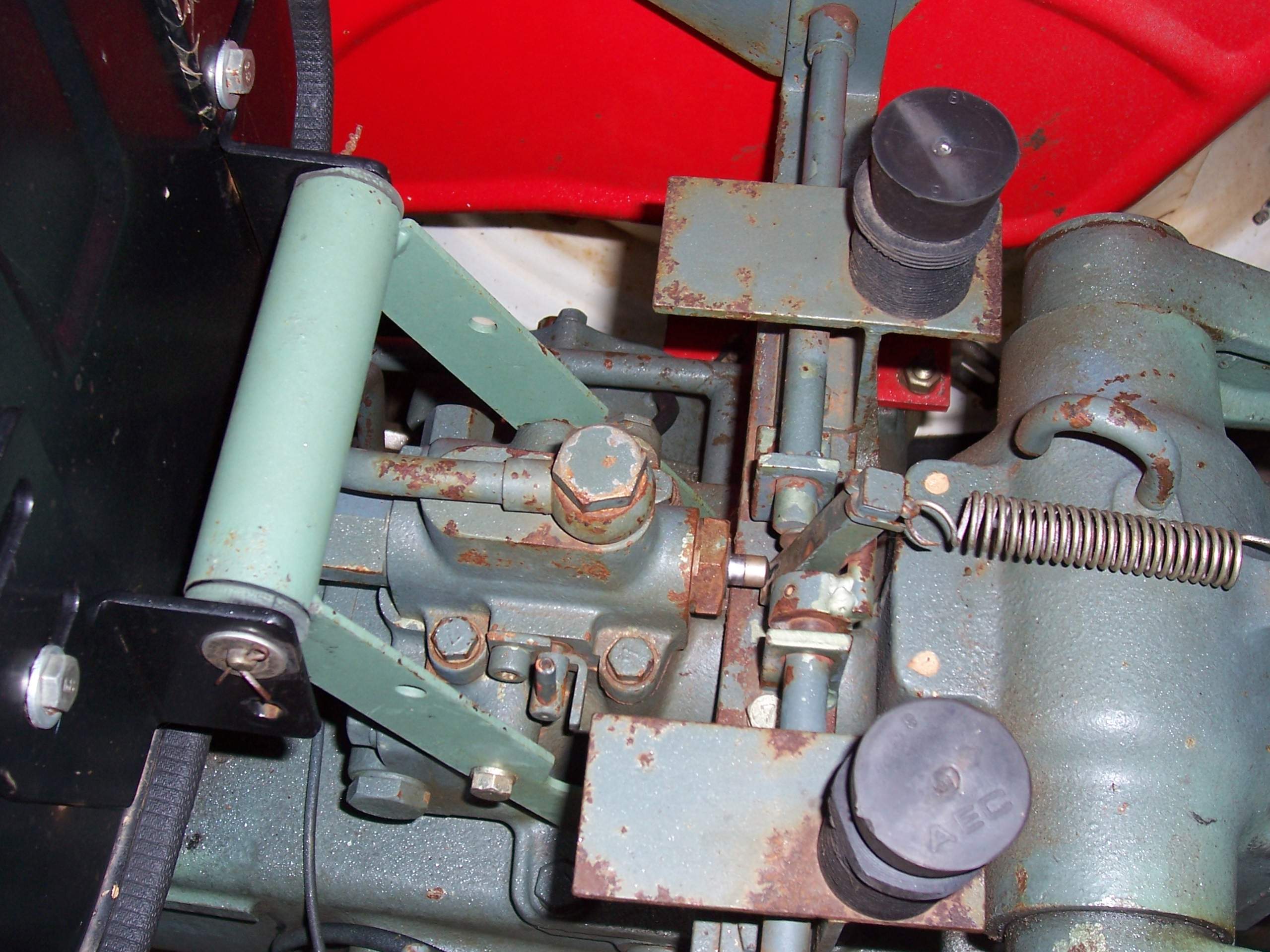

On a Ym 2000 which I have also Up or Down is set by how far or which way you move the handle there is a knob that you screw into the slide/Gap were you lock it is where your handle stops so it won't move lower or higher than that point. ;) and the screw with the pin on mine just bleeds off the valve to let the lift fall in hence Counter clock wise the further back you turn it the lift falls easier/faster mover it forward is higher it the lift goes. After I serviced my fluid and had to replace my ghetto rigged pickup screen it sets perfect straight up.look hard you can see it on the left side of the valve.

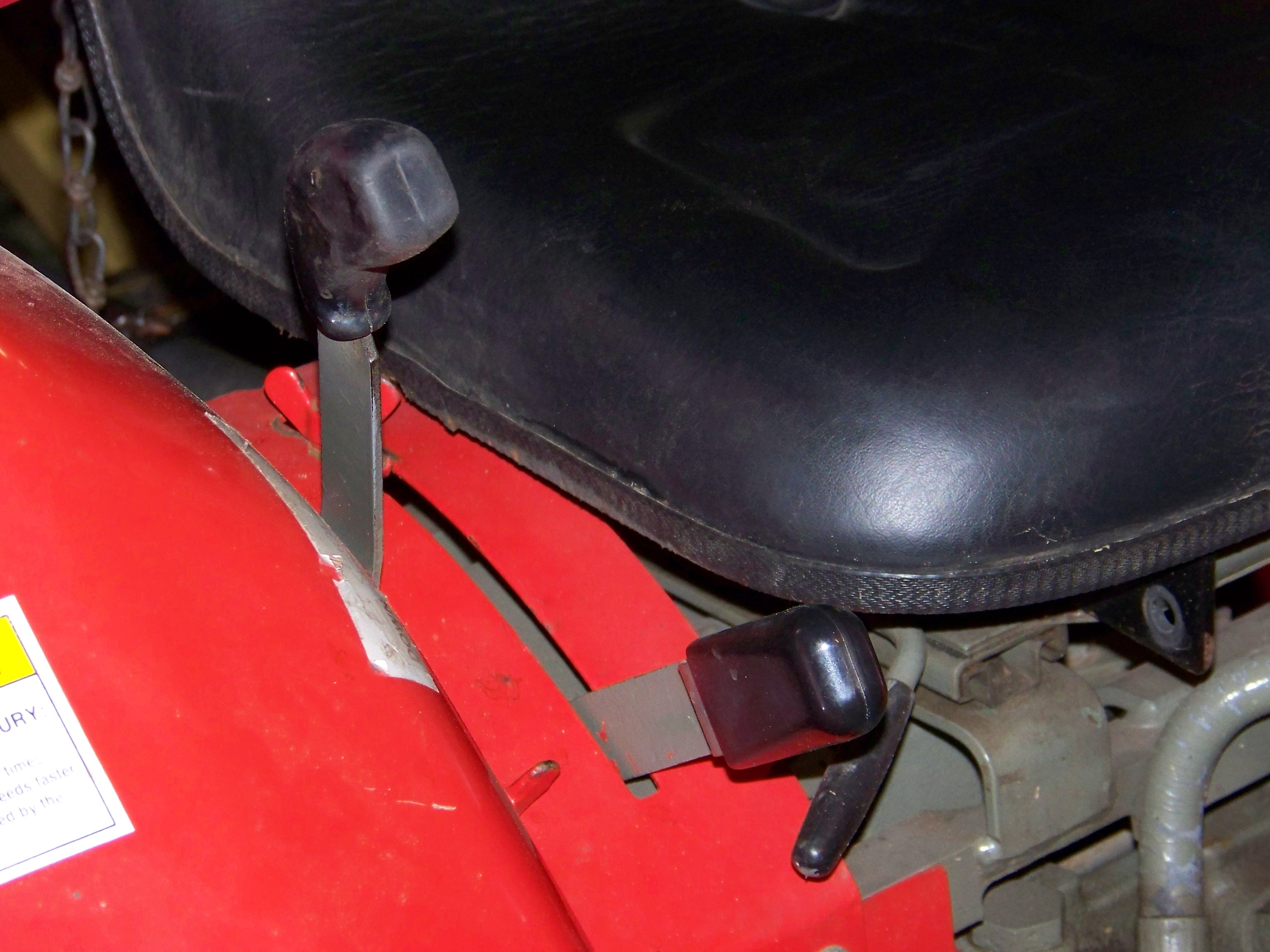

Again, I am unfamiliar with the ym2000. If you have draft control you should have the 2nd lever right to the left (sitting in the seat) of the lift handle, if not you probably don't have draft control. Draft handle is down in the picture on the 2002d.

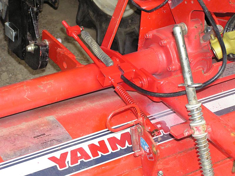

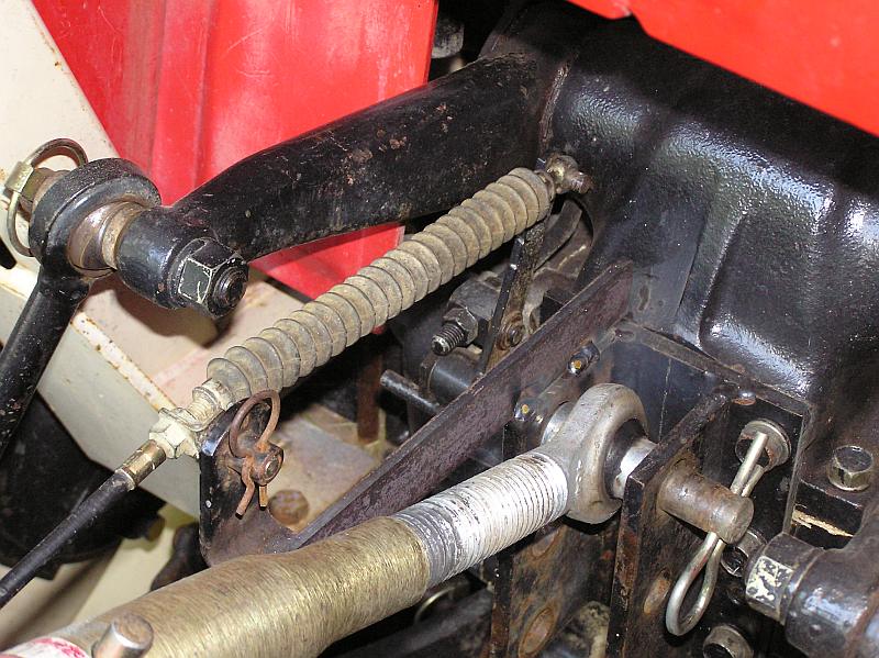

On the Yanmar's I'm familiar with, this control attempts to do the same thing in a different way and only for yanmar tillers set up to work with the UFO controls. There is a arm near the upper 3pt arms and it is linked to the tiller's drag via cable and some linkage. The draft attemps to control the tiller depth by associating the angle of the drag with tiller depth.
From several others that are much more in the know than I am, I've been told I'm the only one they know of that has ever hooked up the UFO controls to control tiller depth and side-side angle of the tiller.
See pics. 1st shows the arm associated with the draft control. There is a cable attached which runs back to the tiller. From there, pic 2, there is some linkage to the drag.
When connected, I can manually lift/lower the drag by hand and the 3pt reacts by either lifting or lowering the 3pt arms.

Hang in there Normde! I'm on your side. Mickey, excellent pictures explaining the Yanmar draft control. My 2002d place to hook the cable up is on the right side. I've no intention of hooking it up but you have helped me confirm what it is.

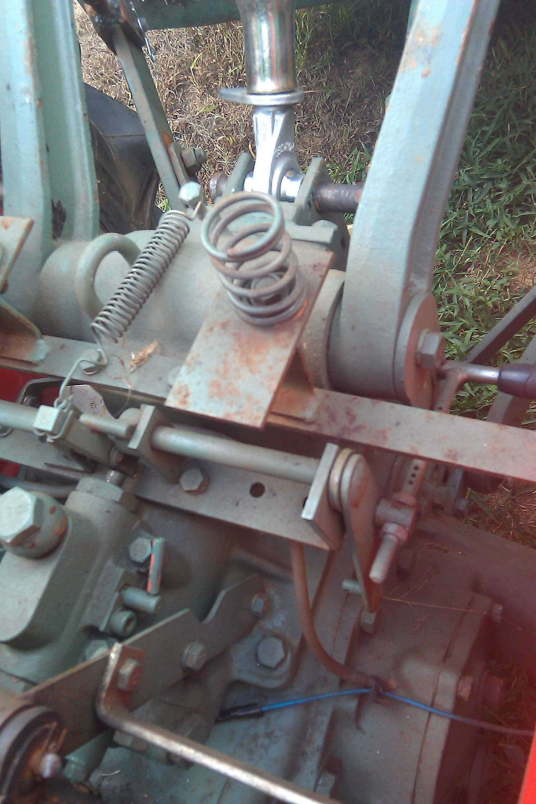

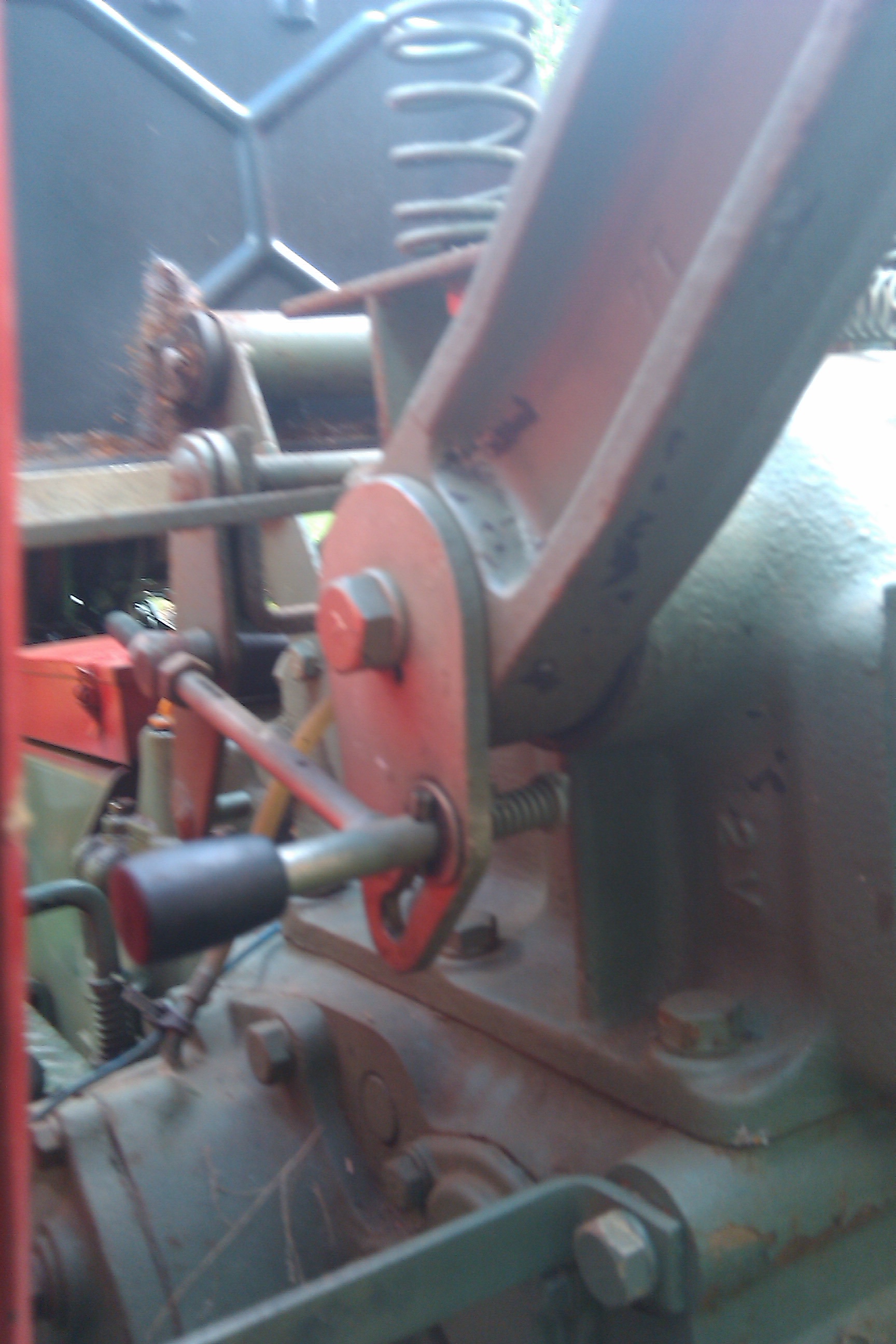

The draft control on my 1500D is controlled by the lever. Just pull it out and slide in back in the other hole and it rides on a concentric cam the measures hydraulic pressure and makes adjustments to the lift. The adjustments are so small, you probably would never see it.

Hey Mickey, what is the small 1/4" rod sticking out horizontally under the cable? It appears to be the opposing end of the lever attached to the cable? If so, is the draft manually adjustable to presets for other implements?

Jesnic, what is that little handle up on the side of the control valve? It is turned back.
/ Draft Control Adjustment #14
Winston, that little level controls the drop speed of the implement.

YM2000 has Position Control which raises the 3-point automatically if it leaks down. It doesn't have Draft Control like a Ford or Massey, which I think is designed to lift a plow when it is making too much drag.
YM2000 has a linkage like in Jesnic's picture, except with two separate holes. The manual (YM240) says don't move it to the other hole. Look at his second photo above: if the 3-point arm drifts down, the rod linkage pushes on that button coming out of the hydraulic control the same as if you had tugged on the 'raise' lever on the right side of the seat.

I'm assuming you're talking about the 2nd pic. The rod transfers the movement of the drag back up through the cable to the arm near the upper 3pt arms. The draft control, the lever next to the 3pt lift control, does set the sensitivity, or the position of that upper arm to determine where the neutral point is. The drag via the linkage will set the position of the arm so as the drag moves up/dn it changes position of the arm thus determine if the 3pt arms need to move up/dn or not.
I've not found any other use of the control. Would think it quite difficult for this design to control the depth of something like a plow.
