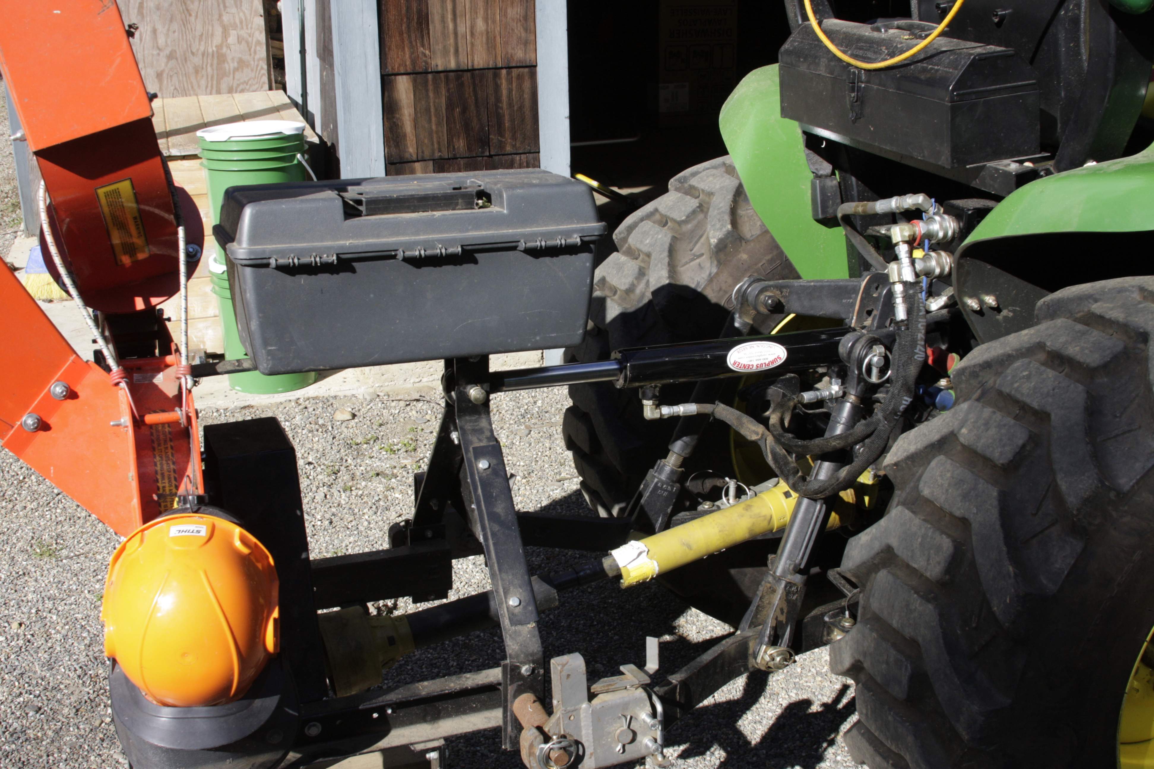

I have a DR 3 pt chipper for my 3320 and love it. It seems that it gets bashed some on the forums but I would buy it over again in an instant. $1000 is a steal as long as it is decent shape. I find that the blade needs to be changed after about 10-15 hours of chipping for best performance and spares can be bought for aboutt $50. I have 2 spares on hand.

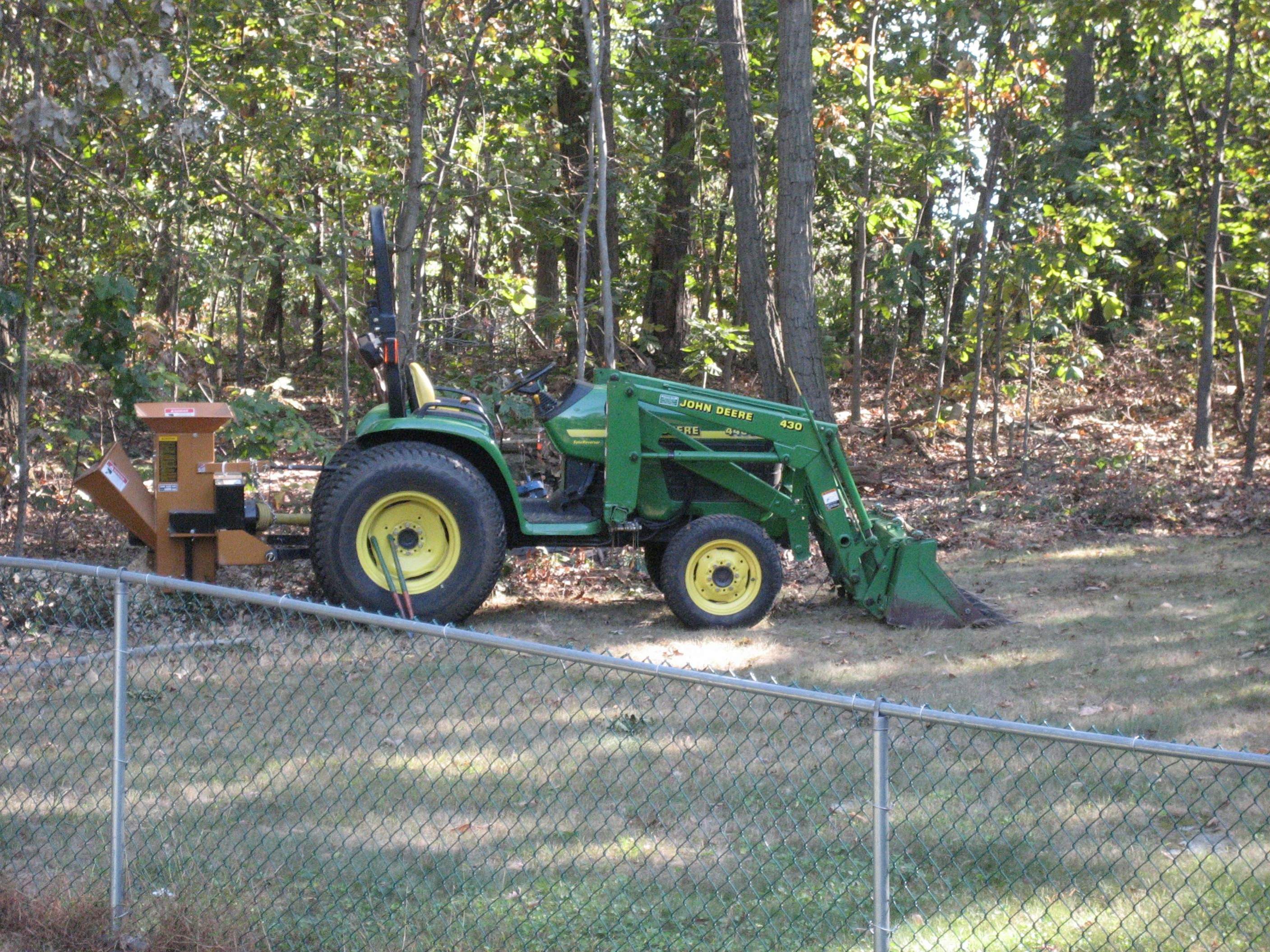

I can't help you out with the DR unit (although when I looked at them a few years back...can't say I was impressed).
I can attest to that Woods 5000 though, since I bought a low hours machine last year. I paid a grand. Well built and robust. The downside is the Woods drops the chips directly below the machine (DR has a blower/chute). The Woods chipper was bought when I still had my 790. It was a good match.
Used PTO chippers aren't on the market too long unless they're unreasonably priced or a real POS...
Not to nitpick Bob, but what is with the exposed PTO shaft? Seems dangerous, unless I'm missing something.
regards,
Steve
