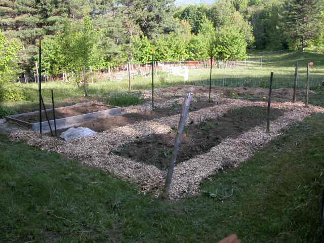

And a pic of the garden with the walkways all covered in fresh chips.
