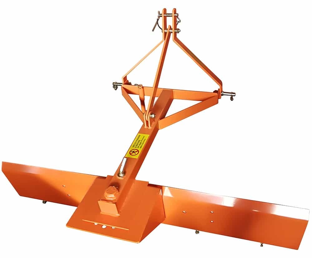

Pros and cons on these, thanks in advance.

Only being able to see the one side of it it looks to me like it is a very light duty blade and IMHO would be very easy to bend. I have seen other blades without bracing on the back end bowed like a rainbow. I know I own one that I spent a fair bit of time welding on, not only the blade but also the pivot point. Not sure how or why mine bent because most of its use then and now is moving snow when and if we have any. I think light scraping/moving of loose materials would be its limited use.

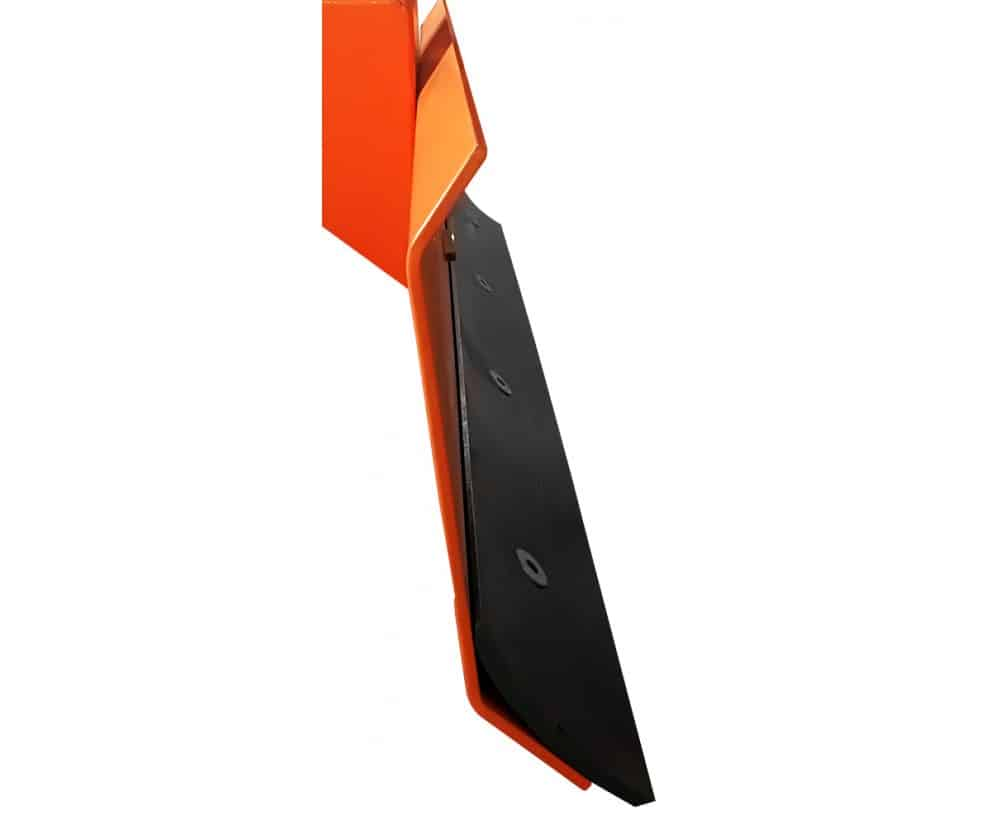

Thanks, the back has gussets/bracing and it shows 15mm thick on the board itself.
/ Dozer blade/polisher #5
Looks like a really thin POS..and is prob priced as such.

One that doesn't angle or reverse seems fairly useless.... Don't get that one unless you need metal for welding project...
I have a light duty 7' blade(400lbs?) and its great for snow, because its mostly useless on hard packed gravel, so it doesn't dig into my driveway when pushing snow. It can sort of ditch when angled right, but I prefer my HD box blade for that too. The 100lbs+ per foot rear blades seem to be great for maintaining gravel roads.

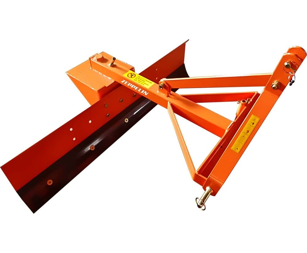

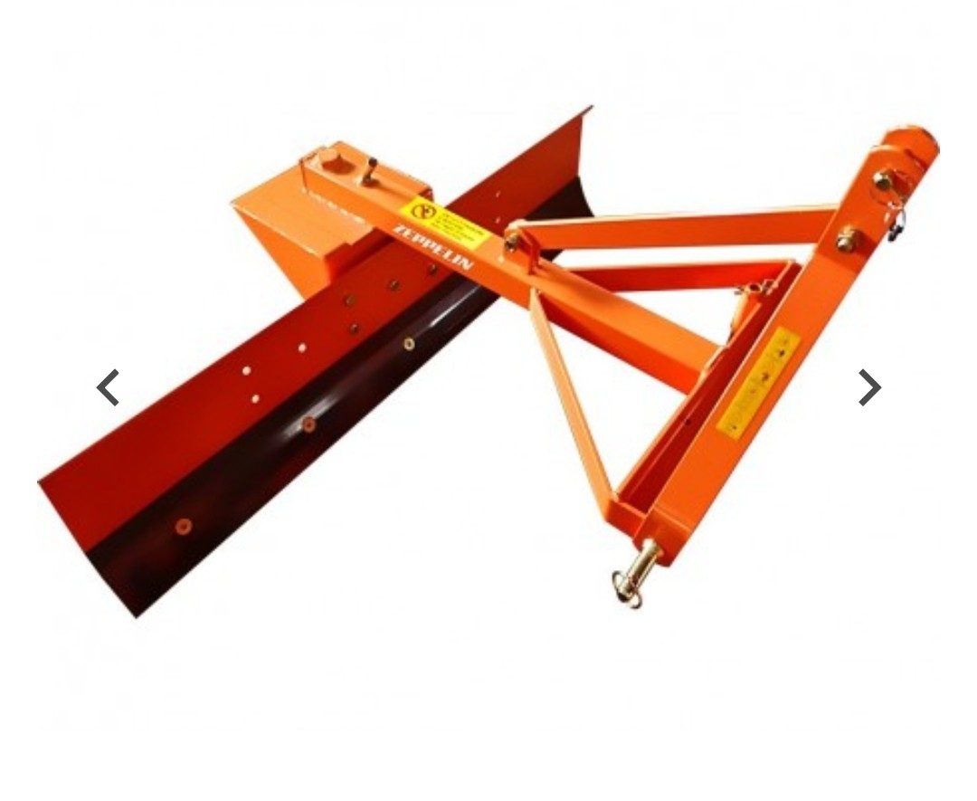

Zeppelin Maquinaria is a Spanish company that builds various implements in house. They aren't known for building bad implements.
This blade is a light duty blade that spins 360 degrees with various holes to pin in place. It's also made for small tractors, like SCUTs and similar. I believe they rate it to 15 to 25HP, but that's not a good indicator in this case, since there are relatively big tractors with 25 hp these days.
For the tractor the OP lists, which is a bit smaller and lighter than mine, I would want something stronger, but in reality, it really dependes on the work it will do.
/ Dozer blade/polisher #8
One like that will move loose gravel or dirt alright, or snow. It could maybe ditch a bit, but if it hooks a root or big rock on a 3000lbs tractor, it might start bending as its a long lever from the corner of the blade to the pivot? If I never got snow, I would sell my light duty one, my heavy boxblade does everything better(except snow!).

They are called polisher here in EU, yes it's light, I was using the picture for an example to find out how they work.

Shows 1.2-1.8 for a guide on my HP, the picture was used for reference only.....
The 1.8 is 84kg, which tells me that the increase is almost all in the blade and not the rest of the structure.
I suppose if you're polishing already-loose dirt it may work. I think if you were using it and it caught on a root or mostly-buried rock it would bend.
There's also a 1.8 (ESPOL2550Z) which is 240kg, which honestly doesn't sound heavy-duty either, but it's at least normal-light-duty.

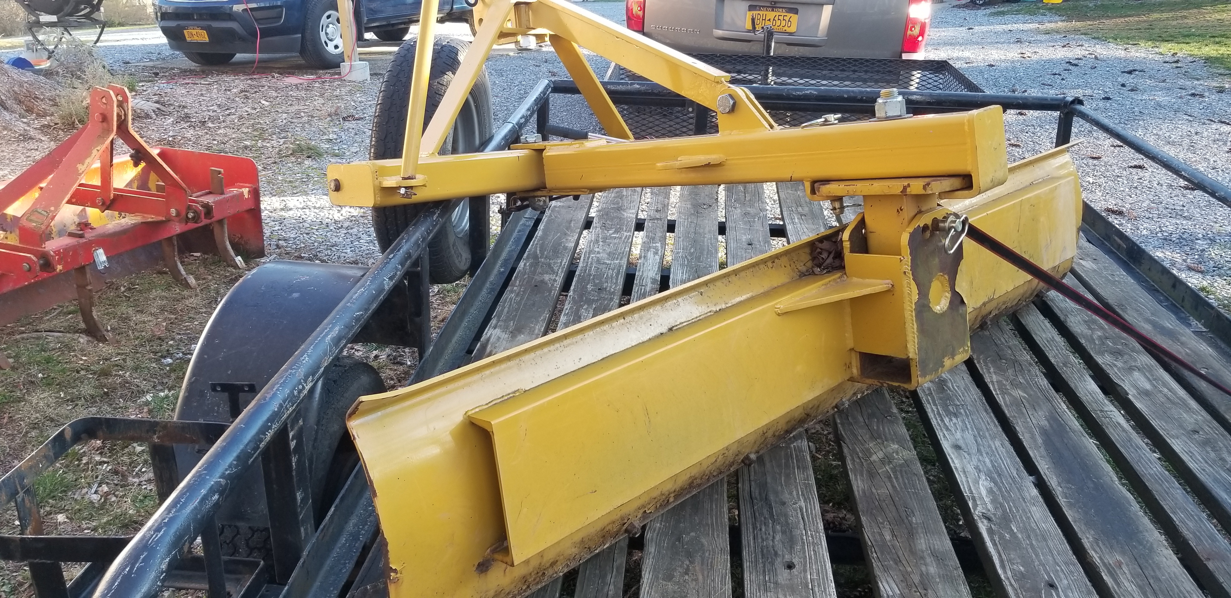

Here's what a better rear braced rear blade looks like. It also has offset and angle.
