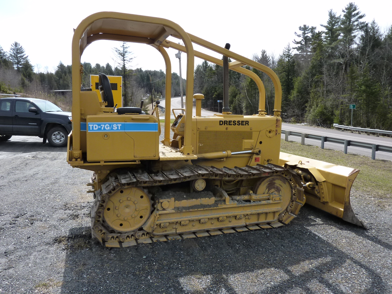

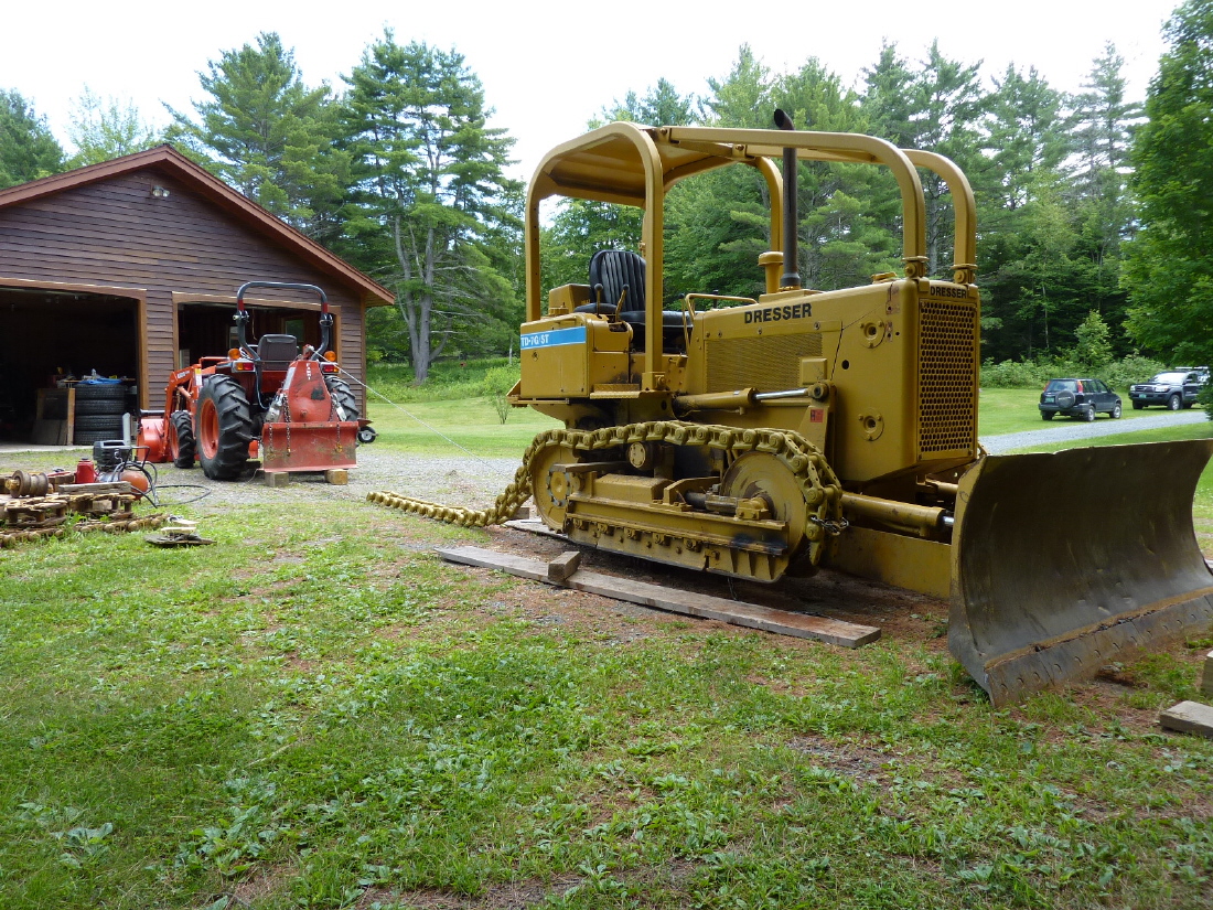

Anyway I'm glad I did. That one is a 1991 vintage with 3200 hrs on the meter what ever that means. It was in good shape except the track chains were shot. I bought it for $10,500. Here it is for sale - note the loose tracks.
Edit: It has a good old cummins 4 cylinder 239 motor air aspirated.
Cost $300 to get it home (50 miles) and $250 for manuals.
I did the work myself in the door yard. It cost me $4000 for under carriage parts. New track chains, sprockets, track adjuster rebuild kits, two bottom rollers, and new pad bolts/nuts (used the old pads).

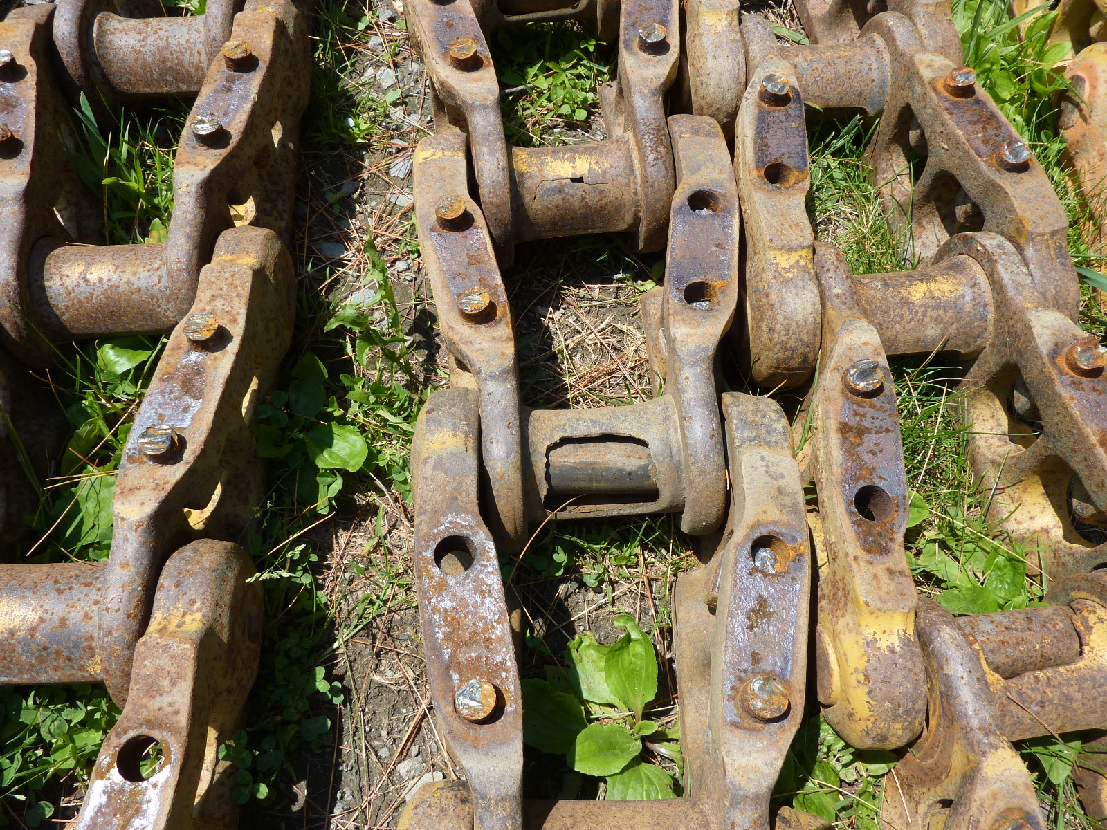

The old track chains
Then about $750 more on fluids, filters, and misc small stuff.
So I got about 16K in it but it is not a clunker. I like to think I could get my money back or at least most of it but you never know tell the time comes. There are a lot out there cheaper than that. It depends what you want.

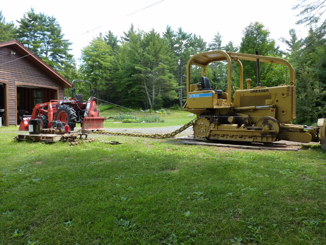

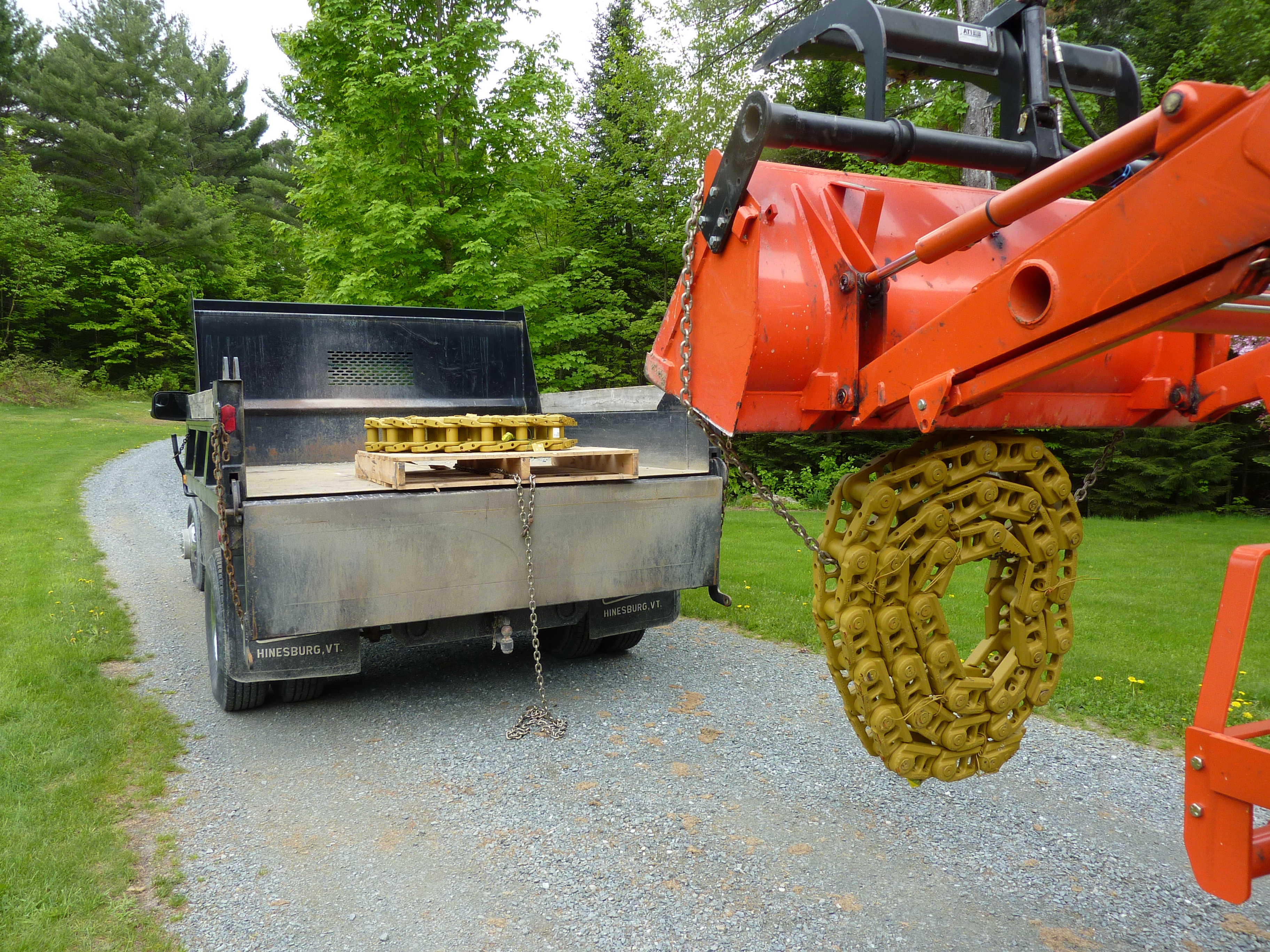

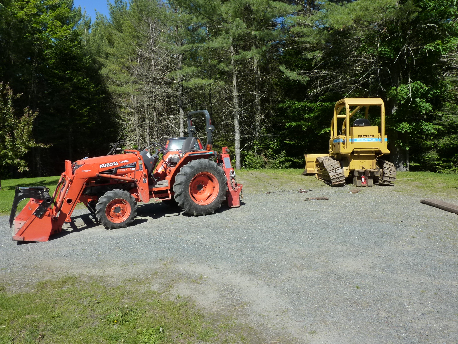

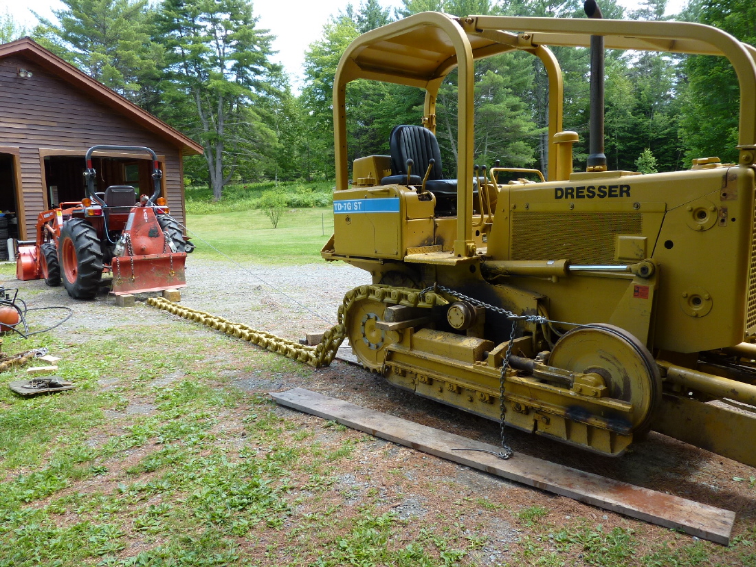

Well my story isn't to exciting but I am glad to tell you what I did and show some pics. It was a lot of work. Some fun. Some not so fun. Took me a little more than 2 months working when I could the summer of 2011. I used my tractor quite a bit. It was the only equipment I had that could move heavy stuff.

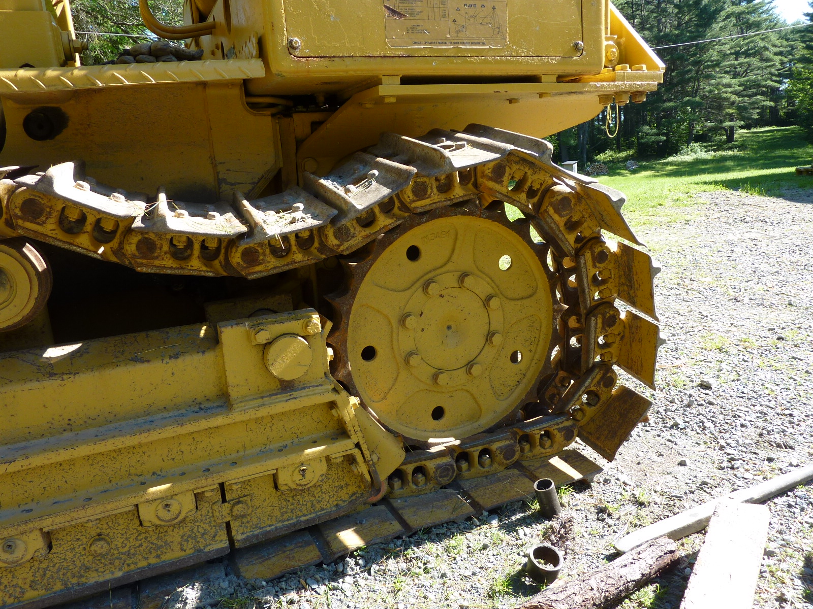

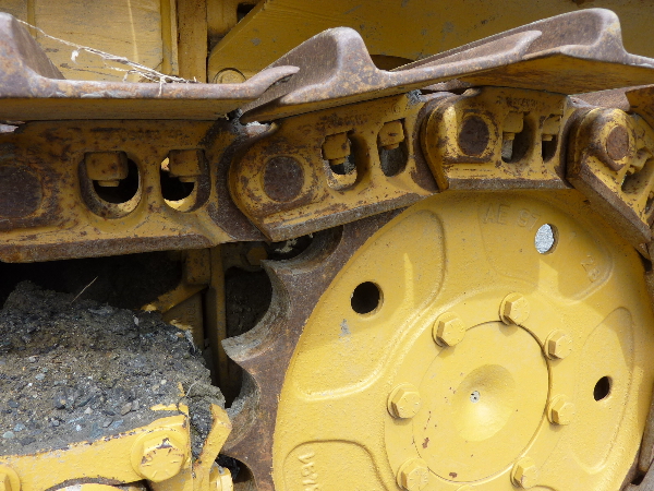

On June 4th I picked up the under carriage parts. These track chains are over 1000 lbs each. I couldn't pick them with the chain over the front of the bucket.

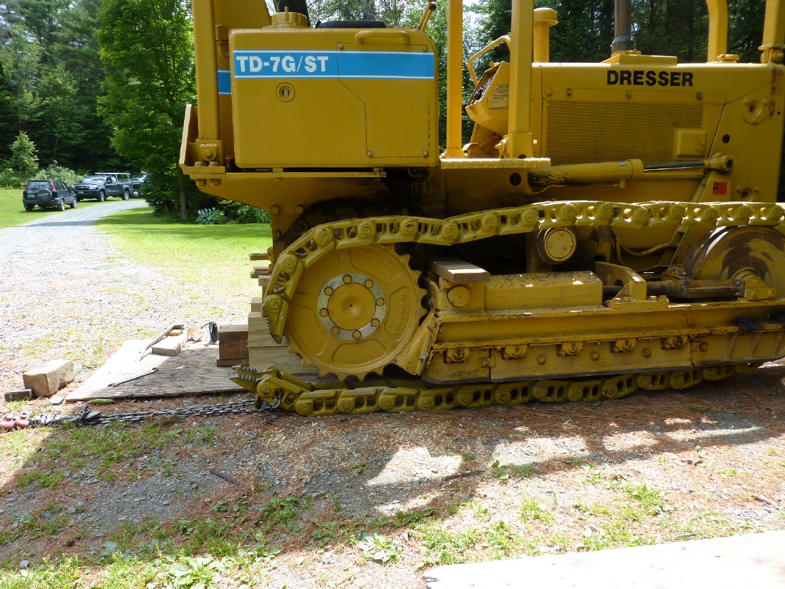

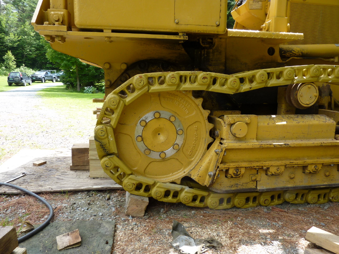

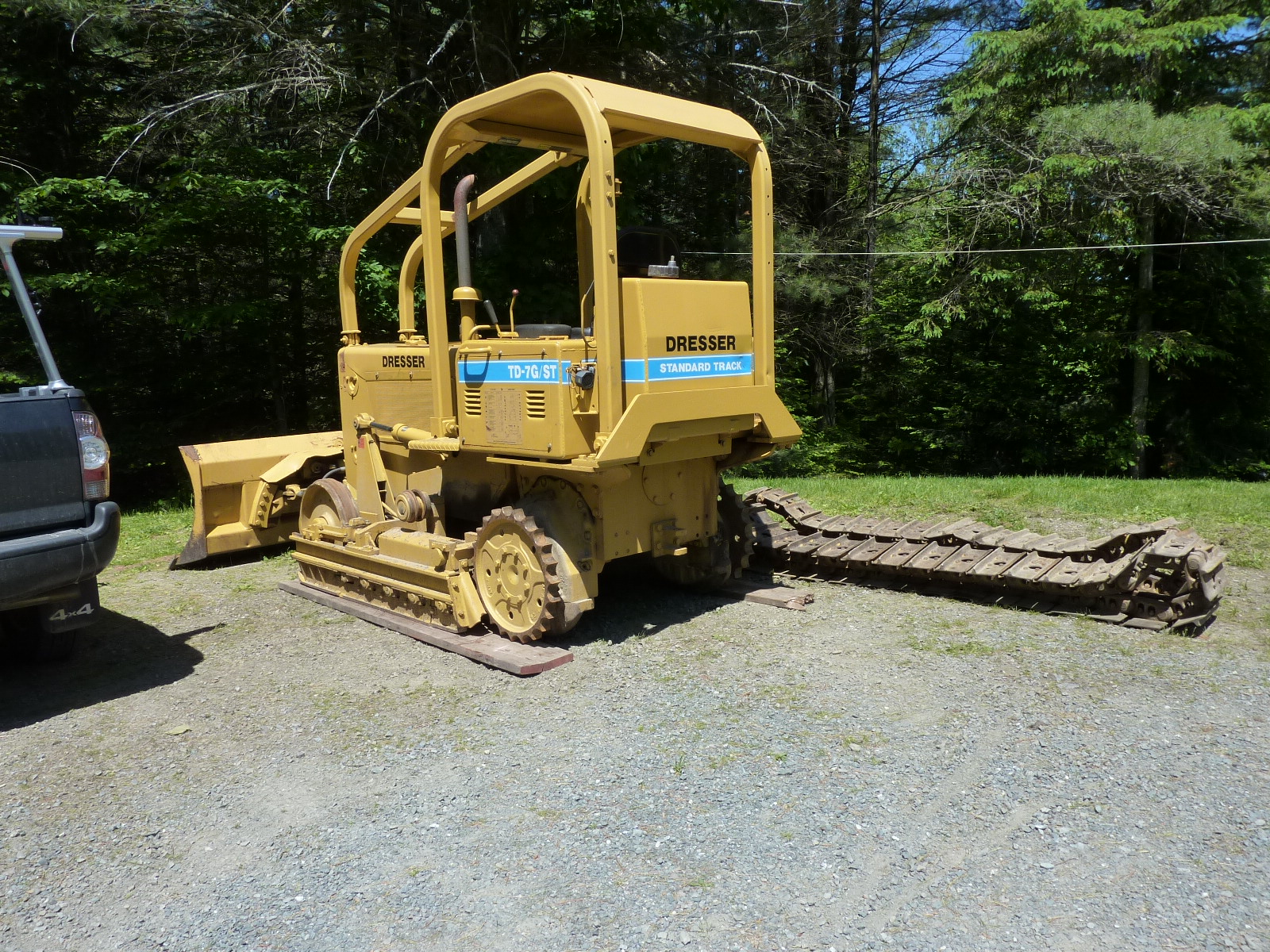

The tracks were really stretched from wear. After I collapsed the track adjuster cylinders by removing the grease fittings and check valves and then pulling the front idlers back with my logging winch there was enough track slack to remove them w/o breaking them. I jacked the dozer up with the blade and a jack in the rear just enough to get the track out from under it. I put some very short lengths of pipe in the sprocket groves to hold the track up out of the sprocket teeth
Then eased the track off with a 5' bar and my logging winch.

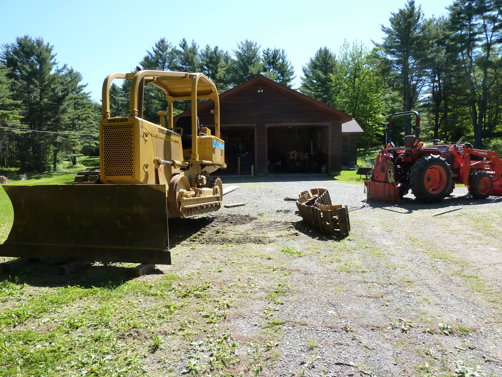

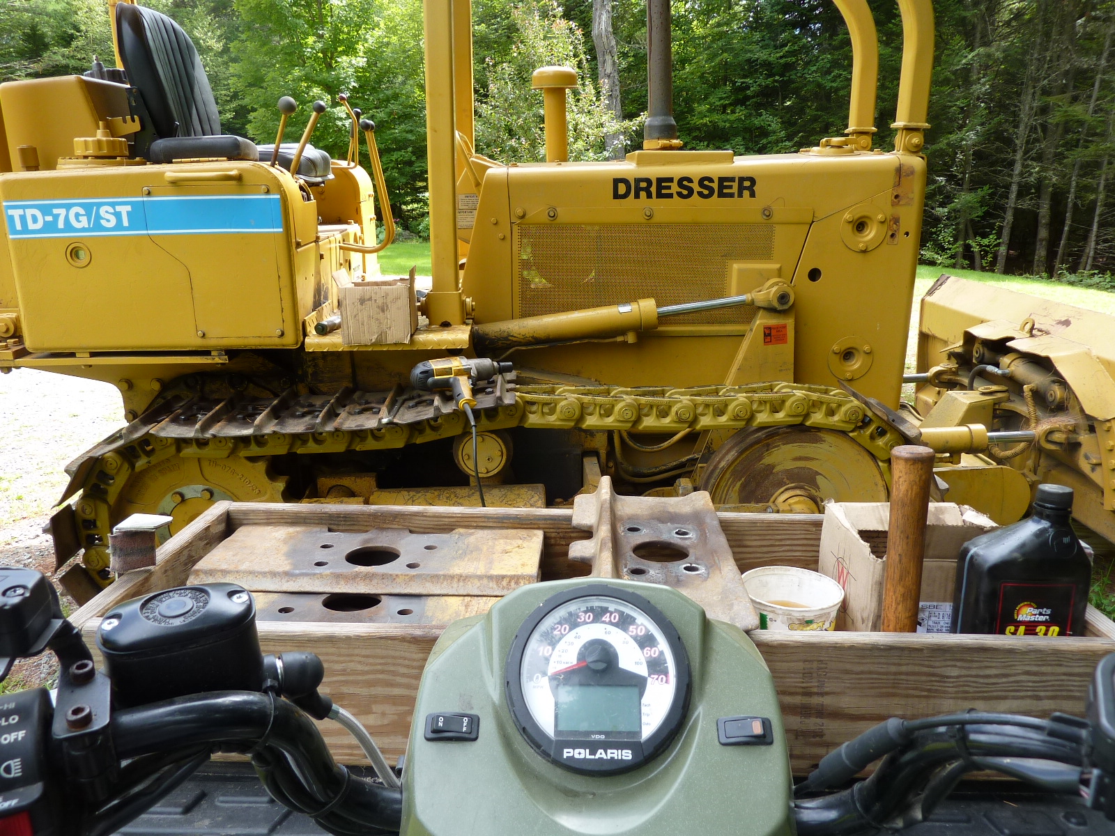

I wanted to reuse the track pads so I had to remove them from the old tracks. The pad bolt heads were all worn and rounded. There was no way I could get a wrench or socket to hold so I had to cut them off with the torch. 33 pads to a side, 4 bolts per pad, 264 bolts/nuts to cut.
I first tried cutting off the nuts and pulling (pounding actually, with a 3 lb hammer) the pads up. But the bolts were so locked into the track chain holes from years of mud and dirt it was very hard to impossible to pull the bolts up thru the track chain. Plus the bolts tended to get welded to the chain during the cutting which didn't help. I finely got brave enough to cut the bolt heads off on top of the pads. This went better than I thought but was very tedious. I had to really concentrate and be careful. I did gouge a couple pads up with the torch.
I can only cut for 15 minutes or so out of each hour with my torch set because my acetylene tank is only a 65 cubic foot tank. So the pad removal job took quite a while to finish.

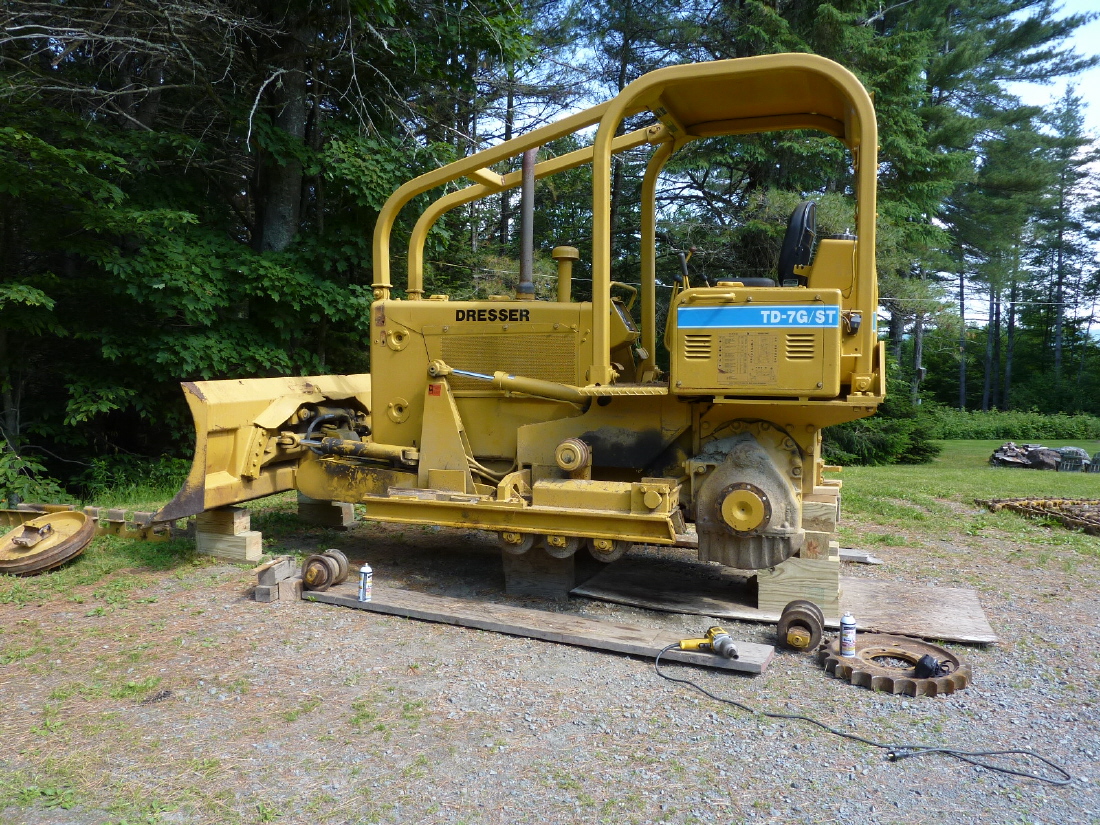

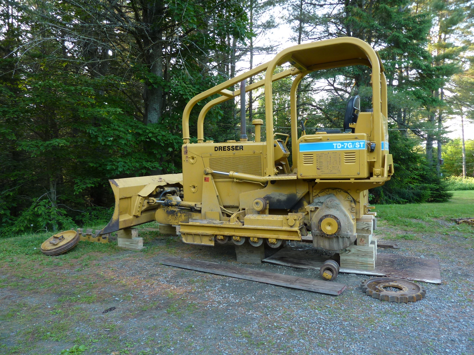

Here t is setting on the rock guards

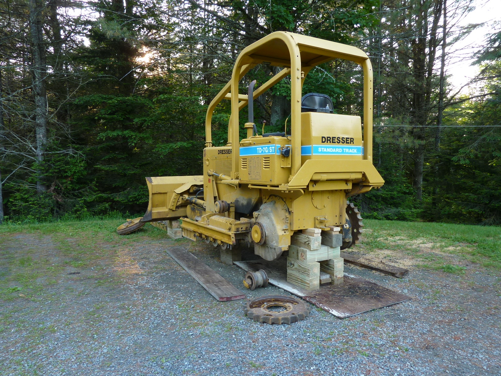

Next job was jack it up so I could work under it. I jacked it 1 6X6 tier at a time using the front blade and a 20 ton jack in the back. I made a sling to hold the front idler and used the tractor bucket to slide it and the track adjuster out of the front of the frame. Removed the track adjuster cylinders and rebuilt them in the garage as a rainy day job. They are similar to a hydraulic cylinder but much cruder and run on grease rather than oil. Took off the sprockets which are torqued to 350 foot-lbs. The 3' breaker came in handy on those. Then came removing the rock guards so I could get to the rollers. By far removing the rock guards was the absolute hardest part of the job. Laying on my back underneath with a 3' breaker trying to loosen 3/4" bolts frozen up into the track frame for years. A scary place to use a torch too!!! I think I used a whole case of PB-Blaster. There are a lot of bolts on them things. I did break off two bolts but was very lucky that both were on the outside frame where I could work on them w/o laying on my back underneath. So another job after I got everything off was removing the bolts I broke off plus another one on a roller that someone in the past broke and left. I was able to weld nuts on the stub ends and get the bolts out.
Here it is jacked up while removing stuff.
TBC

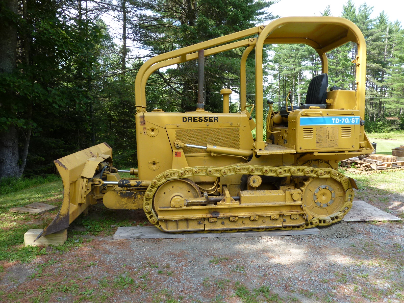

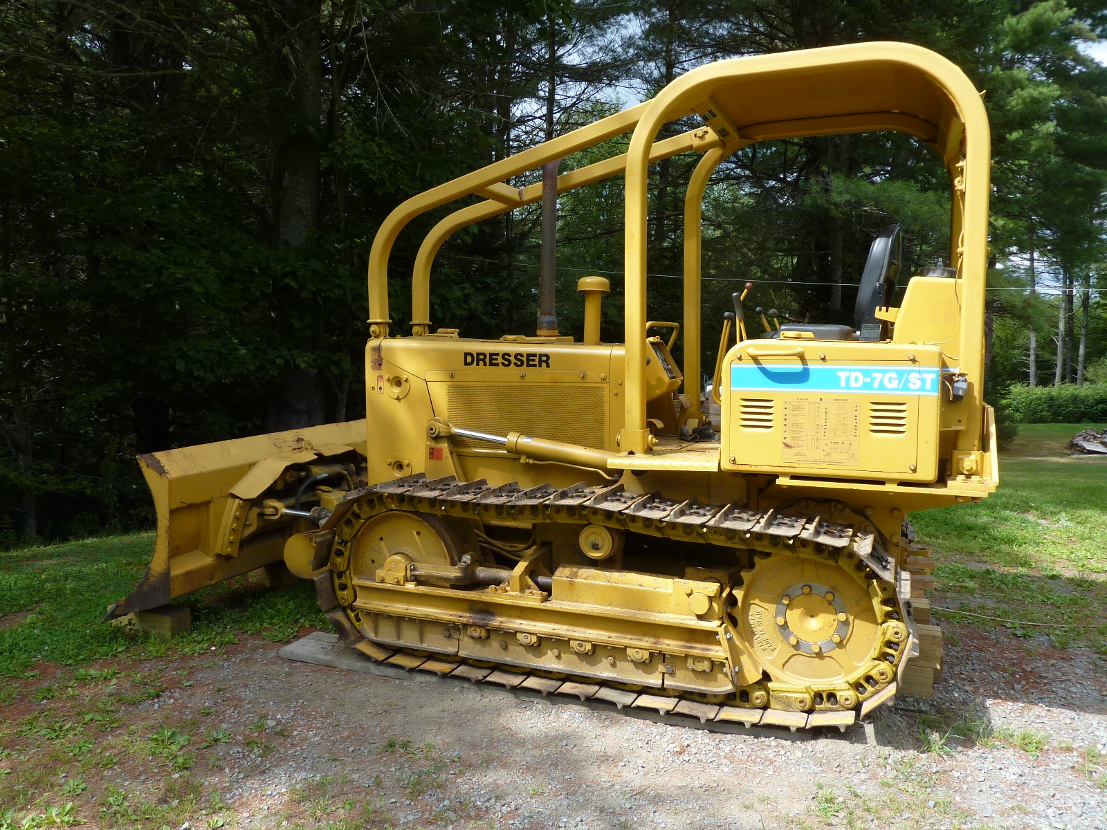

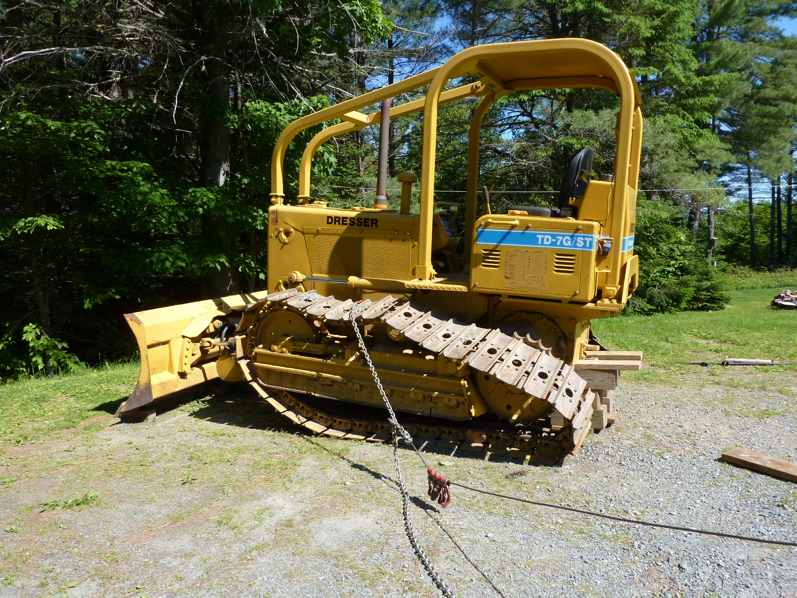

Putting it back together was much more fun than stripping it down - easier too.
New sprockets, a couple new rollers, track adjusters rebuilt, front idlers back on, and rock guards back on. The burn marks on the forward part of the track frame are from removing the two bolts I broke.
I used the winch to put on the new track chain. Laid the chain out, threaded the winch cable under the rollers, up around the idler, and back over the sprocket then pulled the chain around the loop.
Finally set it back down on the ground. Another burn mark on this side from the broken roller bolt.
