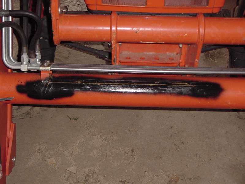

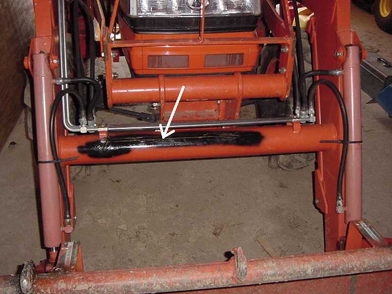

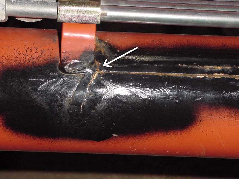

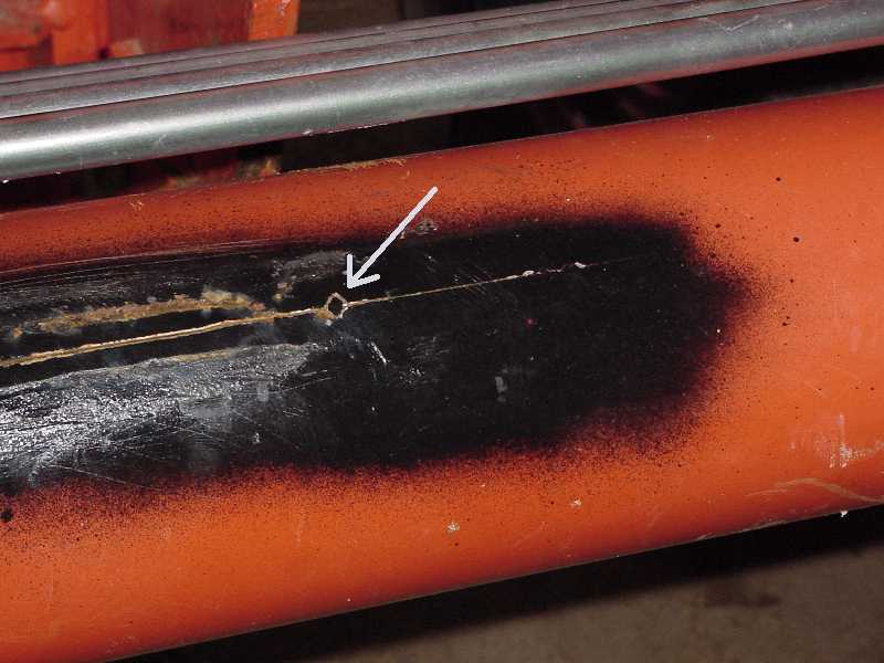

I have a bit of a problem here. The "cross-bar" (not sure what you call it) on my loader has cracked along its seam. Fellow TBN'r GaryE and I tried welding it shut, drilled a hole to stop the crack and grooved the seam. But this weekend while digging rocks out of next years garden it pulled apart again, followed the seam again and went past the hole (plug you might call it)[pic 4]. Originally it had "y'd" when it got to the weld that holds the bracket for the hydraulics and has done the same again [pic 3].
I do admit to beating on this machine some (have more rocks than dirt here) but I was very conscious of not using the "ends" of the bucket (to keep it from twisting) to dig the rocks out of the garden. Gary's thinking (and I think I agree) is that one side or the other is not lifting/working correctly causing the arms to twist and in turn "pop" that seam.

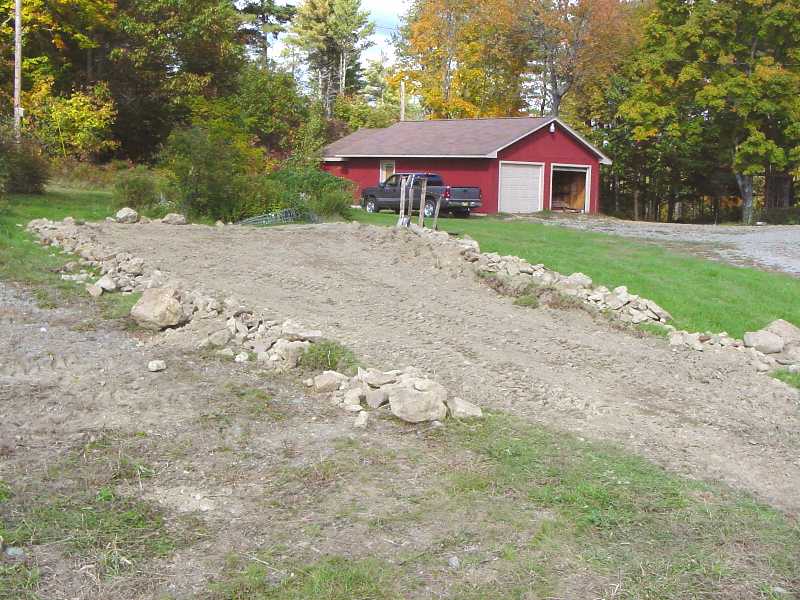

Just wondering if anyone else has seen/dealt with this problem before? Any thoughts on repairs/fixes/etc are appreciated. Pic #5 is the soon to be garden with about 2/3 of the rocks that were pulled from it. (and this is one of the "less" rocky areas!)

I am just making a guess but would think that maybe the original material used had a faulty seam in the pipe. :D
You may be looking at grinding out the whole seam and welding it again. It might not hurt to weld a few straps over the seam weld?:confused:

It looks like you ground it flat therefore leaving very little weld left.
I am no certified welder or anything but this is what I would do;
Groove it out again and fill the groove then lay a bead on both sides. This should add significant strength to the area.

From what I understand, when you get a crack, you need a patch (and drill holes at the end of the crack).
Cut a 120 degree section out of a piece of steel pipe of appropriate length and diameter. Weld this over the crack.

I personaly would drill the ends of the crack again, and take a whiz wheel and cut through the entire crack, so that you have a 1/16 or so gap in the crack, and mig weld it up. The 1/16 gap should let your weld lay down pretty flat, so minimal grinding would be required. I then would take a couple say 6in x6in peices of 1/4 plate, , drill several 3/8 holes in the plates, then center them over the crack, welding one end to the tube at first, then warm the plate to just beyond cherry red with a rosebud tip on an oxy/acetelyn torch, and begin tapping them down with a hammer an inch or so at a time while still hot, then tack welding every inch or so to keep the plate tight against the tube, and continue forming in this manner until plate is completly molded to the shape of the tube. I would use several narrow plates rather than one big plate the entire length of the crack, as a big plate would be realy tough to work. Once all the plates are formed and tacked on, {how ever many you end up needing} simply weld solid passes around them and solid passes welding the plates together. Now for those 3/8 holes you drilled in the fishplates earlier, the loader tube should be exposed at the bottom of the 3/8 holes, in these holes, weld the loader tube to the fishplates, filling the entire hole with weld. It is up to you to decide the best spots for these plug weld holes, based on your crack and accessability.

Follow Ryan03's advice. That sounds pretty good. You could also just cut the tube off and weld on a new one. That's probably what I would do, Fresh start with good metal.
Or find a tube that would slide inside tight after slitting as Ryan stated. Then weld it deep and weld the outside ends of the tube to the frame. Maybe drill some holes on the other side of the original tube and plug weld.
THEN, I would double check the torque on ALL the loader related bolts. You either have a defective tube material or a loose bolt allowing motion and stress build up.

I am not intimatly familiar with the loader that you have, however if the tube just sits between the loader arms and is welded on only one side of each loader arm , I also would opt for replacement of the tube. If it was my farmtrac loader where the tube passes through each loader arm and is welded on each side of each arm, then I would go the fishplating route if at all possible. One thing that I feel needs to be mentioned, is that if you do cut this crossmember out, BEFORE YOU CUT ANYTHING, it is highly adviseable that you either build some kind of jig to hold it in alignment once you cut the tube, or do what I have done in the past which is tack weld a couple peices of 2x2 angle across the loader arms as close as possible to the tube that will be replaced. Three peices would , in my opinion be adequate for this task. Perhaps two on the top in front of and behind the tube, and one on the bottom in the relative area of the repair, or vice versa. Once the new tube is installed, simply cut the tack welds and remove the temporary bracing. As mentioned earlier, go over all your loader bolts with a fine tooth comb, also check your bucket pins, and be sure one is not missing or hammered out, likewise with your pivot pins on the loader. Also as you said earlier, it could be a blown cylinder, or defective tubing. If you lived closer to Chardon Ohio, I would tell you to load it up and bring it over this weekend, and we would get it dialed in, but you are way to far away for that to be feasable. Good luck, Ryan.

Perhaps there wasn't full penetration .. or the grinding weakoned it.
I'd regrove, and reweld.. and then weld a patch over it.. pipe or angle stock.. anything to add some extra support.

Your FEL seems to have some shed 40 tubing with this defect and there are
lots of good fixes posted here. If you do not want to do as much welding
as a full replacement calls for, and you want it to look nice, you might
consider adding your reinforcement from the inside. I would do this using
a 1/4 lengthwise cut piece of tubing in the inside of the torque tube. If there
was a tubing or pipe size you could buy that fit tightly inside the torque
tube, you can use that, but I don't think you will find any. I would then cut
along the crack to open it up to 1/4" over its full length, then weld it full with
the 1/4 tubing backer. Do not grind off the weld....leave it just proud of the
tube surface.
