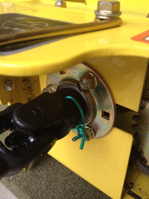

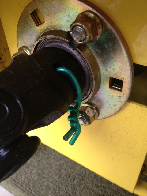

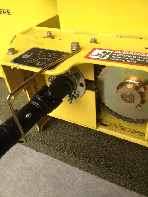

Greetings,
I was cleaning up my 54 snowblower and notice something that doesn稚 look quite right.
I am referring to the twisted wire in the following pictures.
Appears as though it could be a safety wire, but is that really how JD would do it?
Just seems odd.
TIA

If your dealer delivered it in this condition I'd be upset.
Supposed to be a bolt in place of that wire.
Must be a splined shaft ?

Willl;3253569 Must be a splined shaft ?[/QUOTE said:
looks round with a keyway in it.

That is the way it's supposed to be...you have to watch out for all of the dis-information on these forums. Check out the diagrams on JD parts. My 47 snow blower is the same way. There should be a roll pin in there, and the wire through the roll pin...no bolt.
/ does this look correct? (54 snowblower)
EXACTLY !! looked more closely, and there is a roll pin that the wire goes through.
Thank you for the help.
I looked at the diagrams on JD parts for my 54 snowblower and it calls for the wire through the roll pin also. Mine doesn't have it so I guess I will be adding it this spring when I remove the blower for the season.

This wire is supposed to be there. The green wire is plastic coated, probably to help with corrosion. The wire is actually a safety wire, should the roll pin ever decide to start to work its way out, the wire is twist tied and will not allow it to come out. The roll pin is what holds everything together.
