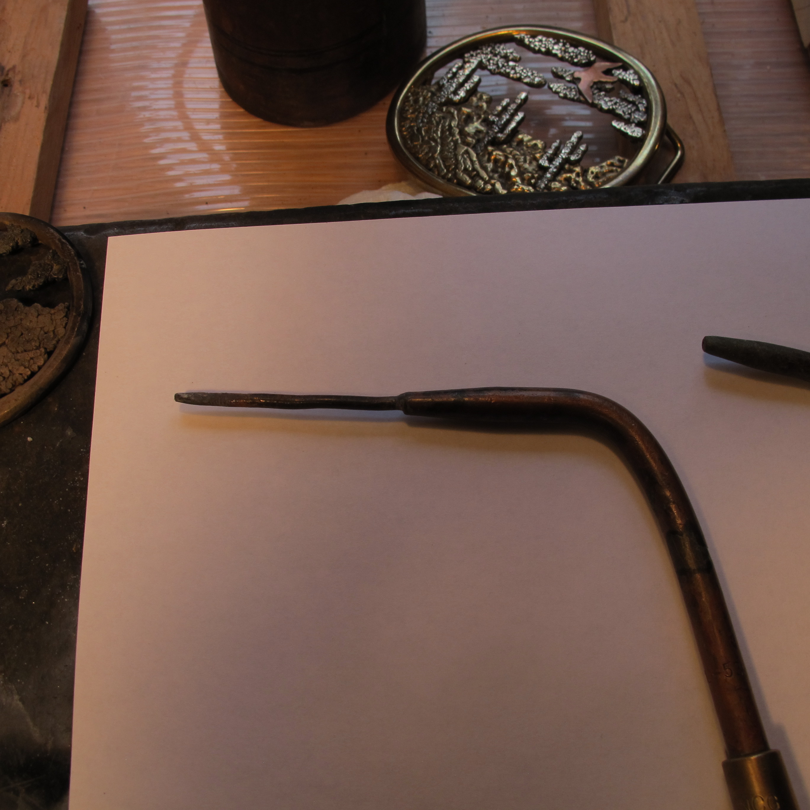

Here's a couple of examples of torch work along with a torch tip I made for doing fine work. The belt buckle's outer ring is regular low fuming brass or bronze rod wound around a piece of water pipe, brazed into a ring, and beaten into an oval over the horn of an anvil. The silver colored metal used for the inner design is that #14 nickel silver you mentioned.
The belt in the picture is 1 1/4" wide, so that buckle is about 1 1/2" tall overall.
enjoy,
rScotty

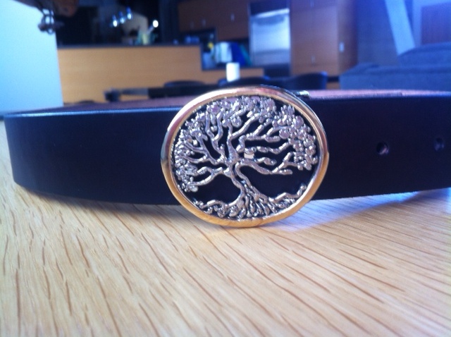

Came across this post while researching brazing....my daily-wear belt buckle is very similar to the one shown but all yellow brass and a bit less detail....bought back in about 1975 in Boulder in or near the Pearl St. Mall at a place called ChuckleBuckle Fantacy....or similar...been on more than 6 to 8 belts in that time....still get lots of comments on it.....wonder if perhaps one of your early pieces?? I left the Rockies after about 40 years and after a bit of wondering now live in Australia.....Tasmania to be exact. Cheers, Rip
Rip, that's amazing. I bet it's one I made back then. Artistic brazing and welding has been a hobby of mine for a long time now. I'll send a PM.
