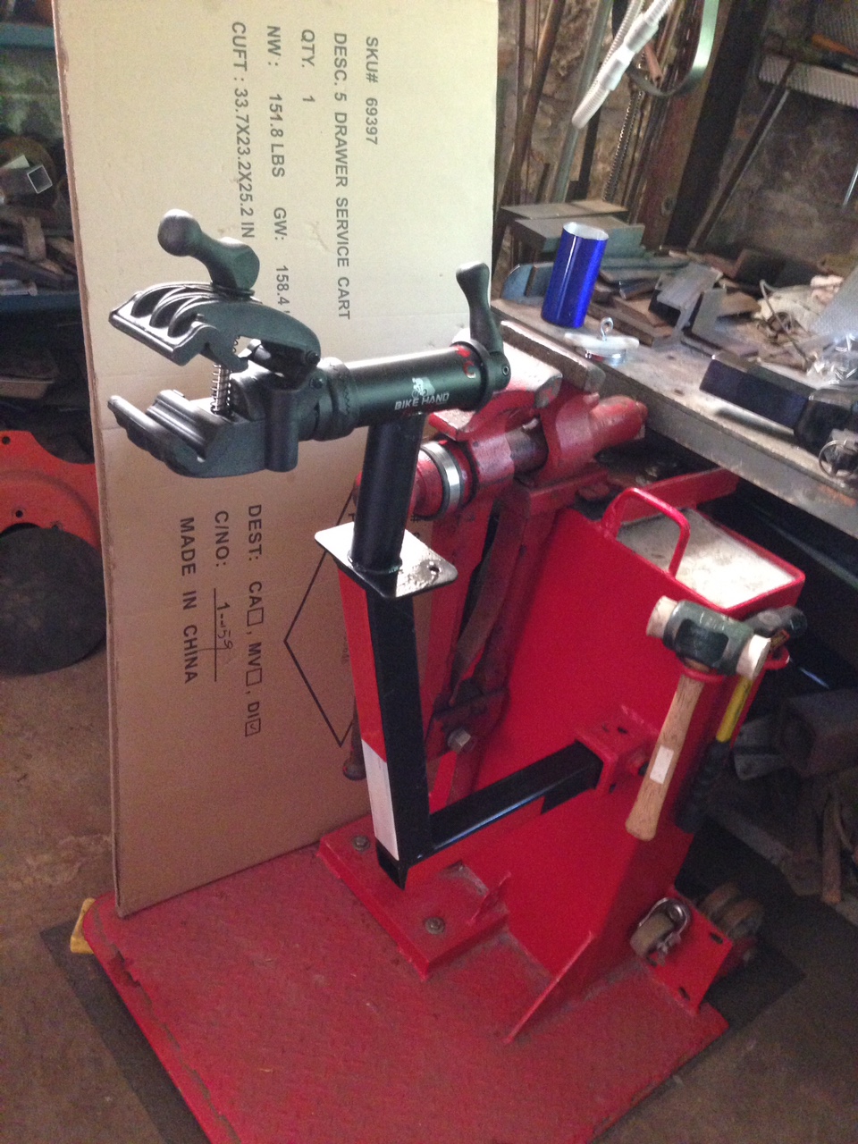

   / Doea Anyone Have A HEAVY Anvil Cart? #24
When an anvil is on something solid it greatly reduces the amount of effort. Metal moves instead of anvil and increased rebound reduces effort to lift hammer.
Polyurethane sealant/adhesive (Vulkem 116) between anvil and stand quietens anvil.
Similar base for leg vise. Jack with dolly wheel can rock base back on caster wheels to move the base. Base with leg vise about 800#. Receiver hitches on both bases for other tooling like bike vise, benders, ring roller, etc

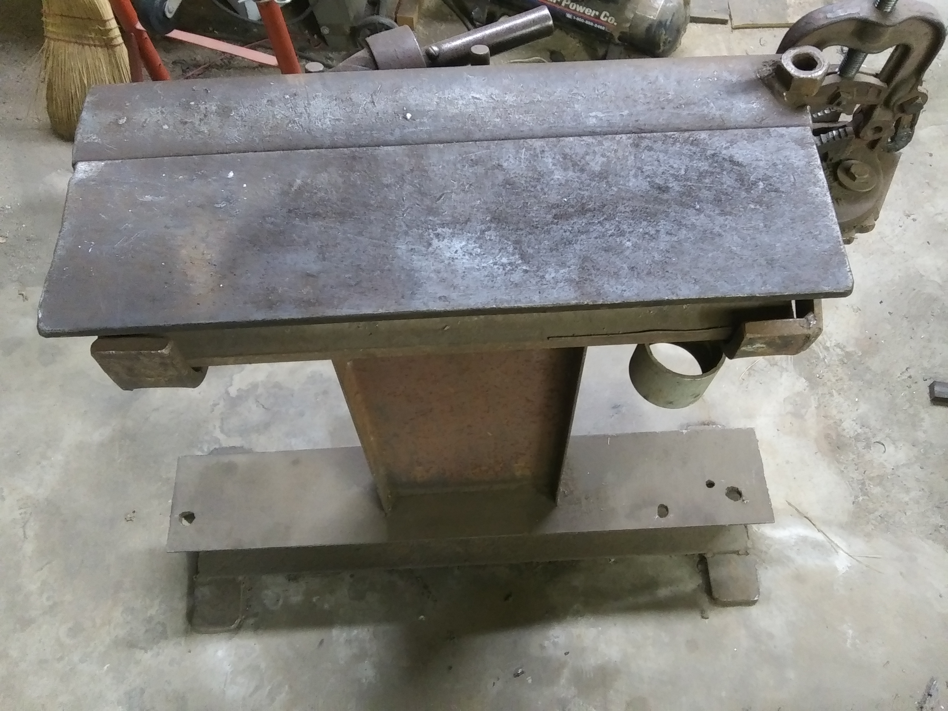

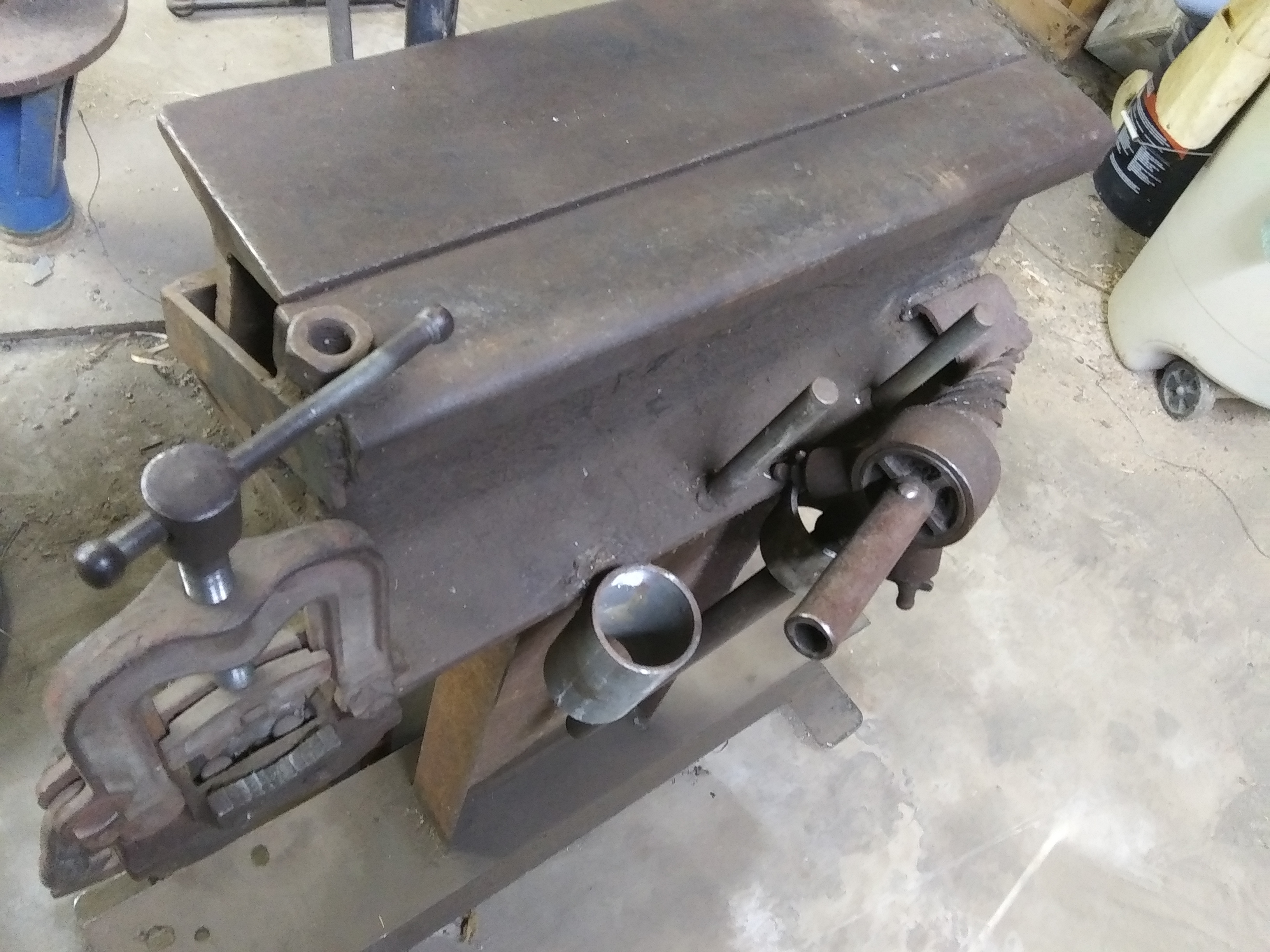

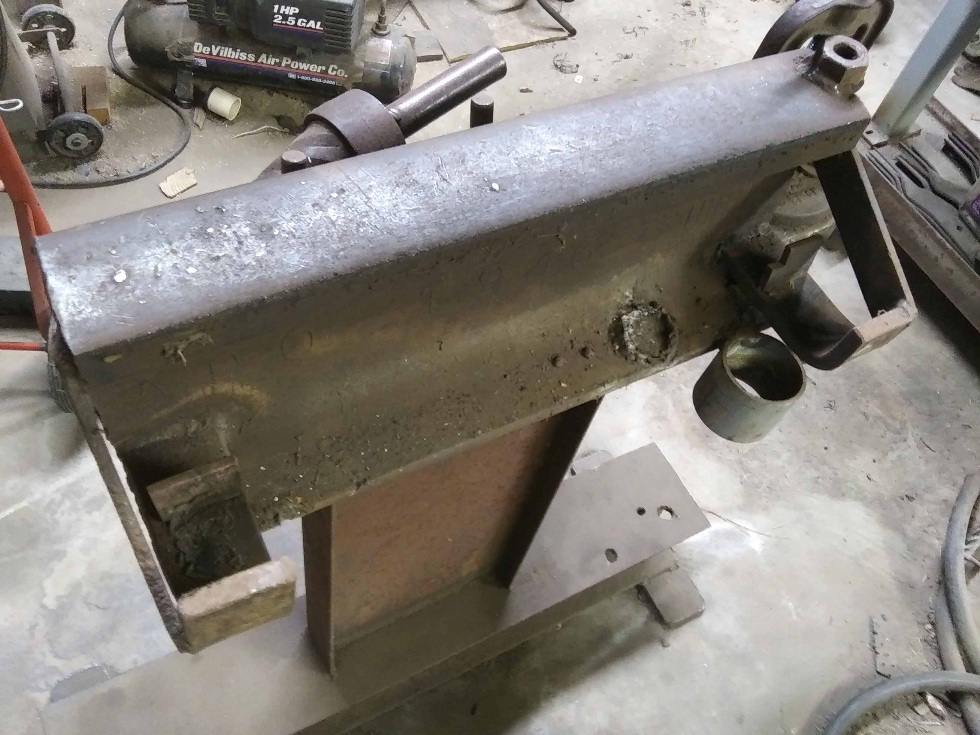

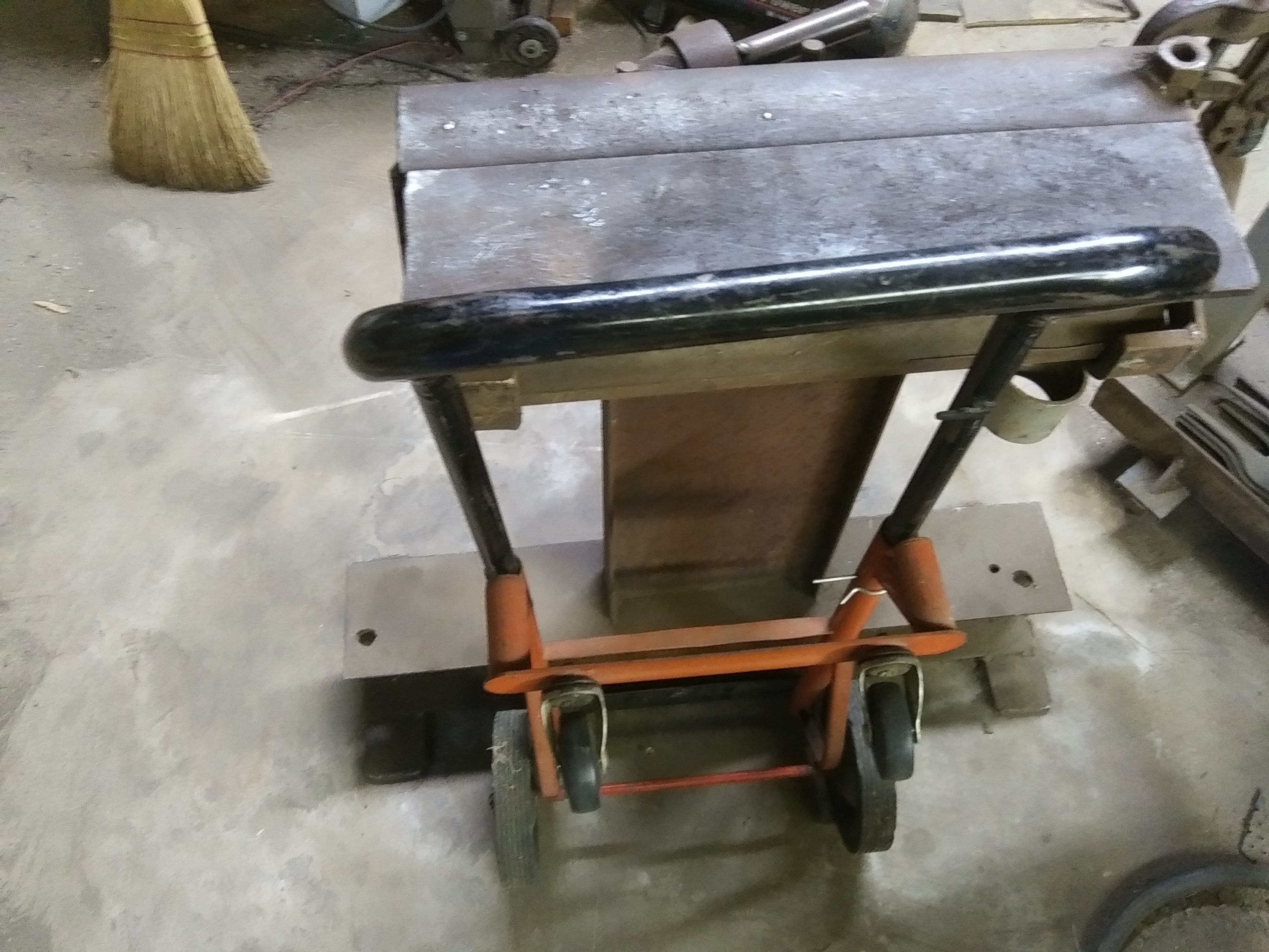

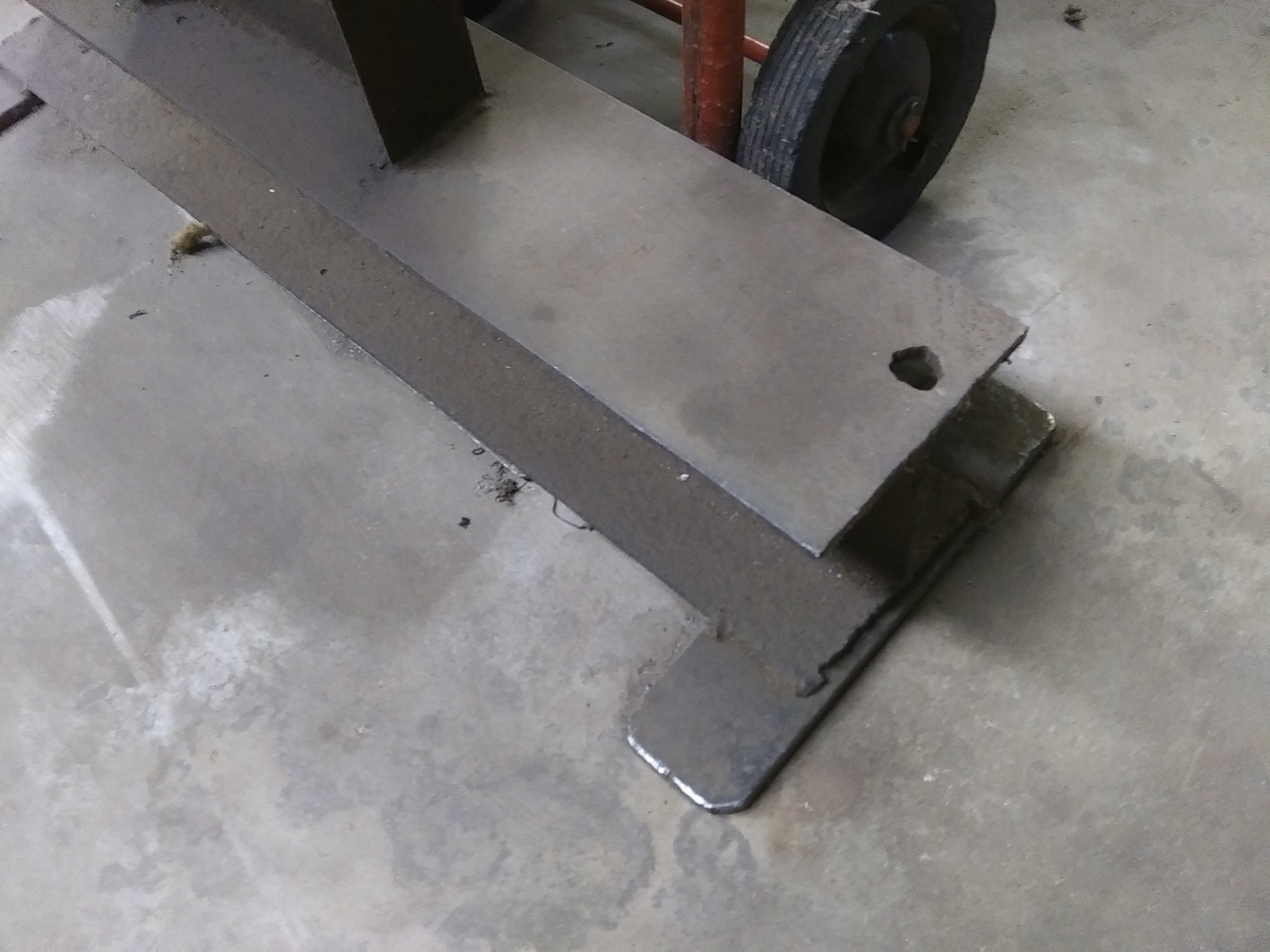

My anvil is homemade out of 2 pcs of rail road iron, 6x6 I-beam for bottom and 10" Jr I-beam for stand. Might not be as heavy as yours, but works good and is easy to move. If we had a real anvil, would probably mount similar. Put 2 pcs 1/2" flat steel under each end of 6x6 Ibeam to stabilize and lift Ibeam off floor for 2 wheel dolly to slip under. We used 10" Jr Ibeam for stand, then welded a piece of rail road iron on top for anvil. Then we made a rack to hold another piece of rail road iron to lay beside, upside down for a larger flat surface. It can be lifted out if needed.
Will see if I can get some pictures.
Well, maybe pictures someday. We started using a Linux operating system and sometimes we can find our phone when we plug it into the computer via usb and sometimes I can't seem to find the way to make them connect.
