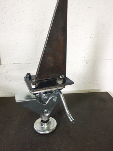

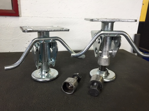

I purchased inexpensive floor locks and made them adjustable for my welding table.

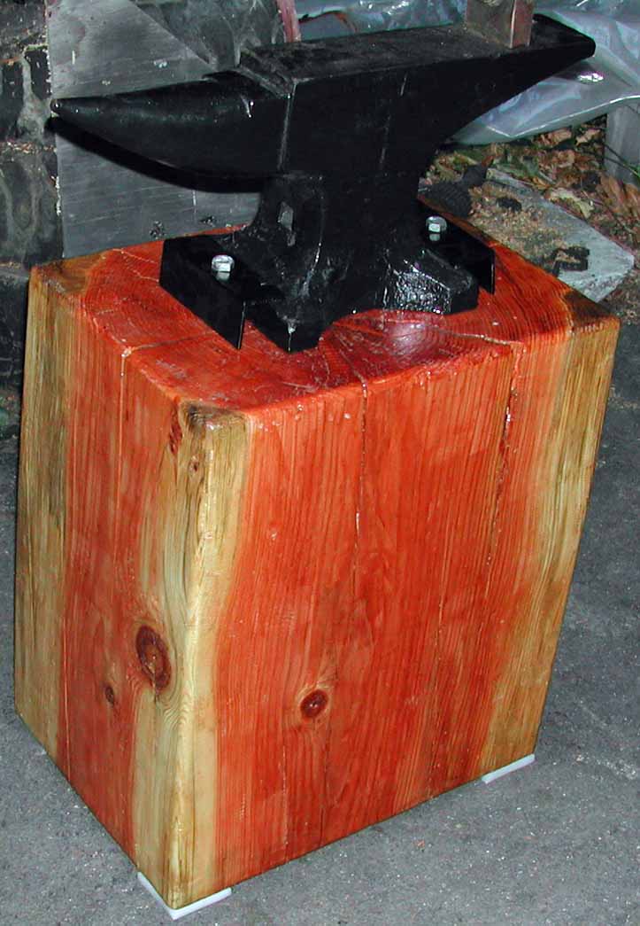

My anvil weighs only 106# and I installed it on a large fir block. It stays outside, but I oil it and cover it when it rains. It is great to have, even tho I do no smithing of any quantity.
For a 200 pounder, consider an installation like mine, but put 2 wheels on one side of the base such that when you tilt the assembly, the wheels touch the ground. When not tilted, the base is firmly and directly on the ground.

Yeah, that's right.
THIS^^^.
