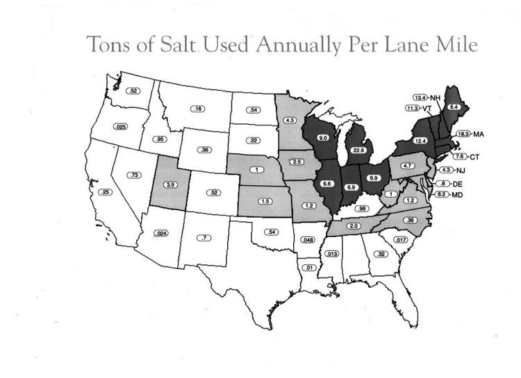

Here's a map of road salt usage per lane mile annually per state. As you can see, Kentucky uses half as much salt as Tennessee, 6 times less salt than IL, IN, OH. 8 times less that WI, and 23 times less than MI. In fact, KY uses less salt per lane mile than any state east of the Mississippi and north of the Tennessee/North Carolina border with the exception of Delaware. So, yes, Kentucky does not use very much salt on its roads.

/ Dodge Cummins Engine Concern #213
Very interesting map. Pa isn't as high as I thought it would be but I still wish we used way less. I would trade messier roads and needing more driving skill for vehicles that didn't rot out so fast from all the salt.

Don't have to live there to know some facts....
:dance1:
<img src="http://www.tractorbynet.com/forums/files/trailers-transportation/400180-dodge-cummins-engine-concern-roadsaltusagebystate-jpg"/>
That will be a county by county variance. Where I live in KY they use TONS of salt and liquid deicer. The more northern counties use a lot. That's a fact!
The point is, you're arguing that its not a salt problem with Chevys, to a guy that lives in NY, where they use 12X the salt that KY uses, and it affects ALL brands of trucks. :rolleyes:
