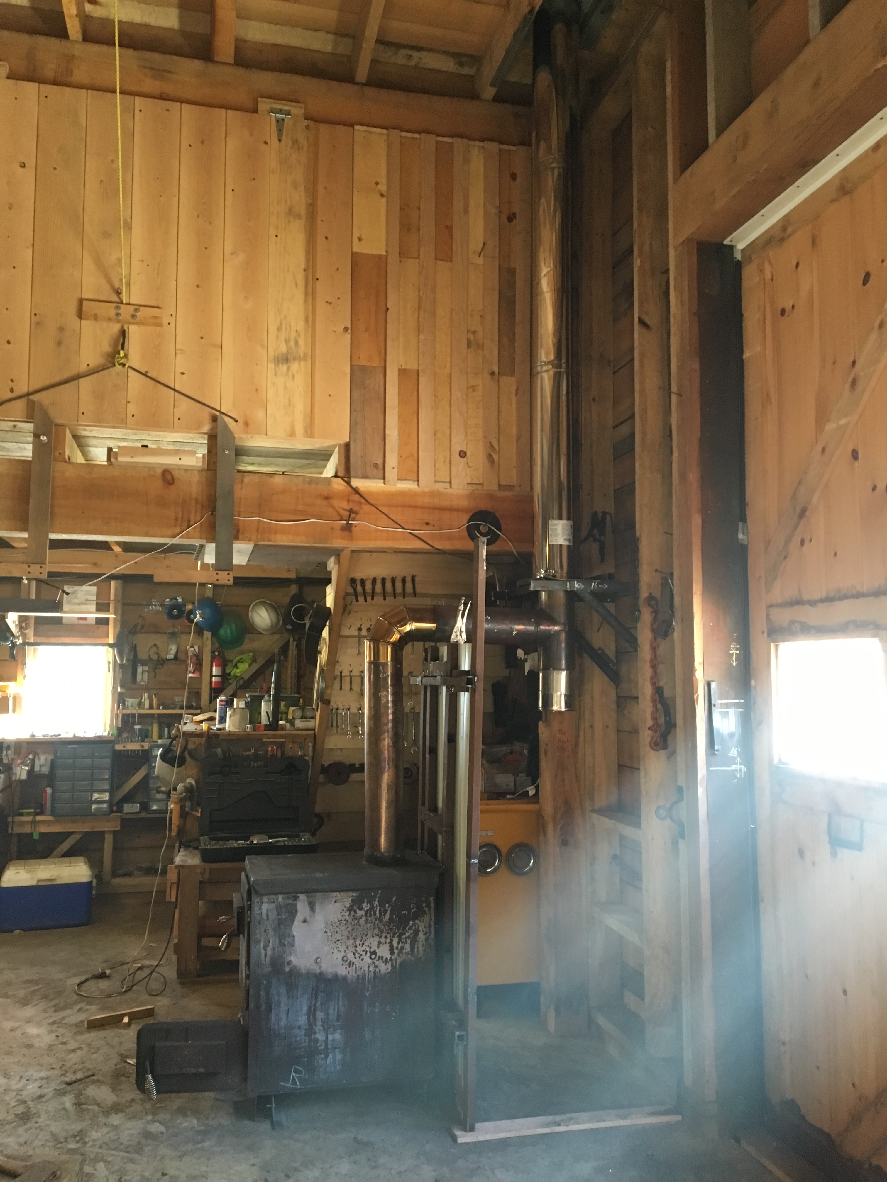

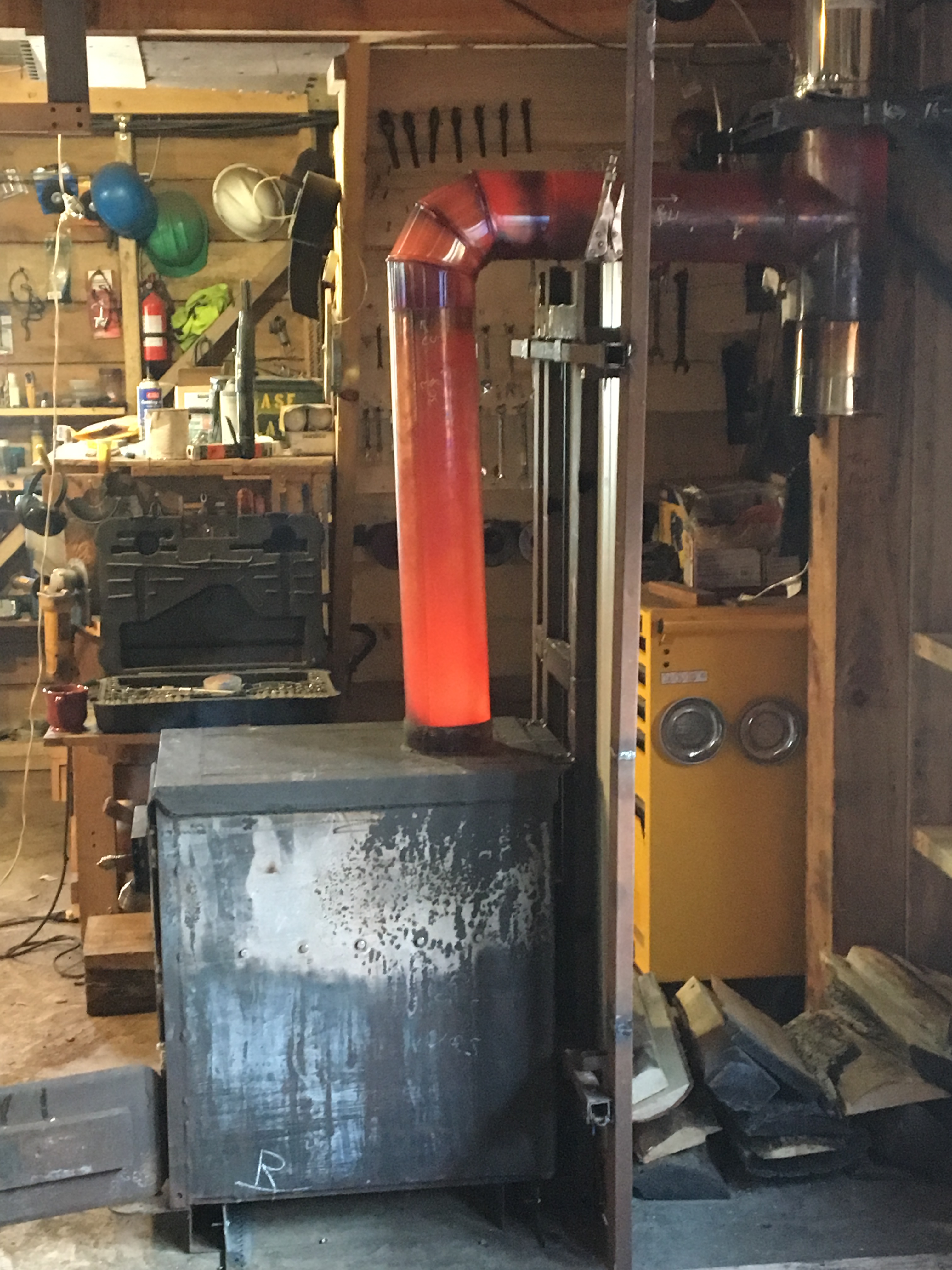

Oldpath,
Just curious why you didn't run your single wall up about two more sections of the double wall and put the transition up there. That would have saved on the cost of the double wall and put more heat into the room from the single wall. The transition at the double/single interface, with the nice shelf you made, could have been a straight transition to sweep the whole thing down to a TEE behind the stove. Just curious.
Nice looking installation.

   / Do we need a warm garage.... #46
I'm curious also about why single wall wasn't used in the room space. I have seen people run double wall so it wouldn't be a hazard if you touch it, but it does improve the heat efficiency to use single wall.

Single wall inside the heated space may not be such a great idea. That's what my FIL has in his cabin and the flue cools the exhaust off so quickly that creosote condenses like crazy. He sometimes has to clean every couple of weeks, or if he doesn't, he gets chimney fires. Even so, he usually has at least a few chimney fires every season :-o
   / Do we need a warm garage.... #49
Not to be critical, but is he burning unseasoned wood? I have 9 feet of single wall to the ceiling of my pole barn and after three years, no evidence of creosote. In my house I have about 6 feet of single wall to get to the masonry chimney. I had it professionally cleaned this year for the first time in three years and the sweep said he found some ash and soot but no creosote.
