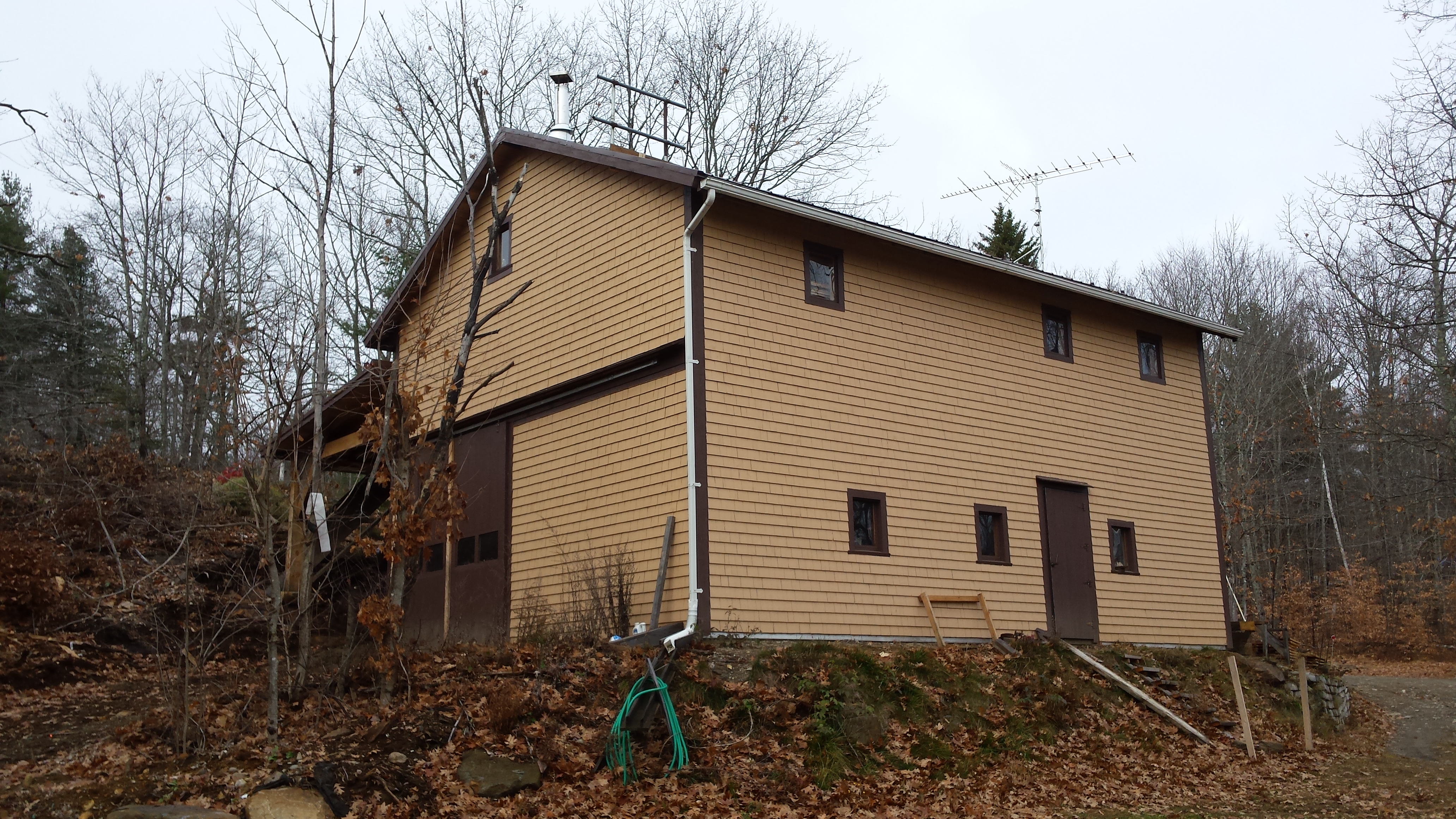

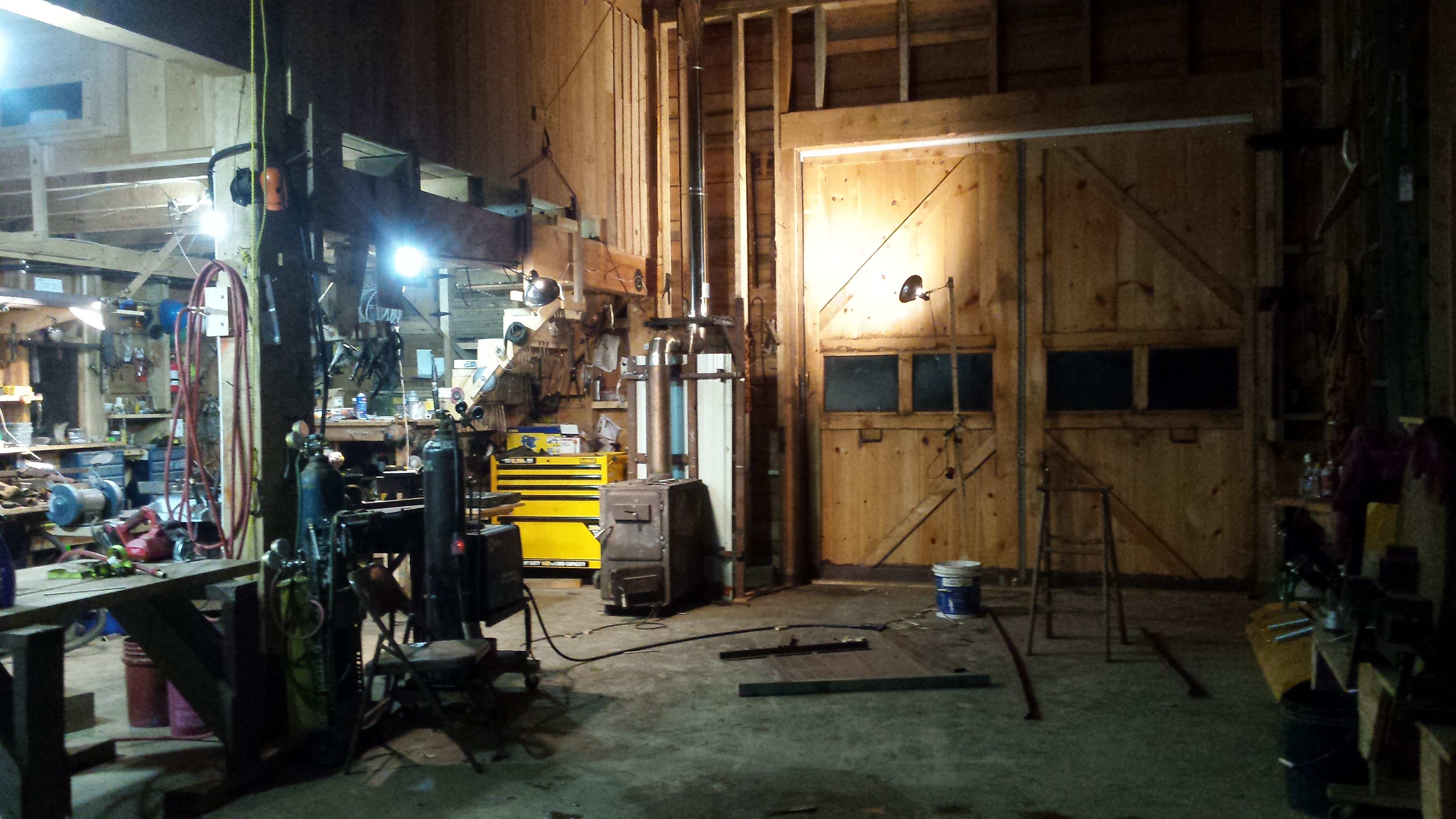

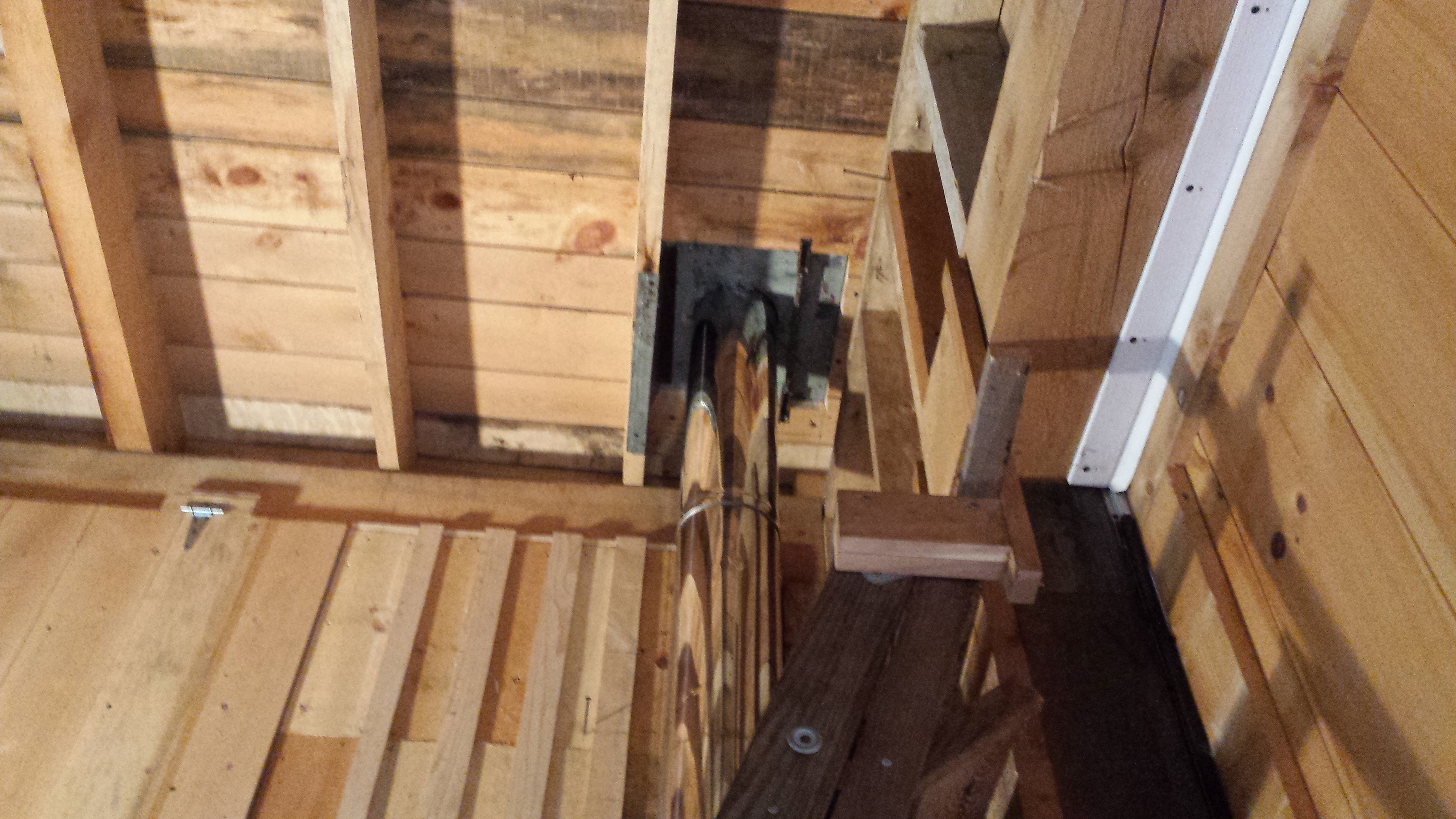

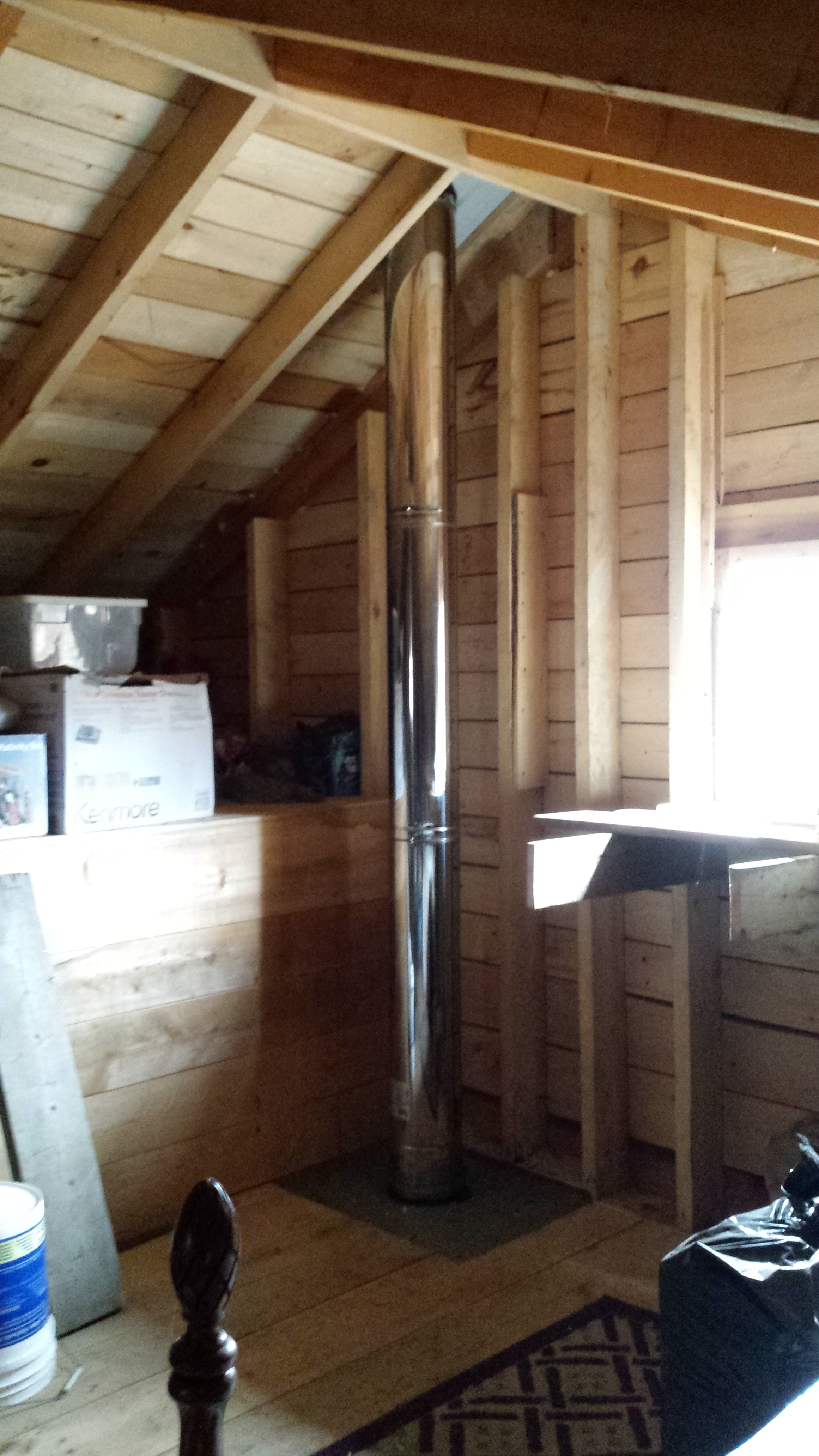

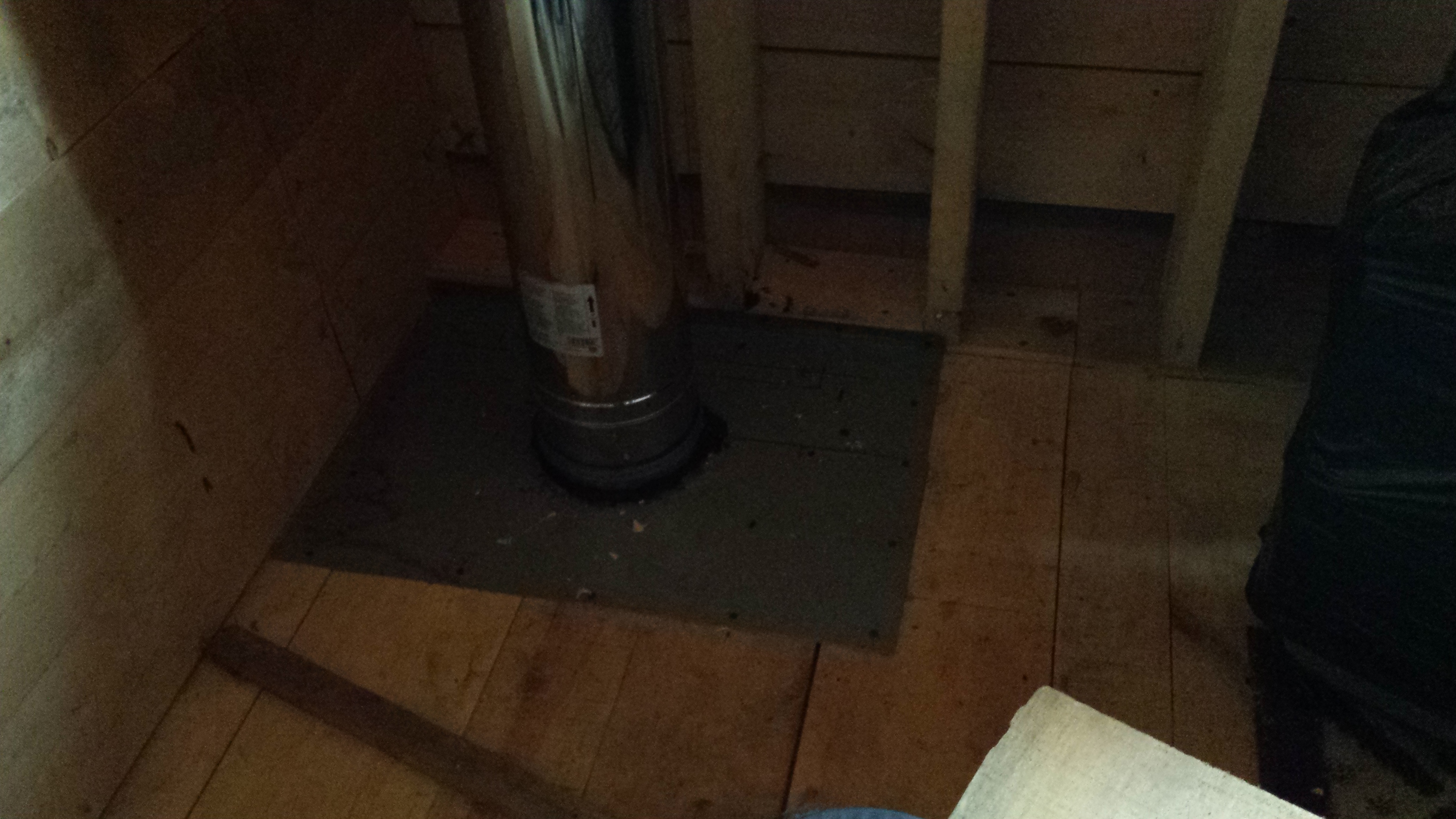

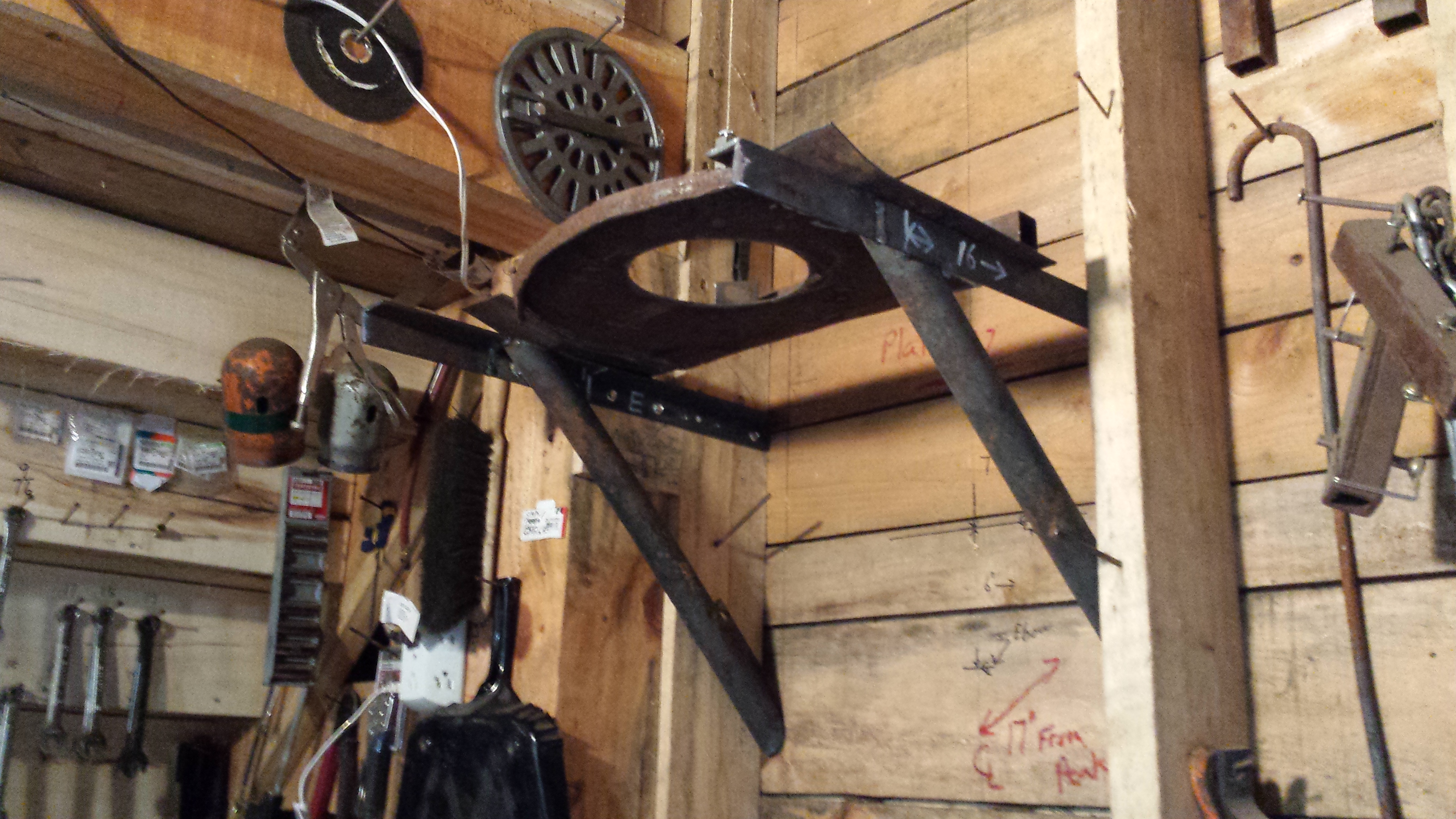

Finally, I'm ready for blast off this coming weekend. I've got about half hr. putting the chimney pipe together, but 20+hr. in prep work, starting with making the stove pipe platform and ensuring that it's in the RIGHT place, required the extensive use of plum-bobs, levels and tape measures. The end result after suffering a few brain cramp's and melt down's, DONE.

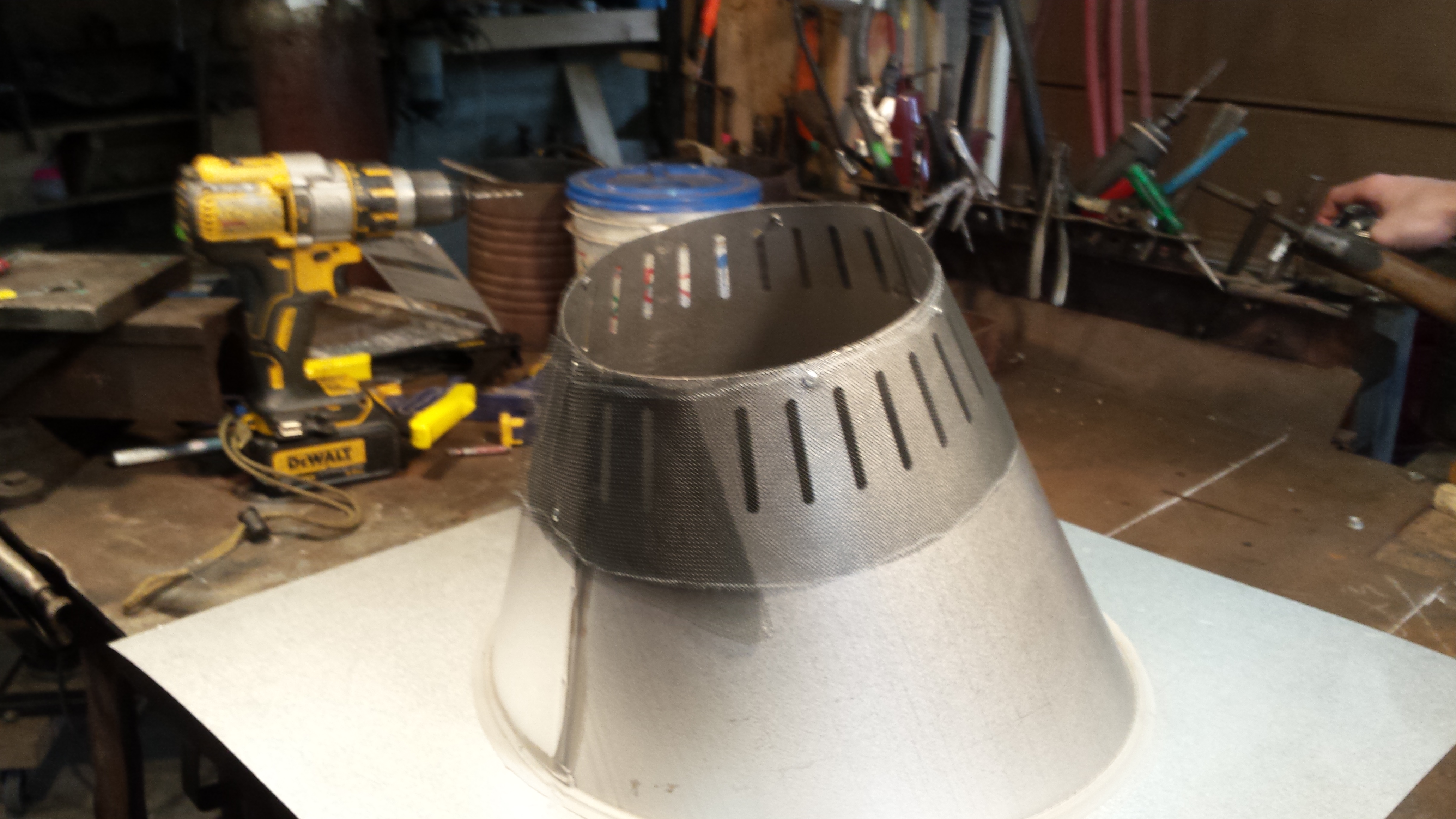

Not to mention putting a screen on the pipe flashing, another brain teaser....

Nice looking shop and nice build on the stove install!
What's the screen for on the thimble and the structure on you roof by the chimney? Oh, one more, is there a clean out on first 90 coming down from the roof?
I used stainless roof flashing, the thimble looking piece, and all the rest was stainless multi wall insulated as well. In the house is stainless multi wall, painted black on outside. The insulated stuff never seems to get warm, but the multi wall, on the inside of the house, will get quite warm, as in not want to leave my hand on it. The only time i've had problem with creosote build up is when burning wet wood.
Yes have a clean out cap under a TEE, and the the second thing I'm curious about, how warm will the double wall pipe get.
The Selkirk roof flashing has 1/4"x 1" hole slots in near the top, I emailed them, why are there holes in that? told them that's a great place for wasps and bugs to build a nest. Selkirk replied (2 thumbs up for companies response) they say not to seal those holes, has to be vented to let roof heat out, but if I wanted, put some screen around it. First attempt, cut a 4" wide strip of screen, thinking that should wrap around, wrong, next cut a 14" wide piece, wrap that around, draw the line, then cut 4" wide-ish, ended up banana shape, wrap it tight again with a 3rd hand holding it, 1/2 dozen pop rivets and hr later done, was another one of those frustrating moments.
