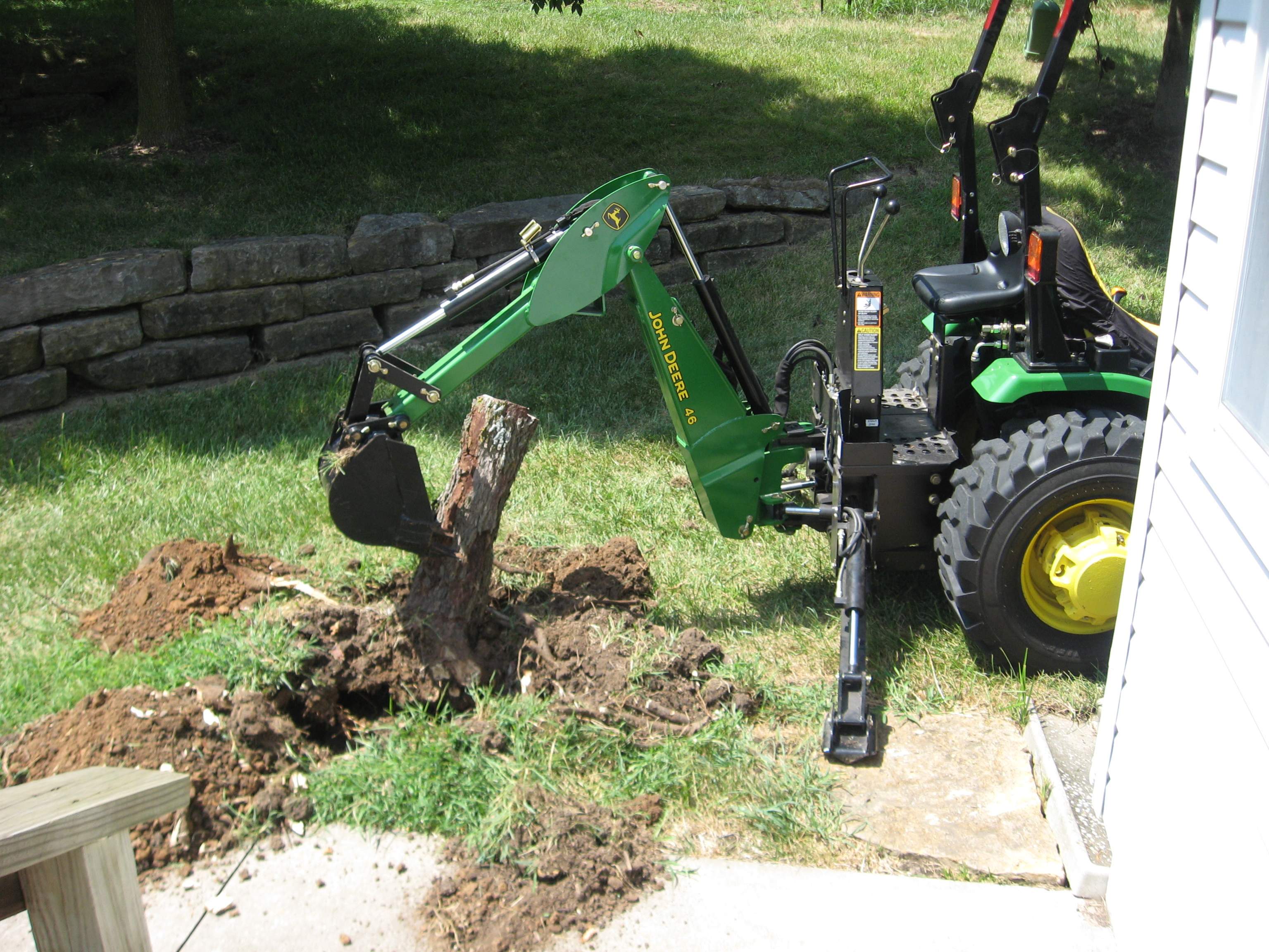

/ Do TLBs make "bad" tractors? #10
"What's the average homeowner going to do with a backhoe?"

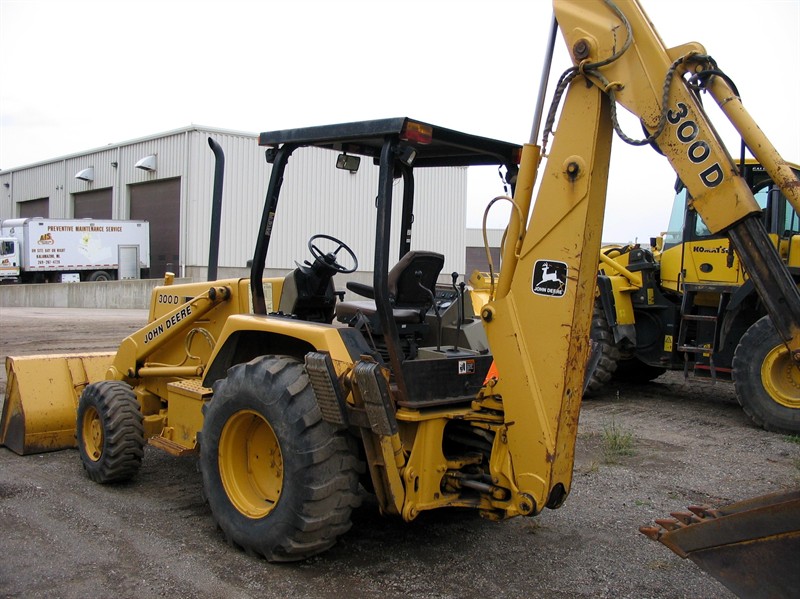

Just because something is called a TLB doesn't mean much, you really have to compare the capabilities.
