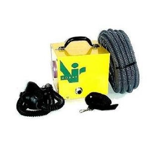

For the occasional use, id highly recommend the Hobby Air unit. I have one and love it. I brings in outside air and runs it through a garden style hose 50 feet to a 1/2 face mask. All you breath is outside air while welding, cutting or painting.
I mounted mine permanently on top of my air dryer and ran a 4" flexible duct to the outside.
Its not cheap, but i do like my lungs. Don't want to think about going thru retirement hooked to an oxygen bottle.
