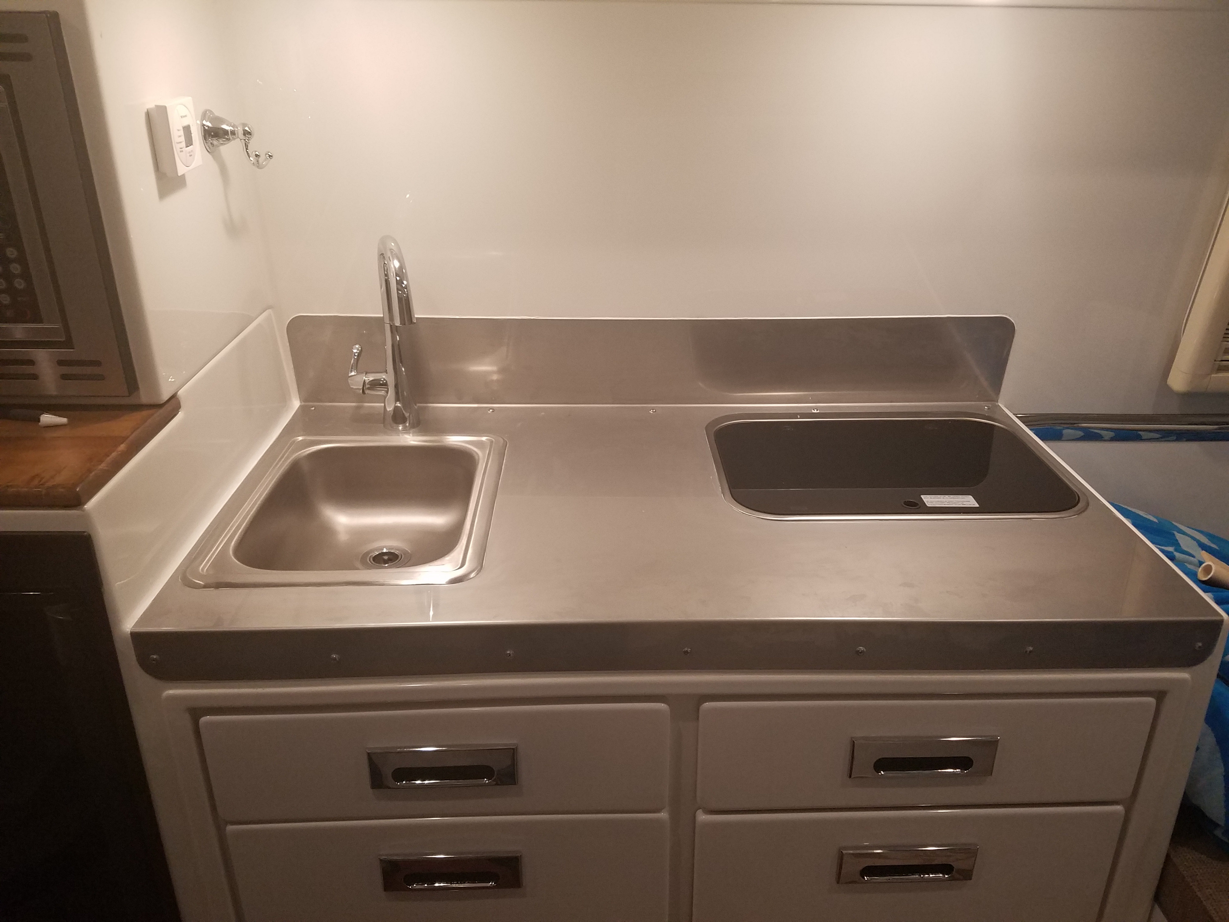

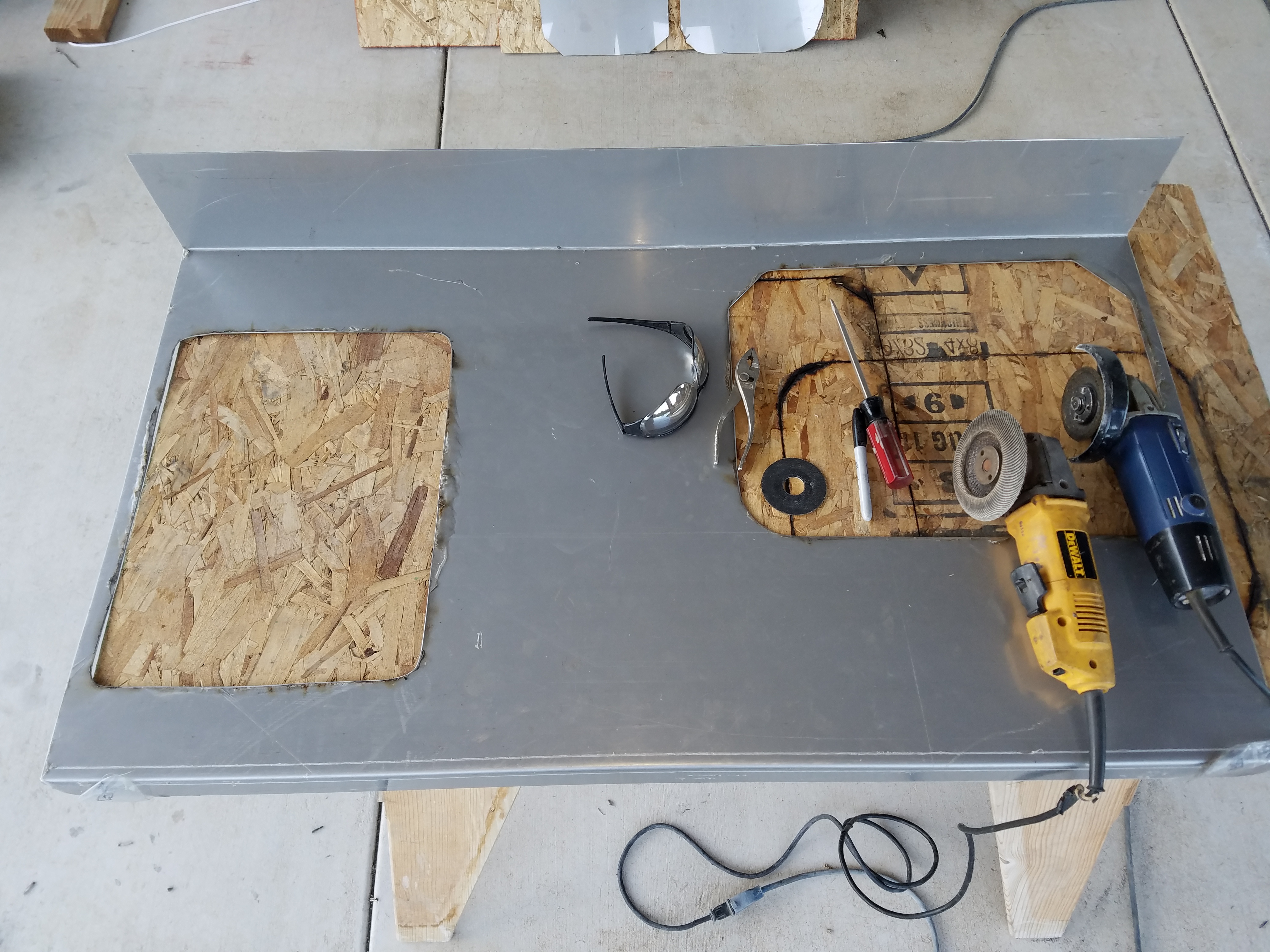

I just installed a stainless steel counter top in my trailer. Love stainless.
