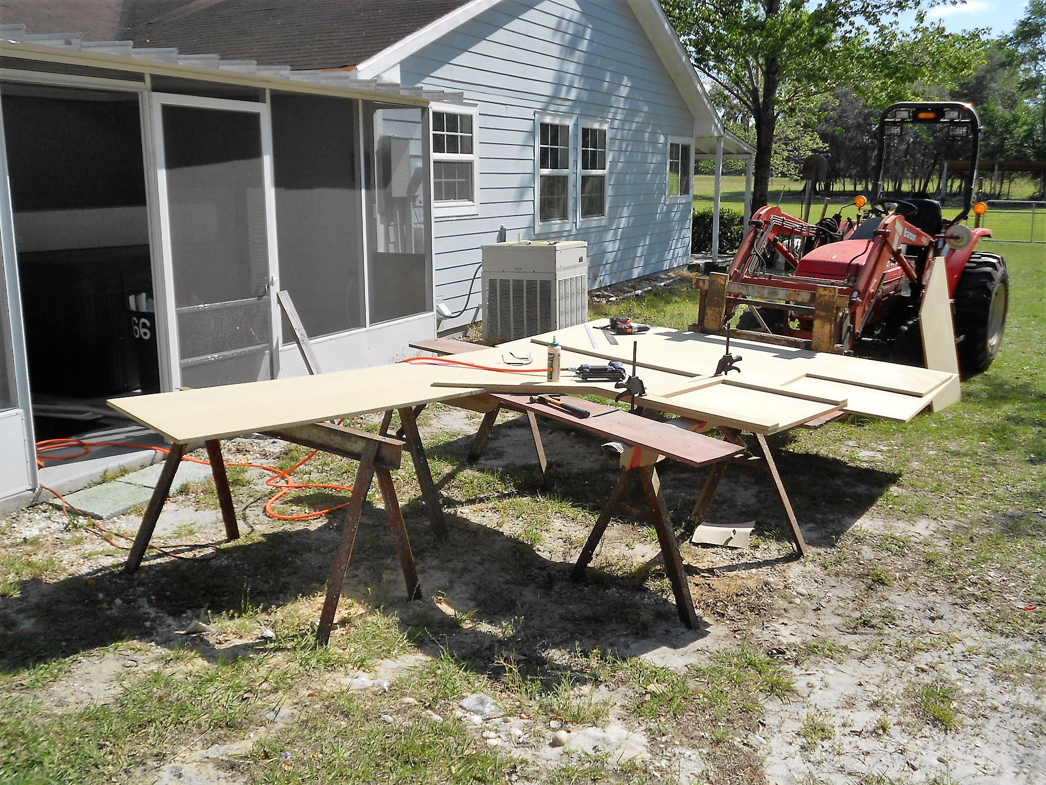

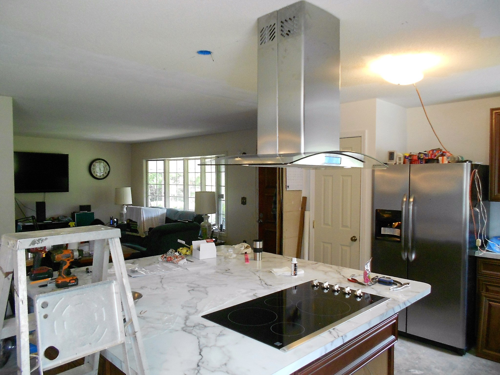

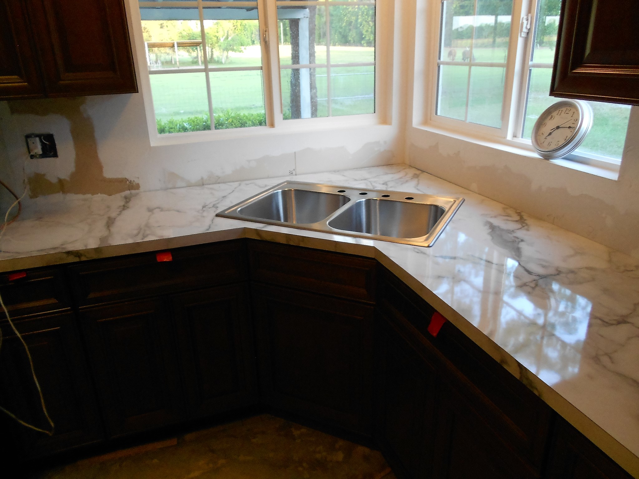

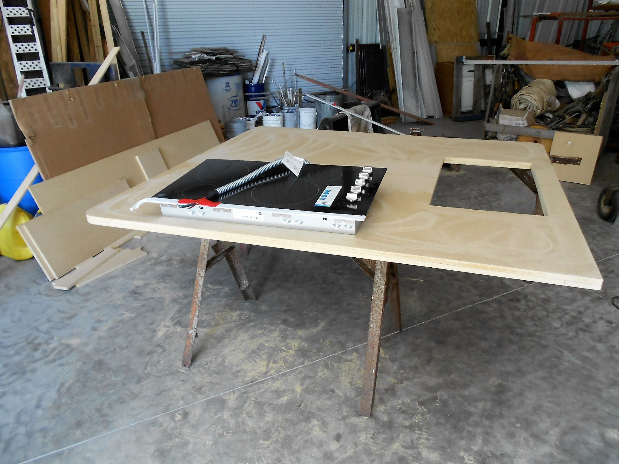

I recently posted about RTA Cabinets (ready to assemble) and found them online and have them installed now in my total kitchen remodel.
I started pricing counter tops and found they want STUPID money for the granite/quartz/solid surface.
I needed 90 sq ft total and the cheapest was some thinner stuff for $3500. What I really liked was $7800.00 !!!!!
I then looked at Formica/Laminate, them fabricate, i install- $2000. They fabricate and install- $2600.
I started watching laminate u-tube videos (there are a bunch of them) and I jumped right in!
I bought the laminate online, 5 sheets of partical board,gal of contact cement- Lowe's and a Router and Belt Sander- HF.
Total was under $600.00 !!!
I had to move into my shop because the board was sagging from the heat outside.
The 3 pieces turned out perfect so if you have some skills watch the videos and jump right in!
Plus I now have a Router and Belt Sander! I don't think the other guys would have given me those! :)

/ Do It Yourself Counter tops #3
Looks really nice - I love the orange saw horse in the background :laughing:. Make sure you file or sand the bottom edge of the face- it can be as sharp as a razor, I also touch the top edge where it meets the face edge - I lightly file that also, removes any sharp 90's

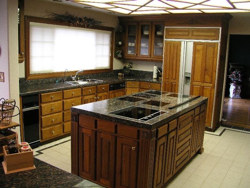

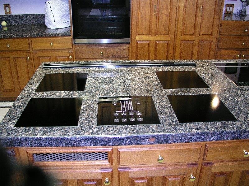

IMG_0005.JPGIMG_0006.JPGIMG_0001.jpgIMG_0002.jpgI like the natural look of granite, but I couldn't afford the labor prices. I bought 3-5' x10' sheets of granite slabs from
India and made a roller bearing frame for my worm drive saw and a some tubing for water. Then I used two pieces of 1"x2" tubing with rubber glued on the bottom as guides for cutting. I bought a diamond wheel and a set of diamond pads in several grits. All together about $2500.00. Check out the photos.

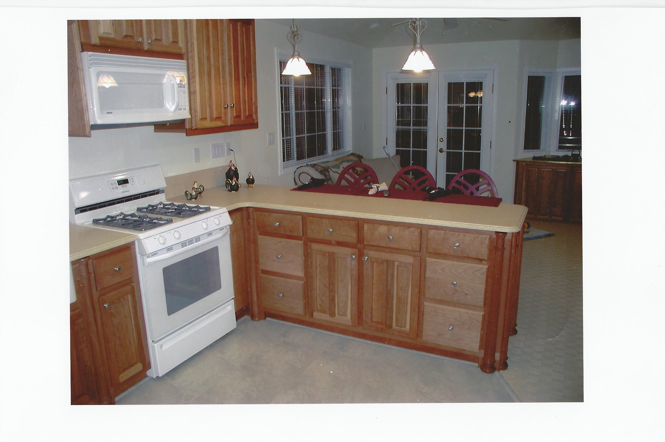

The next ones I did in my houseboat, but I needed to keep the weight down so I used solid surface(acrylic) calle Topstone, colors match close to Corian. Much easire than the granite but no as durable or nice looking.

aircommuter, that was an ambitious job! Not sure I have the patience for all the sanding to get the cut edges to a polished state!
/ Do It Yourself Counter tops #8
Most of my work is the work of a crazy man! I used teak for the cabinets with the granite and natural cherry for the other ones. That was a bit of work in itself.

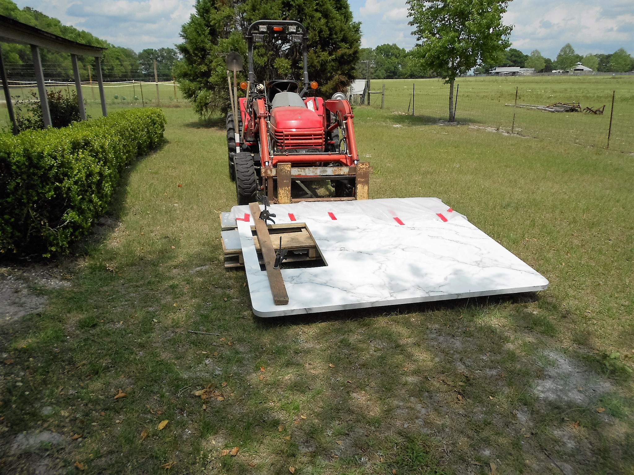

#9
Watching all the u-tube videos really helped and they covered filing and sanding both edges.
When I moved the 6' X 6' island counter in the house I didn't have any help so that orange (Red really) saw horse came in handy! :)
I bubble wrapped one edge and slid it in the house, not fun.

I really like the electrical work,.... over by the fridge!

Aircommuter, that was a lot of work, my fear would be I screwed up the granite. At least with their high price comes their responsibility for mistakes.
In one of the videos the guy used metal shears for initial trimming, others had laminate shears. I have several air shears so I tried it and it worked great.
I used a 1/2" router bit with the ball bearing on the bottom for final trimming after gluing.
Also another trick is to glue edge on first then top which gives an even edge.
That partical board is very heavy! I never realized how heavy it is.
Belt sander was great for truing up the board edges where I glued strips to get 1 1/2" size.
I bought the laminate online and with shipping was $408.00. I figured if I screwed up an area with all that I saved I could still come out ahead. Laminate came with a tear off plastic that really helped protect it during fabrication.
Don't need no stinking licence!
The white extension cord has an off/on switch in it.
That is temporary, you can see the handy box in the ceiling over the island for the new lights. I got a 3 pendant light bar to go there.

I have tried Formica a couple of times and I always end up with tear out (chipping) when I use the router to trim after the glue down.
#14
From the videos- You need to run the router counter-clockwise to the work.
In other words you want the blades turning into the work not going backwards.
Not sure if this was your problem. ??

Very nice looking marble pattern! I love granite except the price but I can see going with laminate if you just can't stomach the cost. And it is extremely practical. Carbide router bits w/bearings and a decent sized router base helps a lot for edge work.
