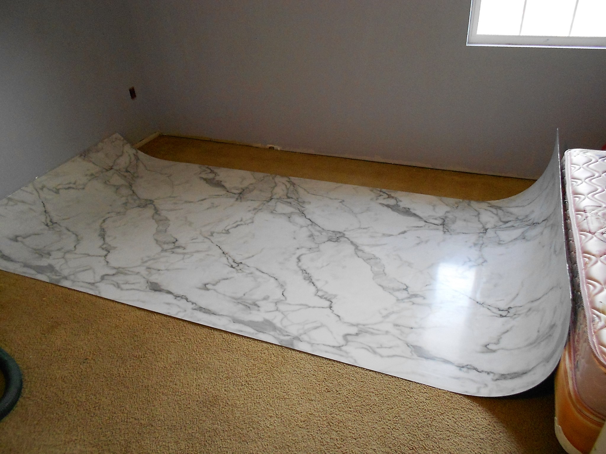

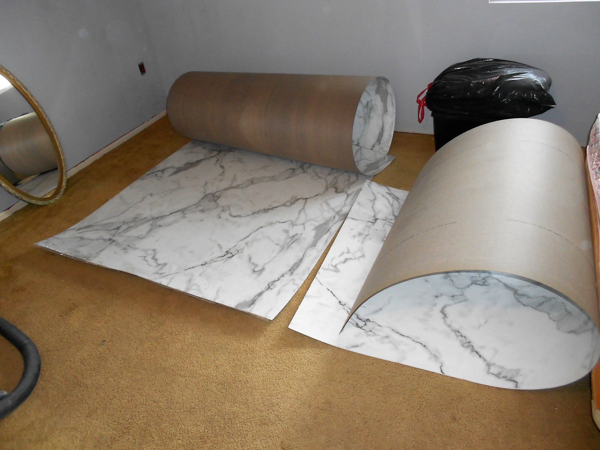

Here is where I ordered laminate from, they carry several manufacturers so I'm guessing the quality is close to the same- Sheet Laminate | Cabinetmaker Warehouse
I got a 5' X 12' and 2- 4' X 8' sheets with shipping came to $408. I needed 90 sq ft so it worked out for my counters.
The glue is just Contact Cement, I bought a gallon at Lowes for $30. I still have 1/3 left. Put it on with 4" roller and paint brush.
Lowes also had a laminate roller (very nice one) for $22.
