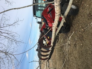

looking at the forks /plate you have posted
maybe start with the plate and forks and make it adaptable to have a grapple lid added .
Mine is built that way- kind of a manure/construction bucket with a bolt on grapple.
Non tied round tined design, Opens to 49 inches 66 inches wide and works well for pine needles, manure, brush and other stuff

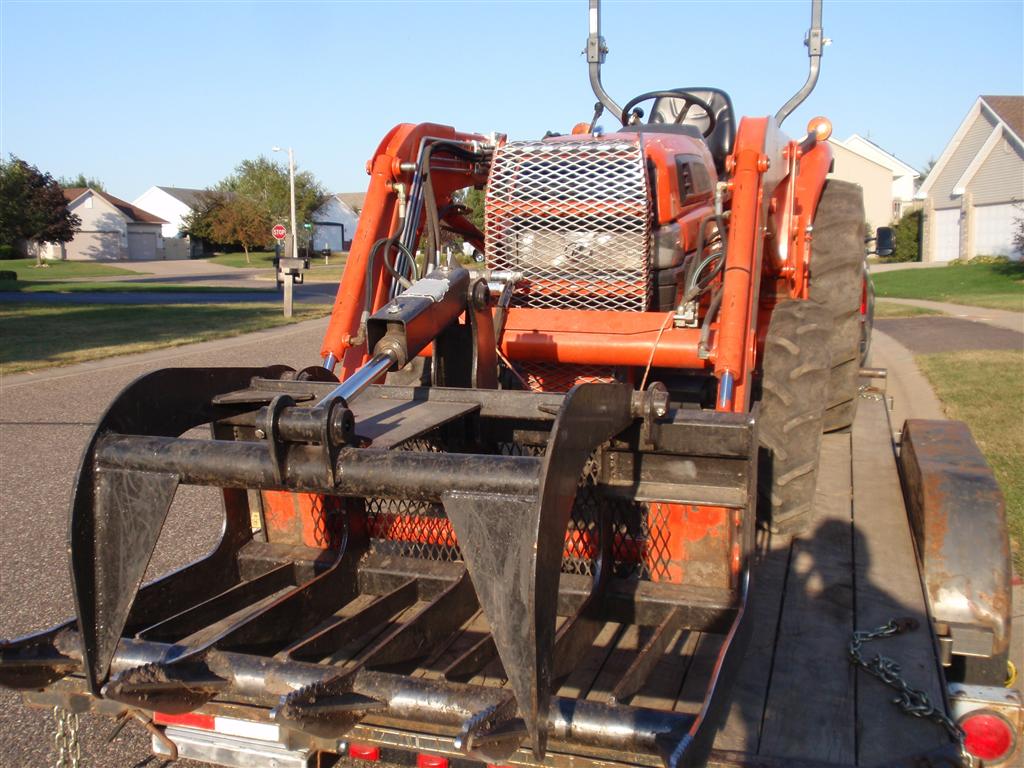

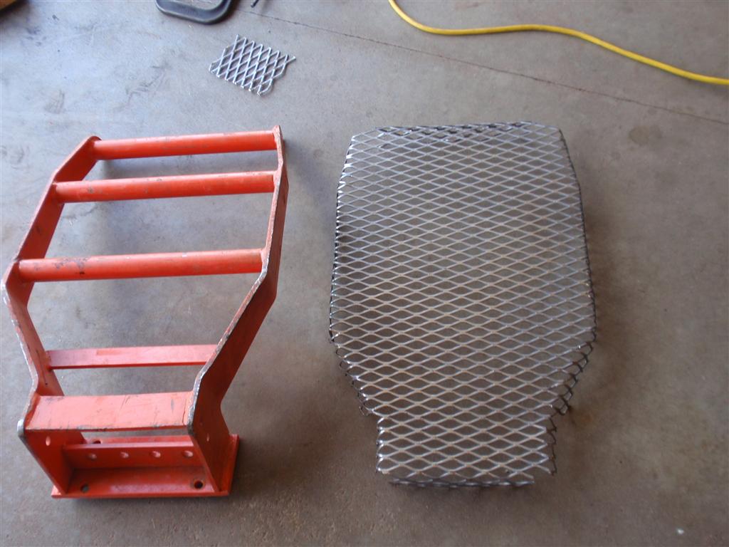

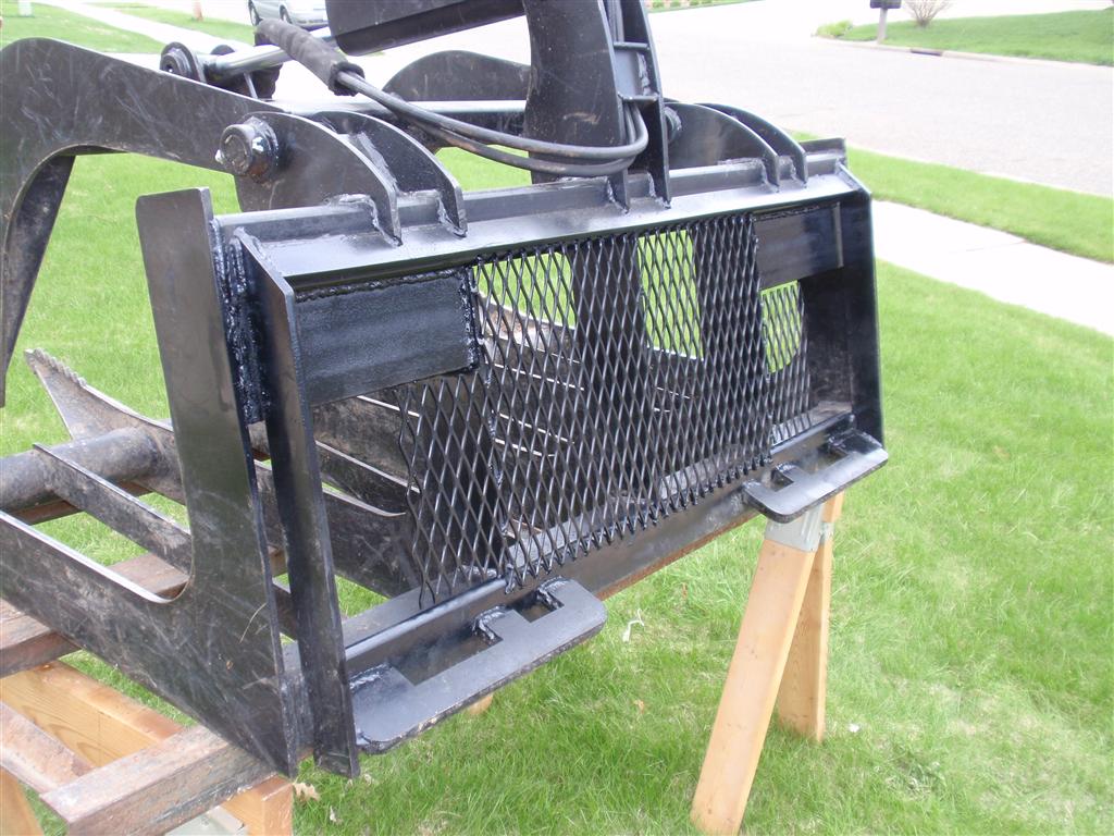

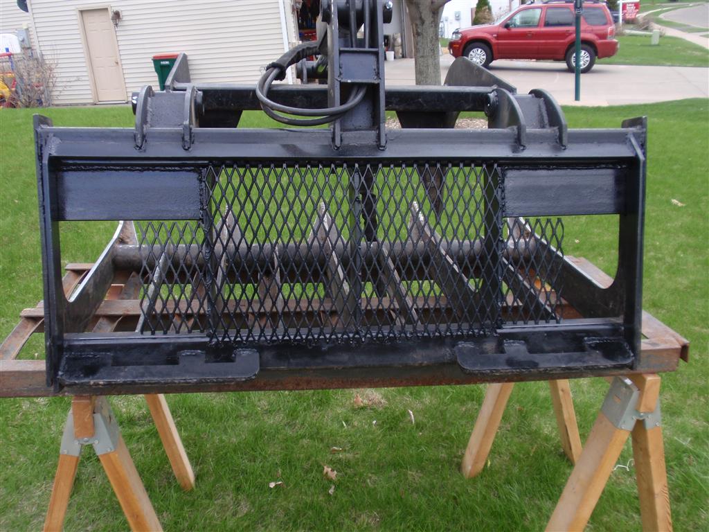

I started with forks as the dealer told me they would be all I need for brush hauling. I really wish i could get that year back as they are horrible for brush. The only way to do it with regular forks is to load by hand or everything just falls off. When i got my grapple I was in brush and log hauling heaven. Adding a "lid" to the forks would also be helpful for brush, but probably not as much with logs.
I took a slightly different tack at protecting my tractor from brush poking through. My first tractor I did a front guard addition of expanded metal just like someone posted above. But then I modified the grapple and added expanded metal to the back of it. It helps scooping up brush as it has a stop to keep it from going right through.

That's a great idea! I haven't worried about it on my old Kioti because it is missing most of the front end parts anyway. I need to do something to my new tractor or it will look like the Kioti soon. Lol

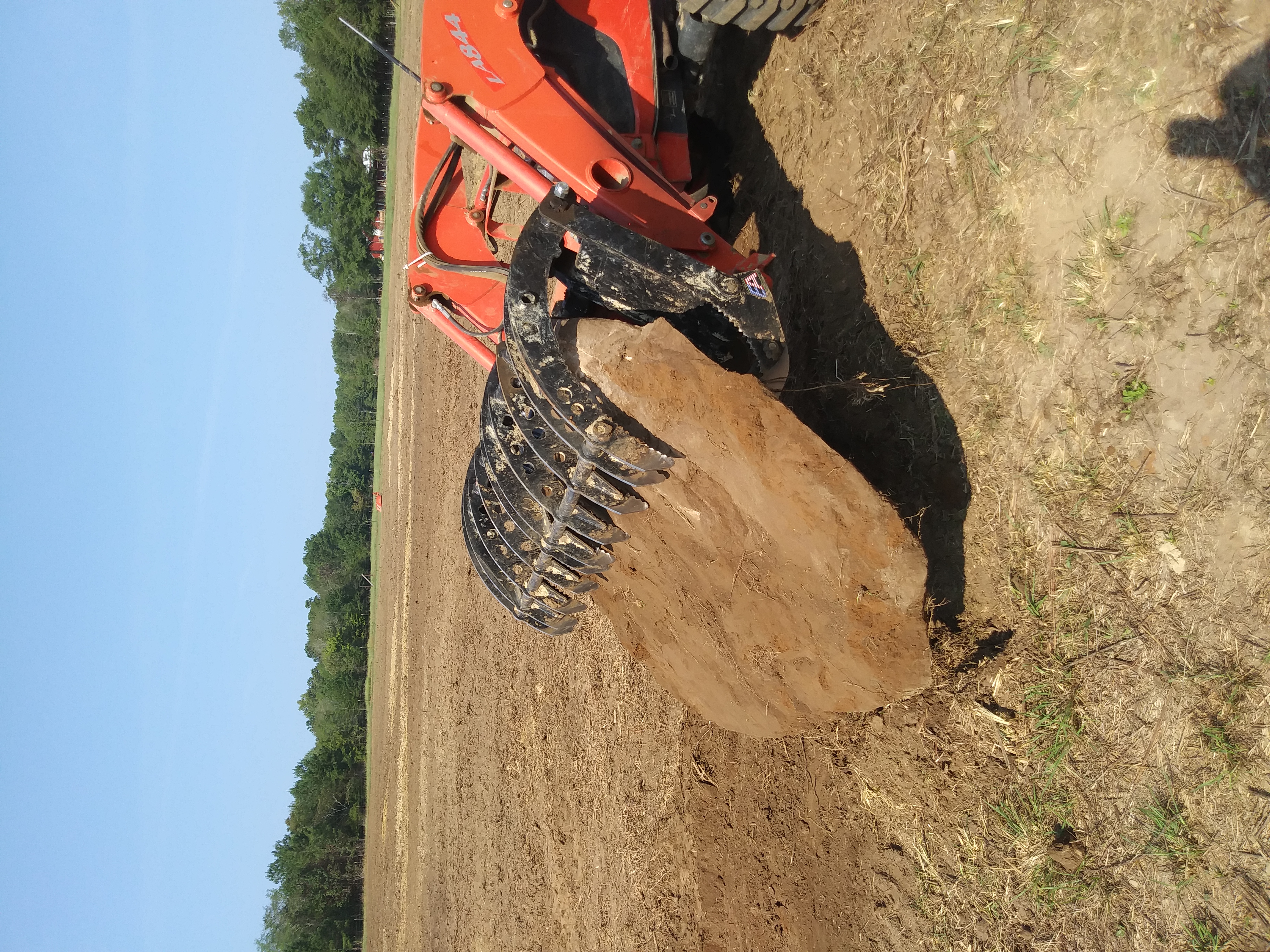

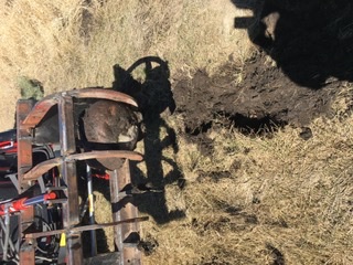

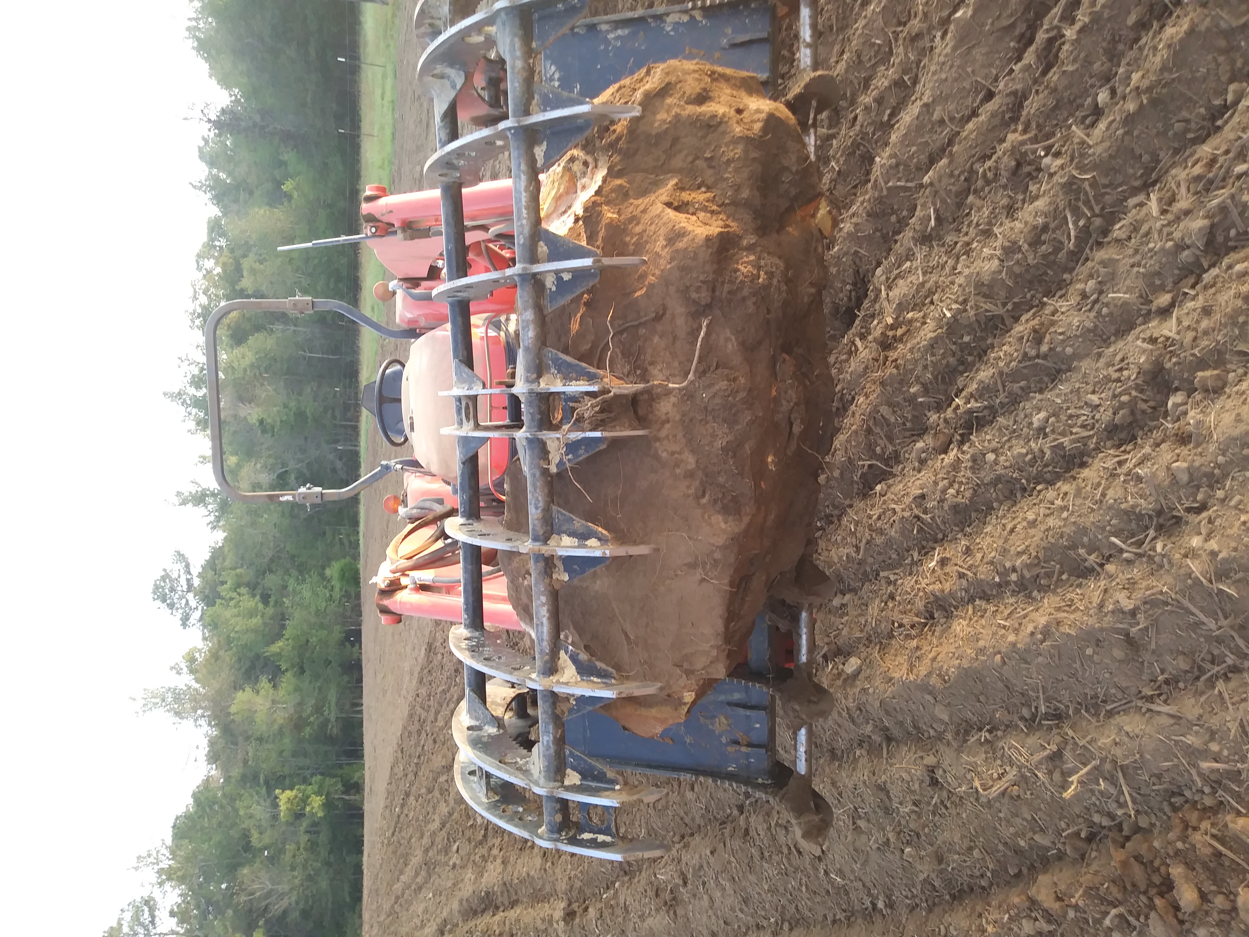

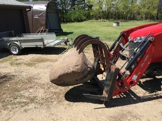

did someone mention moving / digging up rocks with a grapple ?

Hey Ken - that center picture is a POTATO - not a rock. :dance1: :laughing:
/ Do I really need a grapple? #53
Hmmm.. must be one of them thar Idaho potatoes.
