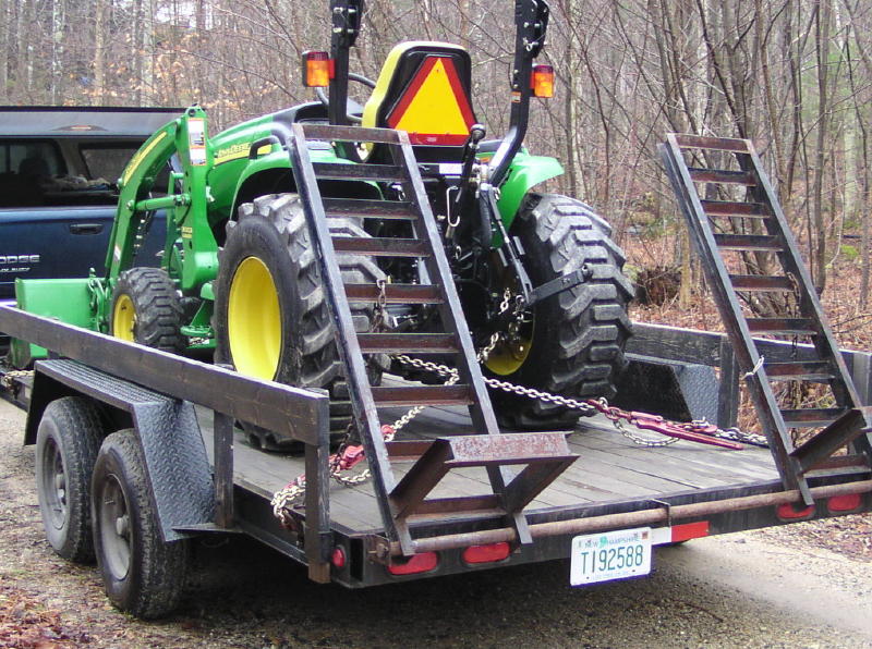

My 16' 10K trailer weighs about 2,200 lbs giving it about 7,800 lbs payload capacity. My 3320 with FEL and loaded tires is about 4,500 lbs leaving about 3,300 for other items, plenty for me but maybe not for you. As you can see from the photo, there is not a lot of room for other items unless I get the bucket up on the A frame.
If I had your potential load to haul, I would get a 20' trailer for sure and probably the 12K GVWR. You don't want to be running at max load all the time.
My guess is that for 20' trailers the 10K would weigh about 2,600 lbs and the 12K would be 2,800 to 3,000 lbs.
