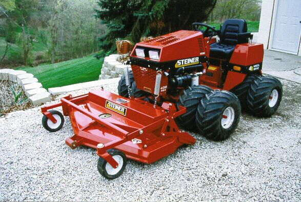

We just bought a house (November 2014) on 13 acres in North Alabama.
The property is hill side (everything is sloped, partially steep).
Out of the area about 1-2 acres is grass, the remainder is forrest.
I have a 1992 riding lawnmower, and I think I want to upgrade to a tractor with a FEL and back hoe, as well as mowing deck.
4WD to avoid wheel spin.
Eventually I want to put a trail in the forrest, possibly make a pond or pool. Maybe even have a level grass surface.
What are your thoughts?
Do I NEED a tractor or is this the kid in me wanting a "Toy"

General use tractors are not too good on slopes, especially for operators without experience.
I would consider a Ventrac, Steiner or Power Trac brand, all of which are engineered for slopes.
There is a specialty VENTRAC/STEINER forum and a specialty POWER TRAC forum here on tractorbynet.com. You need a certain mechanical aptitude to enjoy a Power Trac.
Most Newbies think they want an optional $7,000 backhoe. A significant number of backhoes sit in storage, unattached to the tractor, after the novelty wears off.
VENTRAC LINK: Ventrac Compact Tractors & Attachments

Only thing I'd add is what was mentioned about steep slopes and pictured in post #3 with the Steiner mower. I also have a large zero-turn for lawn care. However, if I had slopes or hill(s) like pictured I'd spring for a mower like that first, then buy a tractor if/when I could swing it. It's an expense to furnish a homestead property, but well worth the investment down the road. 50's, 70's, and 90's model tractors still pretty much bring their original MSRP, if you own it 20 years I don't see the future being much different. Wish that could be said for new $60,000 pick-ups. :bawling:

Can you or would you be able to straddle the "ditch" with a compact tractor? if so a back hoe attachment would be advantageous...otherwise if the hill is steep on the high side of the ditch...a back hoe attachment on a tractor is not going to work efficiently...
A picture of the ditch/terrain would help everyone understand your needs a bit better...

I had a light-frame Kubota B3300 SU tractor-loader prior to my heavy-frame Kubota L3560. There is little difference in size between the two machines. With any light tractor, as soon as you start to do heavy work, Newton's Law of equal and opposite reaction comes into play. As soon as you dig with a Backhoe or a Toothbar on an FEL bucket, the tractor is pushed around. Standard tractors are laterally unstable. The two small front wheels and large rear wheels, which provide great mechanical advantage when pulling implements, do nothing for lateral stability.
On slopes it is very easy to roll a standard tractor. Very easy.
A heavy tractor, which will also have a wider stance, stays anchored better, but tractors are unstable on sloped ground, unless especially engineered like a Ventrac for slopes. The largest market for Ventrac and Steiners is golf coarse mowing, so you can be sure the riding mower will not be missed. The wheels are equal size, front and rear.
Unlike road vehicles, tractors have brakes only on the rear wheels. When going downhill, weight transfers to the small front wheels, so the rear wheels are unloaded, providing practically no braking. Therefore you must always have 4-WD engaged when going downhill, to have four wheel braking. Most of us keep 4-WD engaged at all times over dirt, shifting to 2-WD only when proceeding on a hard surface.
Tracked excavators have low ground loadings because of the tracks, and a low ground clearance by design. Also, the tracks provide multiples greater stability than the two small stabilizers which let down as part of a tractor Backhoe package.
