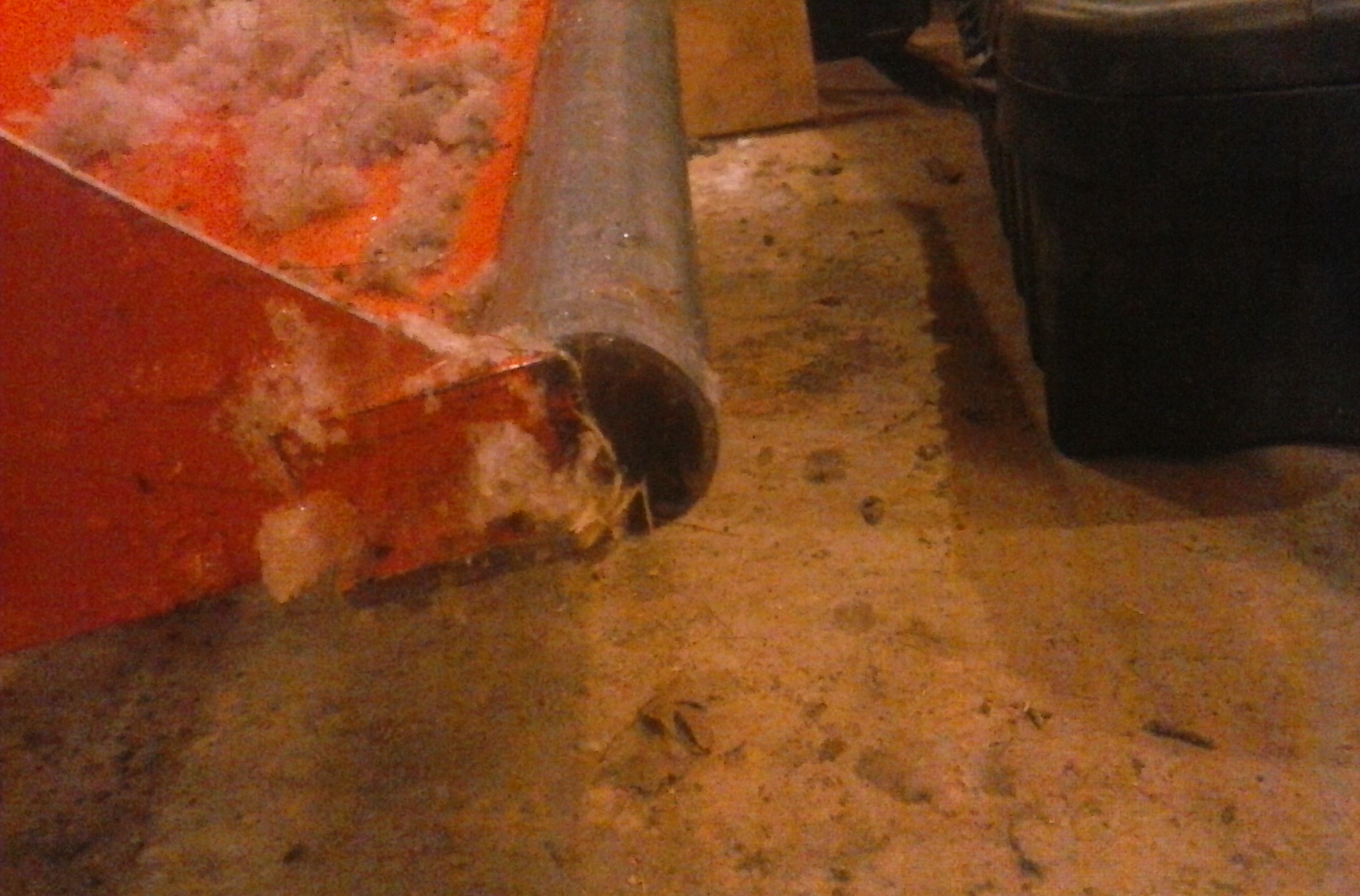

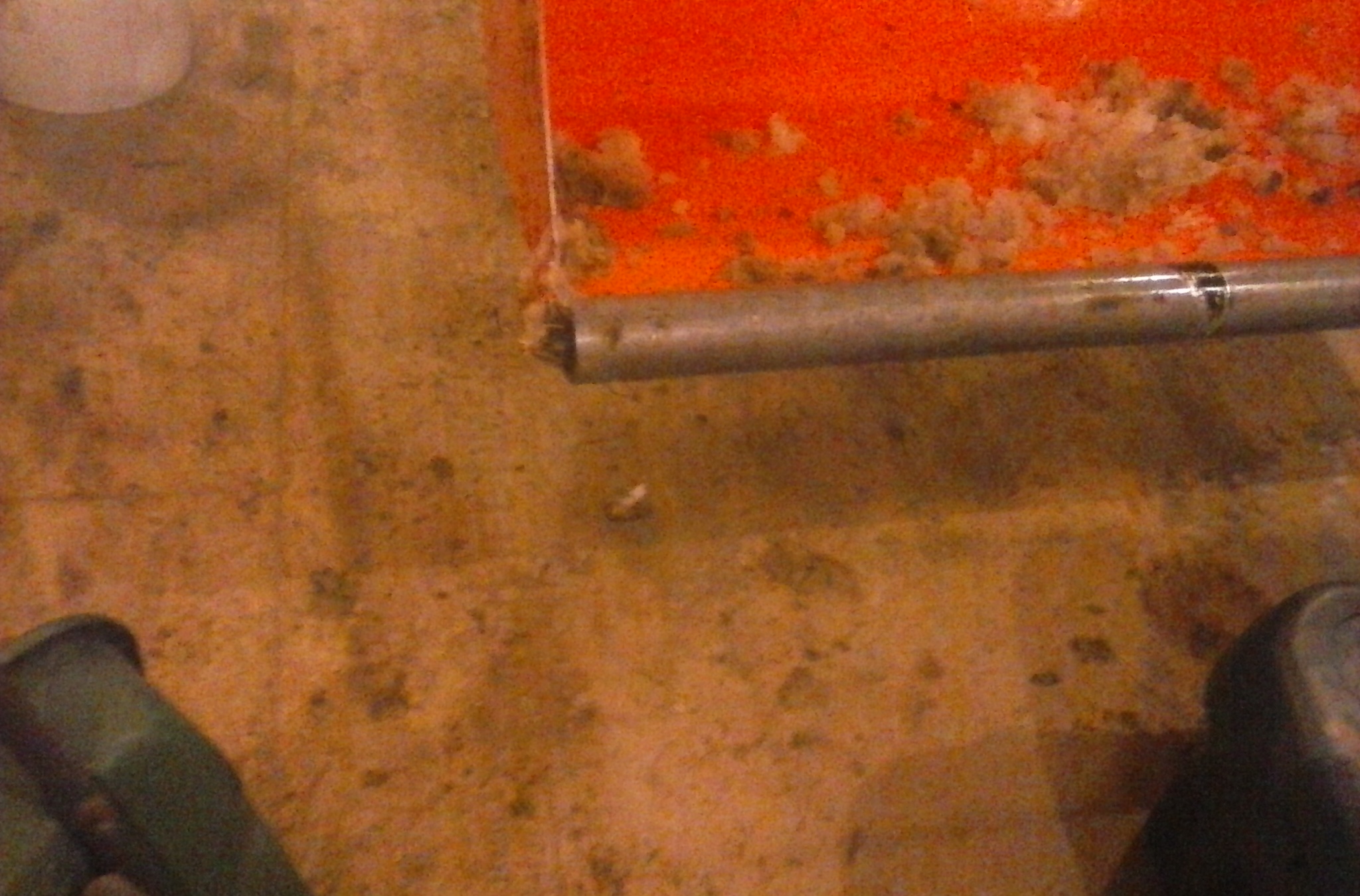

I started to make a set of chains for my BX25D last year but ended up purchasing them. It was just taking waaaay to long to fabricate them. They worked great with the R4 tires and I'm waiting delivery of a set for the front. I have 2" spacers on the back but I think I can use the front chains without them. It's getting too icy around here this year to be able to plow without the front chains. My GMC has 4 studded tires so it will move around OK, but the BX is great for getting into those places that the truck can't...like plowing the path for the oil man. I put a 2 1/2" split pipe on the front edge of the FEL bucket to prevent digging up soft ground and that works great! I also have a home made back blade that scrapes snow pretty well after the ground is frozen. Will post pictures when I get the chains on.

Can you please post a picture of you 2 1/2" split pipe you use. I'm curious.
Thanks
Here you go! I just drew a straight line down the length, took the sawzall to it, then just get a BFH and pound it onto the edge of the bucket!

Your a genius - who would have thought of that? :cool::D and I even happen to have a chunk available. :thumbsup:
Sorry but I can't take credit for the idea...saw it on TV when some little league team used PVC on plows mounted on ATVs to clear a ball field. Look on GOOGLE and you will see lots of other applications. Some people add some brackets to hold it on but it's pretty tight on mine. If it loosens, then I'll add some angle iron on the ends such that they can be bolted to the bucket. Have fun!
