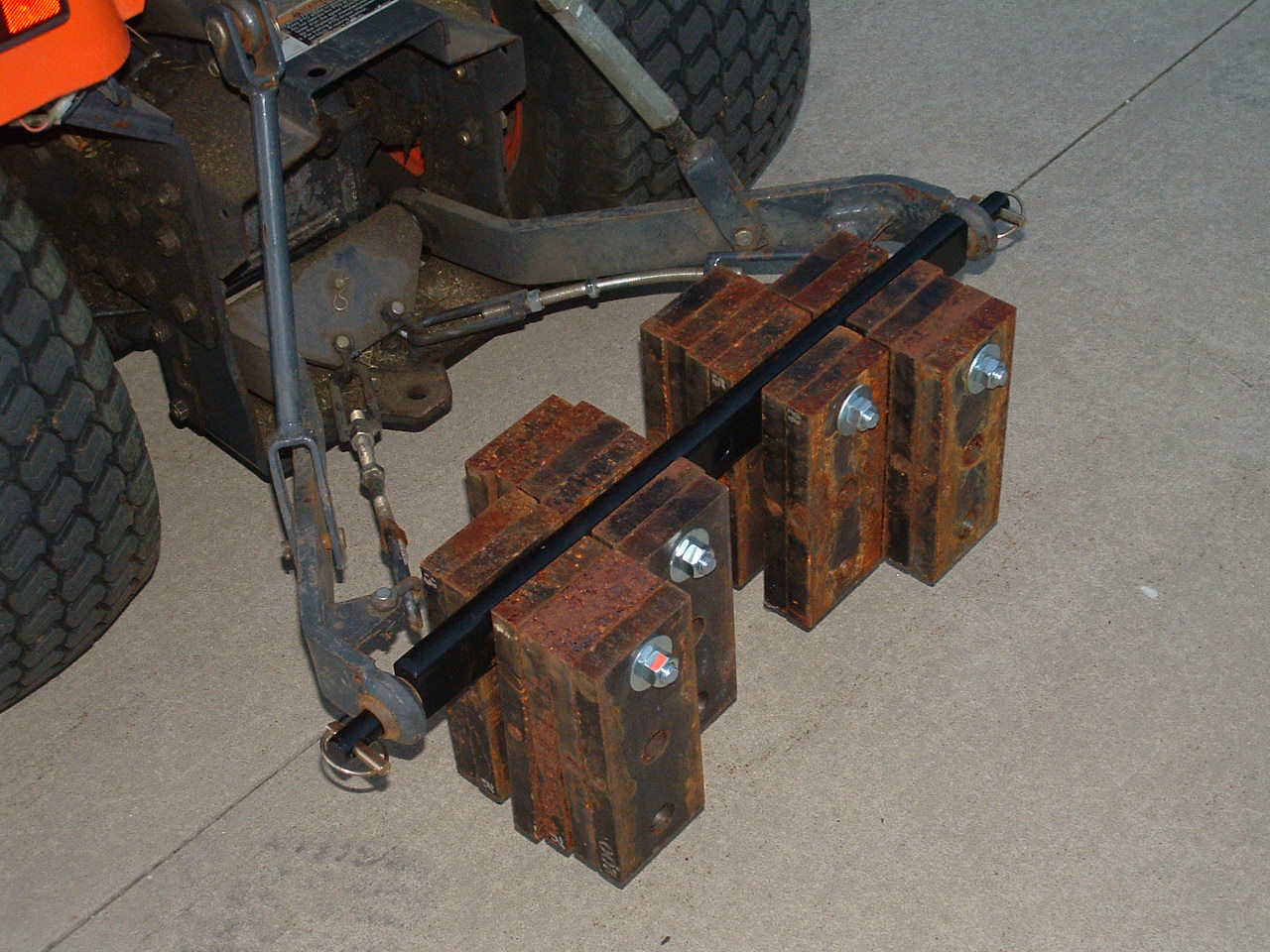

I lucked out this weekend. Went to find some weights for my wheels and the guy said he had plates from a broken universal gym. 25 plates, 10lbs each. I bolted them to either side of a 26" drawbar (ok, only 24 of them so far). It is absolutely awesome how much it changed the way it handles. And stayed nice and compact too.
