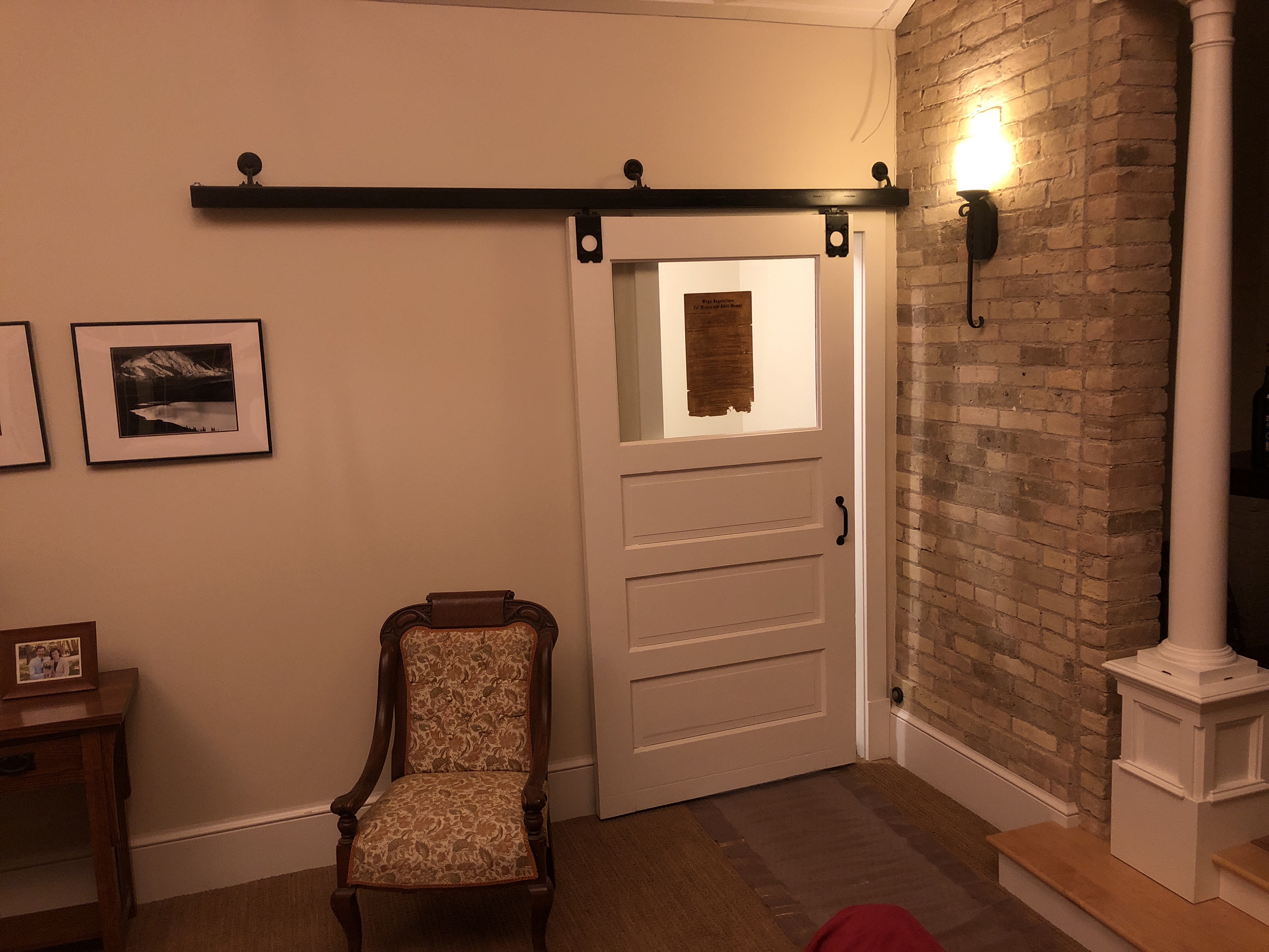

/ Do all pocket doors suck? #18
Is that the sliding barn style door, or something else? I looked at the Johnson and wasn't sure if they include a door or you supply that extra. I will have 2x6 walls but I see they support that dimension.
Yes, this door is in my living room and it used a cheap farm store grade track. The hangers are handrail brackets flipped upside down. There are lots of kits available to do this.

/ Do all pocket doors suck? #20
That is nice looking. Good job!
