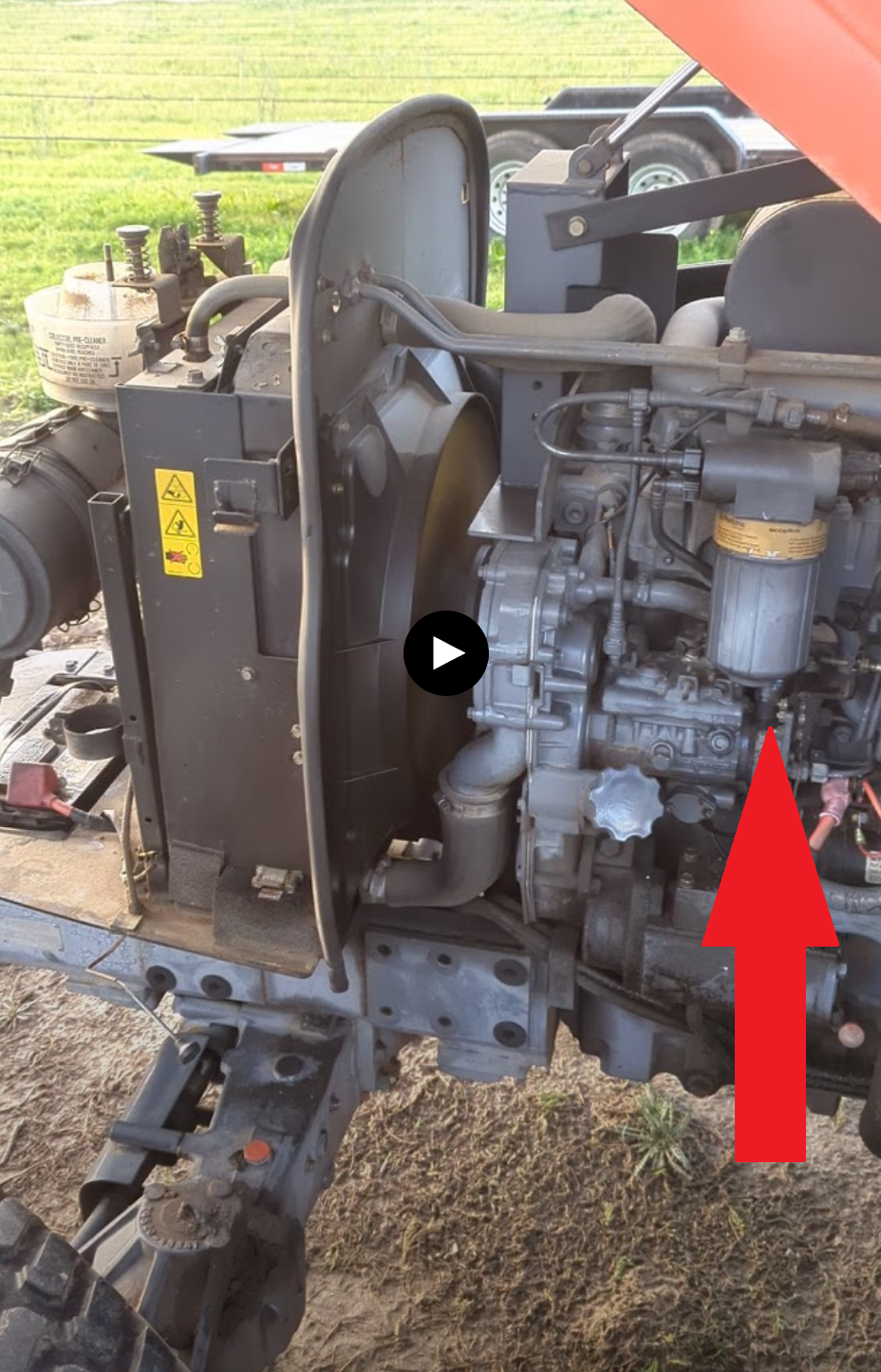

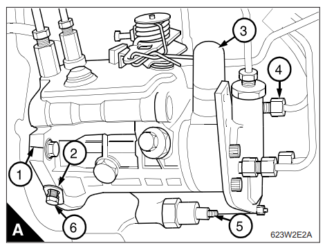

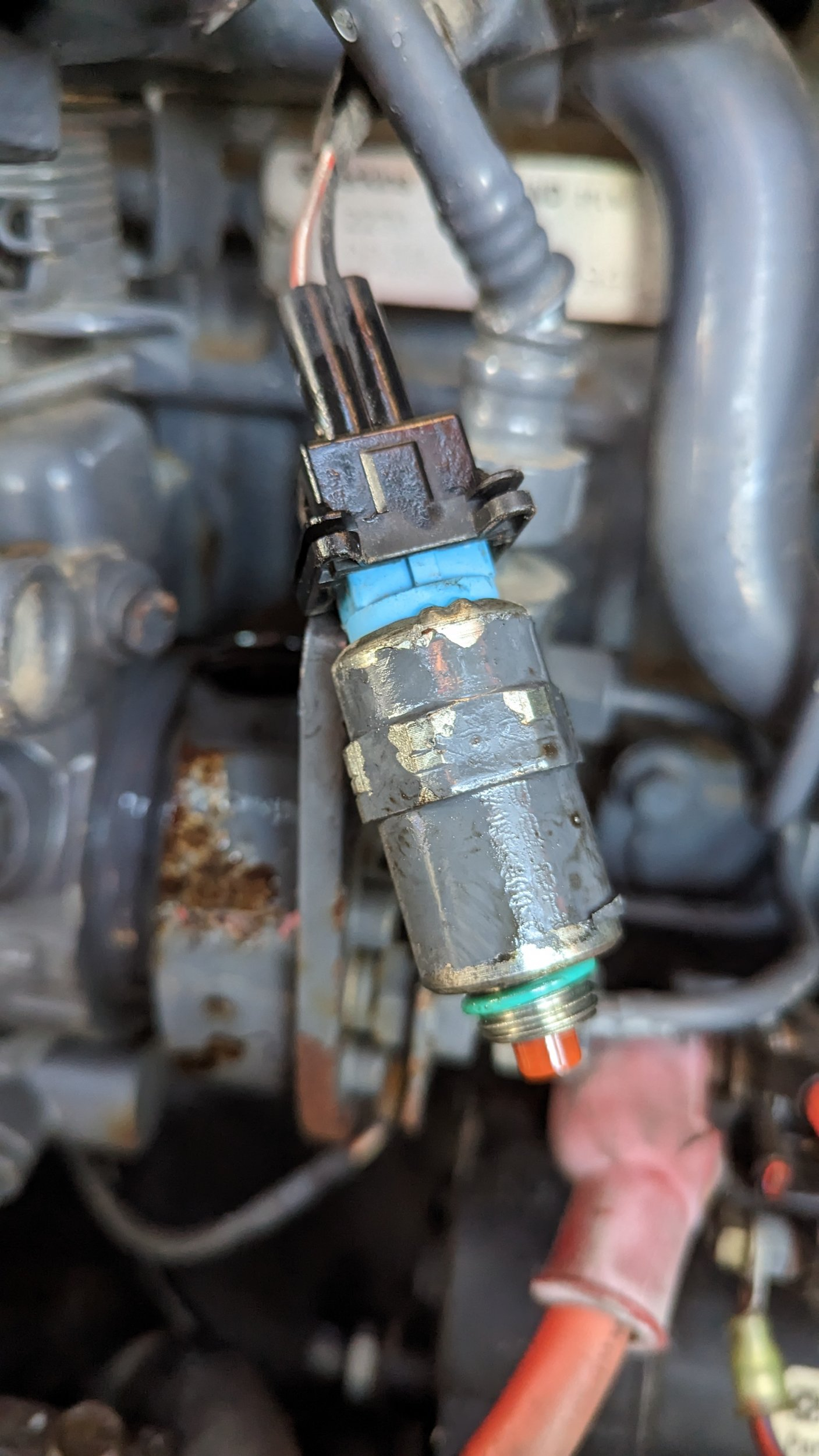

The tractor was been fine until this past weekend. It had not been started for a couple of months and would not fire up even though it would turn over strongly. It finally did start after I turned it over with the throttle on full. It ran normally for a few hours but when I shut it off to refill my sprayer it would once again not start, even with the throttle pinned. I got an assist from Mike "thepumpguysc" who clued me into the solenoid on the injector pump. It was pretty easy to remove the solenoid and after working the plunger manually a few times it was free again. After reinstalling the solenoid, the tractor fired up and ran normally again. Not sure if anyone else has had this problem but thought I would share in hopes that it will help someone down the road. Solenoid is labeled 3 in the drawing
