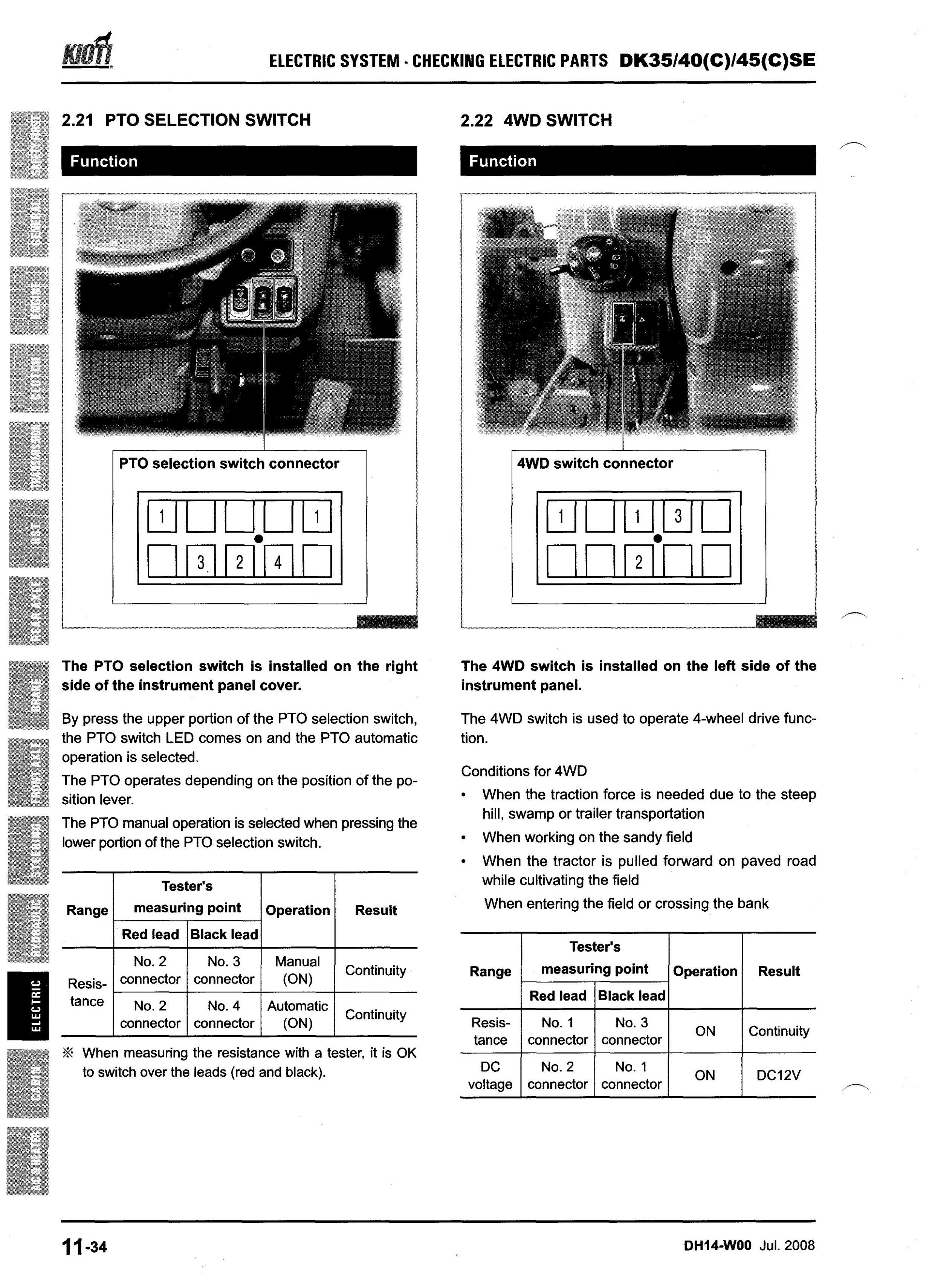

im looking thru the service manual
heres the info for the switch.
also, check fuse #4 . it supplies 4x4 and pto engage

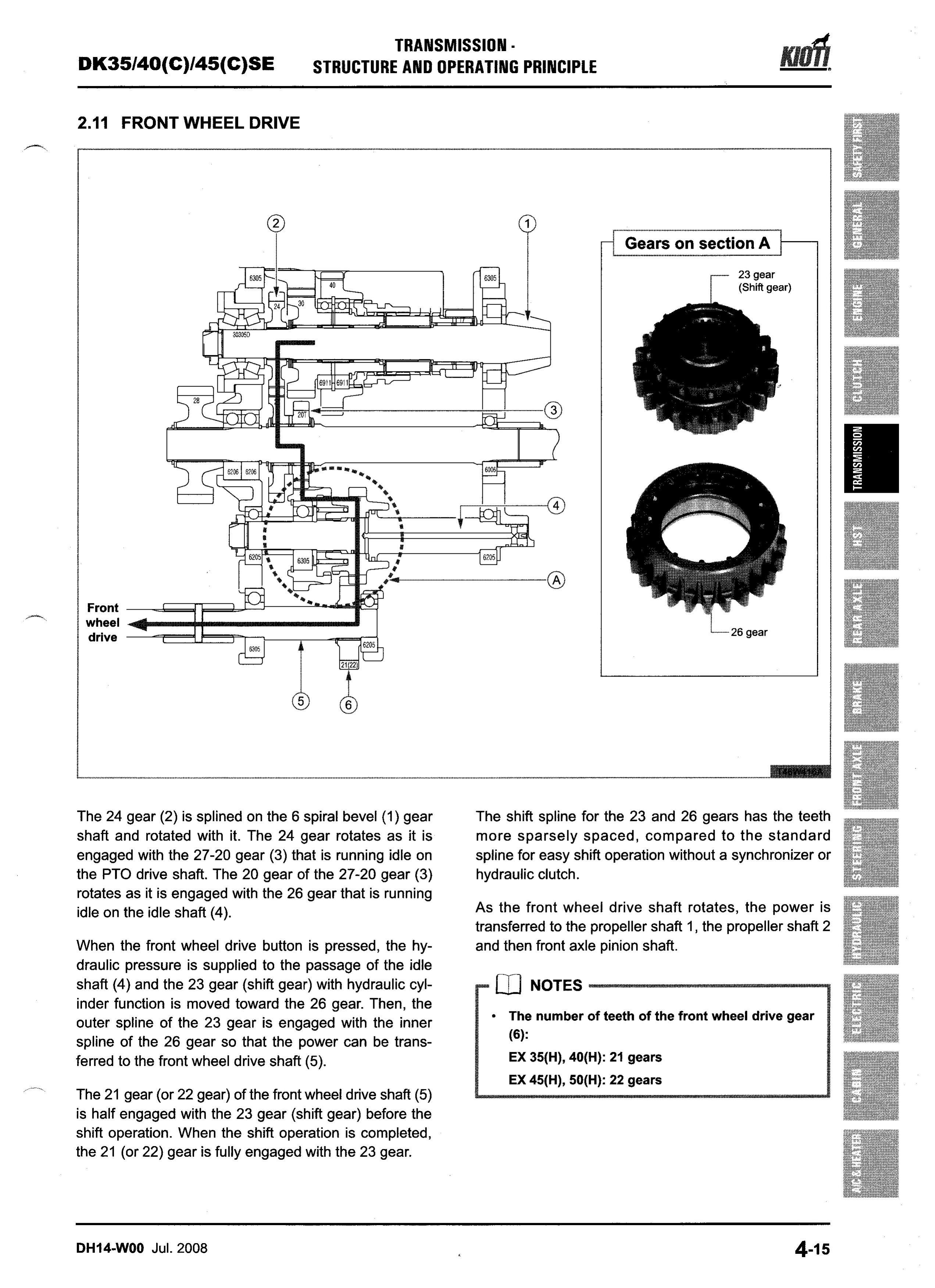

heres a blurb on the FWD system...for what its worth. again fuse seems like the likely thing
