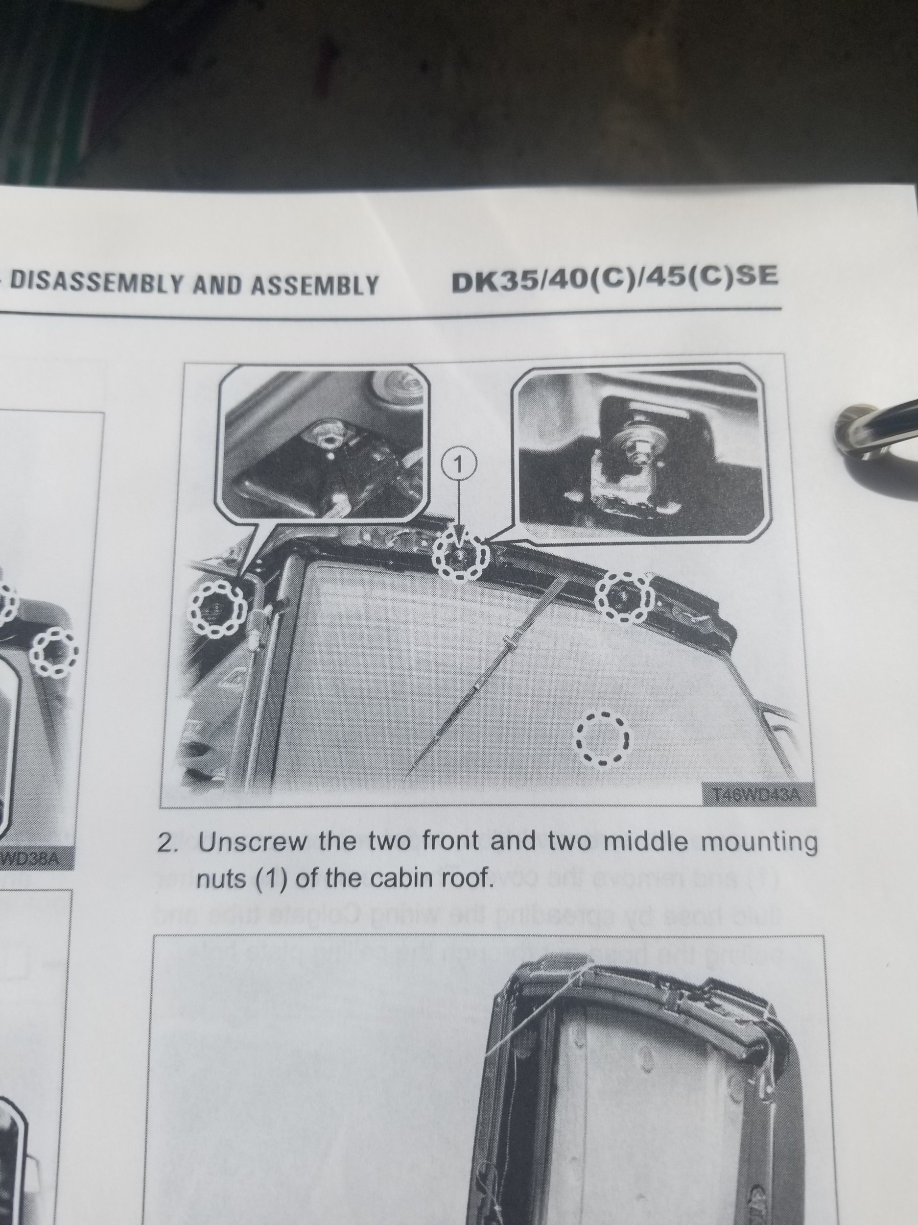

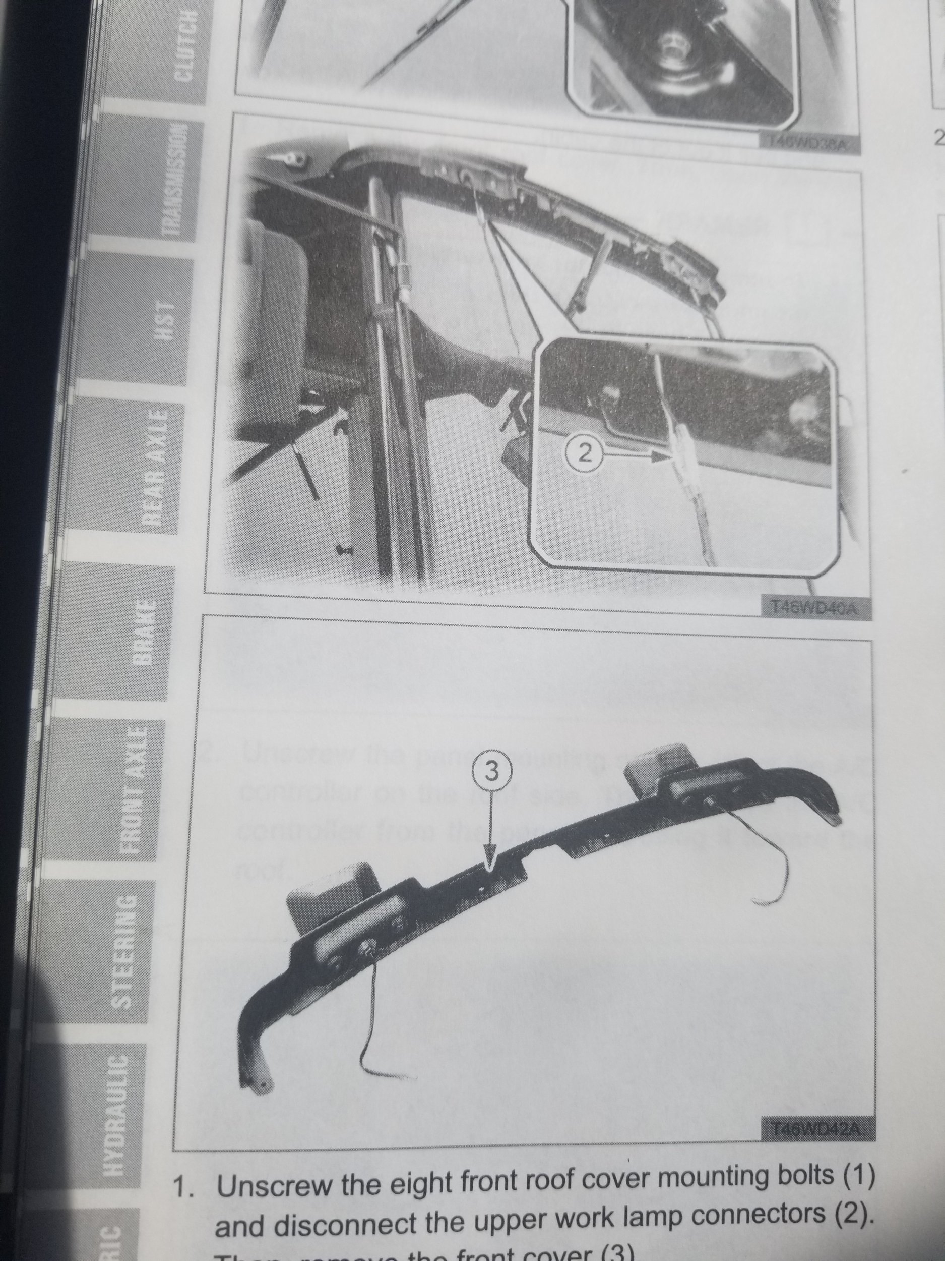

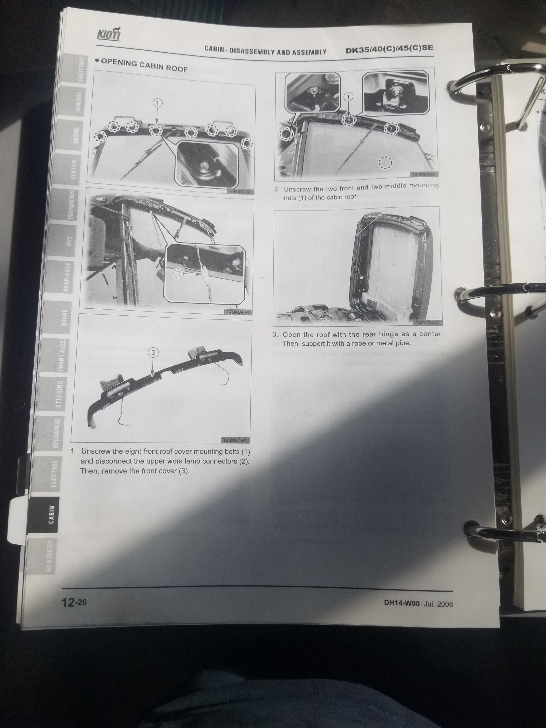

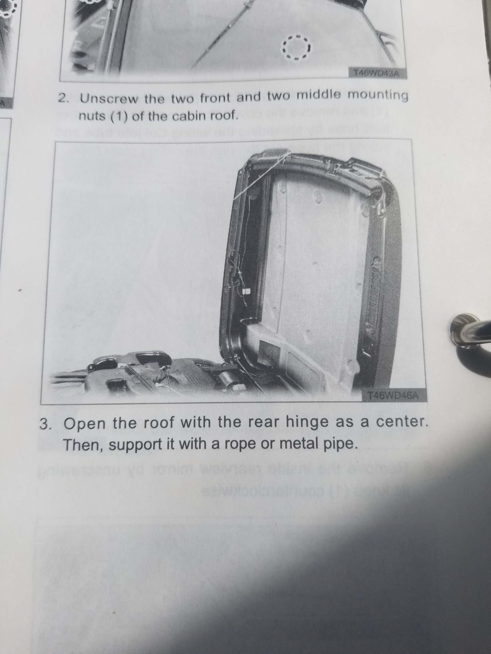

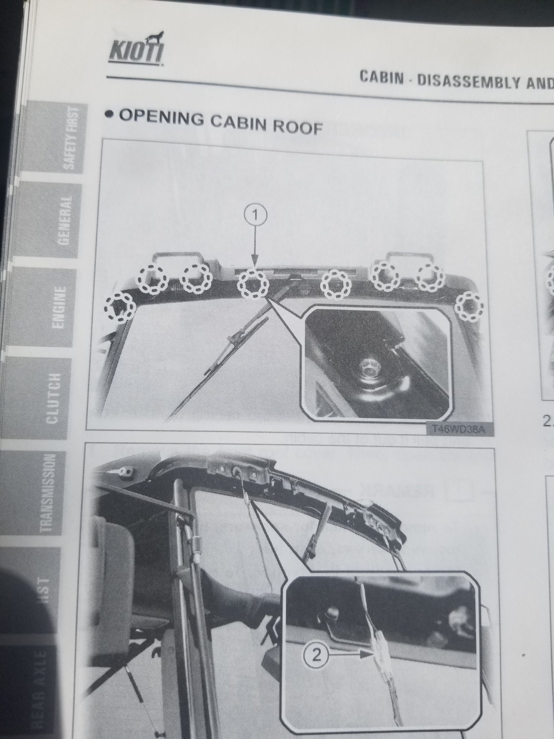

Before I just start removing bolts willynilly, what is the best way to get into the cab liner on a DK45SC? I've got some serious stink up there!
There is a youtube video of a guy removing the top of a NX cab. Is it the same on DK?

the dk cab has bolts up on top. the bolts have a rubber insert on them. i think there are 4 as far as i recall. be aware the front cab lights may interfere with lifting it up. it just hinges up.
/ DK45SC Cab Liner Mice! #3
This is for my 2010 DK45

grsthegreat! you're awesome! i believe mine is a 2006 so i'll check it out and report back.

turns out my model doesn't have a hinged top. there are 4 bolts (one at each cab light) that you need to remove and the cap lifts off (a wee bit awkward by myself).
there was a nest just under the cap (mostly just leaves, etc.) but the bigger mess was inside the heater/air conditioner unit. many screws and more clips later, i got it taken apart and began the cleanout. there was still a live "squatter" in there (kinda cute i must admit). i presume it left because i couldn't find it after retrieving the shopvac...

weird...ive had my cab top off several times, a few months ago to replace windshield .... at the same time i replaced radio antenna. not a stitch of junk up there from mice. and i have mice everywhere. i cant find any possible place for them to enter on my unit. very tight fitting.
and i love the hinge
i guess they've changed alot since your 2006 version.
