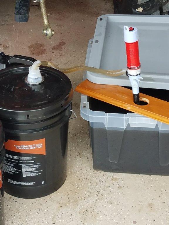

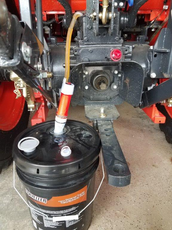

I just completed the 50 hour service on my DK4510 Manual Shuttle and thought I'd share a few thoughts for others that recently bought this tractor.
First off, the FEL frame and draw bar do not leave much room to get under the tractor, even on a creeper. It is tight but doable.
I bought a small, inexpensive battery operated pump from HF to transfer the Hydro/Trans oil with mixed results.
It worked okay but pumped much slower than advertised and shown on YouTube, probably due to viscosity.
See related TBN post here: Oil & Fuel - hyd. filter change
I used WIX filters purchased from local Kioti dealer: #51381 - Oil Filter, #WL10113 - Hydr Filter
Was originally going to reuse hydro fluid but didn't like the way it looked so I replaced with TSC Travellers 590901 Premium Universal Fluid

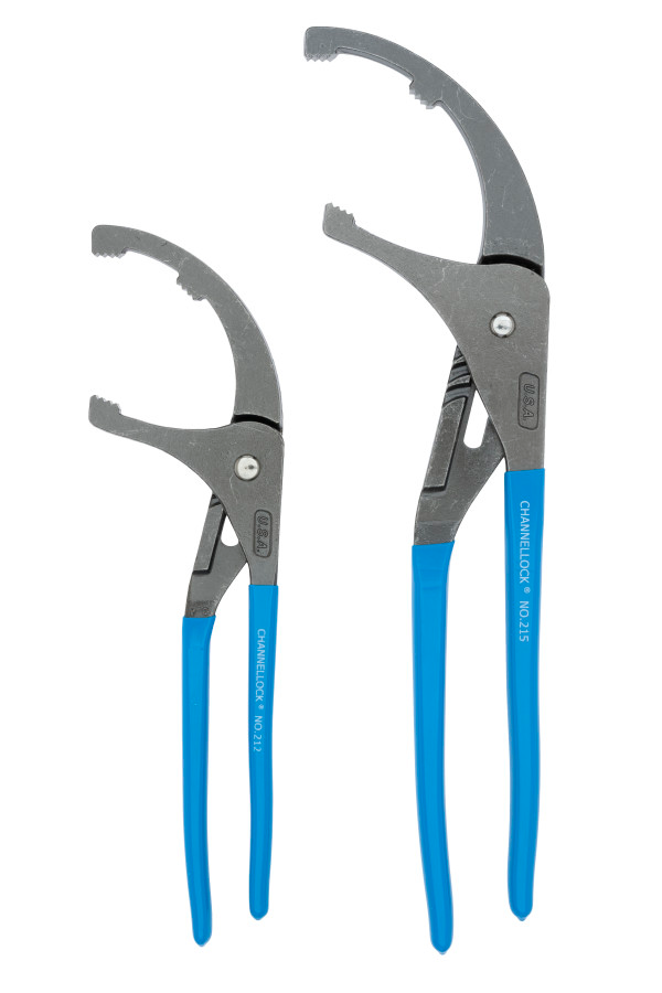

Oil drain plugs 17mm; oil filter wasn't as bad as I had expected. It was tight but easily loosened with a metal strap wrench.
Hydro drain plugs 30mm (or in my case 1-3/16"); tried metal strap wrench from TSC, it folded; tried rubber strap wrench from O'Reillys, it slipped.
Finally went with the Channel Lock 215 filter wrench that I already had but was afraid would crush the filter. Worked like a charm, did not mangle the filter.
I had considered the vacuum cleaner trick or some other way to reuse the oil, but it was worth $39.99 x2 plus the 2 gal pail of oil for peace of mind.
Overall, uneventful, few surprises. The manual says 1.95 gals oil capacity, 2 gals put it about half inch above full mark. (.05 gal is only ~ 6oz)
The oil fill cap is pretty cramped to get to. Figure next time I'll coordinate that with the fuel filter swap so there is more room.

Thanks for the writeup. Next time I do my transmission oil, I think I will just replace it all, and not mess with trying to switch filters quickly.

That pump sounds nice but I have a regular fuel tank for fueling the tractor. The little battery pump was just to see how it would work for hydro/trans fluid. It worked okay but was slow. I think it might be fine for deisel fuel or gasoline. The videos seemed to show that. This being my only tractor, I will not be changing out the hydro/trans fluid often enough to spend $130 on a pump, however when I bought the little D-cell pump I bought a different one as plan B, it is a 12v pump for under $50 that I will try next time. I figure a set of washing machine hoses with one end cut off ought to work similar to how I used the battery operated one.
