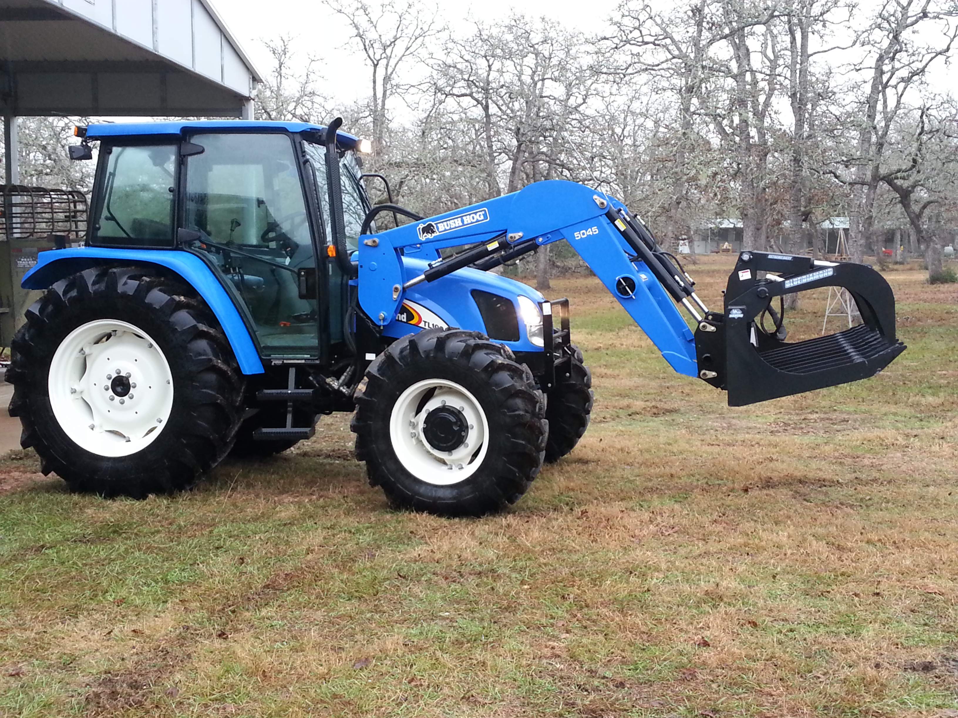

Just wondering if I can flip the hubs or swap sides with the front tires to get a wider stance! It feels very tippy when in off camber situations especially with the loader on.

Looks like standard front wheels are welded.
DK45SE HST Utility Tractor | Kioti Tractors
To reverse the wheel rim with the wheel hub you need front wheels as below.

Here are pictures of the rim and pictures of the swapped sides look.
/ DK45 Widen the stance ? #6
That's as wide as she'll go. Just remember that you've created a longer lever by doing so.

It's been discussed before, but doesn't widening the front help stabilize the tractor more ONLY IF you're in a situation where you've maxed out the pivot capacity of the front axle? Otherwise it doesn't do much?
That is correct. The stability of a tractor is primarily determined by the rear tires.
Wider fronts will spread the contact patch on the ground and make dropping a front tire in a shallow hole less noticeable.
But as to keeping the tractor from tipping over sideways, by the time a rear tire lifts to the point the front axle oscillation has hit the stop you will already be heading toward disaster. Been there many times, not pretty, makes you drop your FEL load very quickly!!!
Spend your time and energy stabilizing the rear wheels and let the front do it's job of oscillation.

It only contributes to more stability when the front axle has oscillated to the stopper.
As to stress on the front axle assembly. My M9540 shows the widest recommended setting with the cupped center still turned in. Any setting wider than that is warned against as having too much stress on the axle assembly. I've attached a pic with mine set to the widest recommended setting.

Again, the trike tractor versus wide front tractor, everything else equal, have the same tipping tendancies until the wide front oscillates to the stopper. Then the equation changes favoring the wide front. Before that it doesn't matter if the wide front tractor has it's front tires twenty feet apart. The weight of the tractor is balancing on the axle pivot.
Actually,,,, when I think about it,,,,, the trike tractor actually has an initial advantage because it's never pivoting on a small axle bushing. It's at a minimum pivoting on the two front tires which are 18" or so apart. But that advantage might be lost by the pivoting point being at the ground versus 18" high (depending on tractor size).
