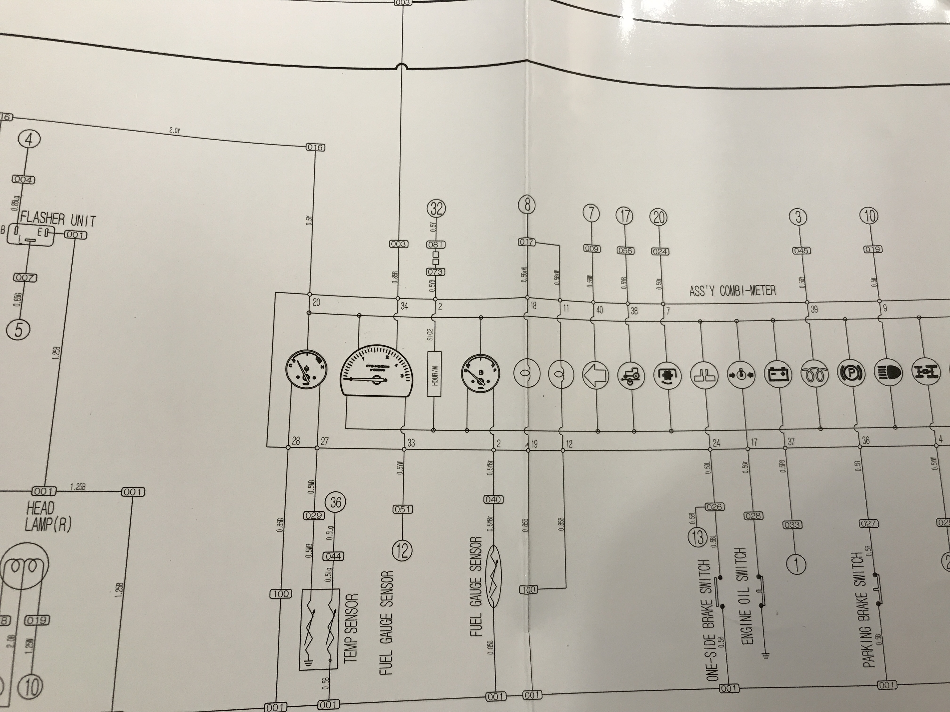

I have a 2010 Bobcat CT450 (which is simply a rebadged Kioti DK45) and the fuel gauge has been reading very inconsistently over the past couple of years. Suddenly it decided to quit working altogether.
I will of course check the fuse but in reality, the sending unit probably needs to be replaced too.
I am trying to find the appropriate sending unit without going to the Bobcat dealer and getting raped.
I believe my tractor equates to the Kioti DK45 or DK50 which Bobcat simply rebadged.
Can anyone provide advice on finding the correct unit for my tractor?

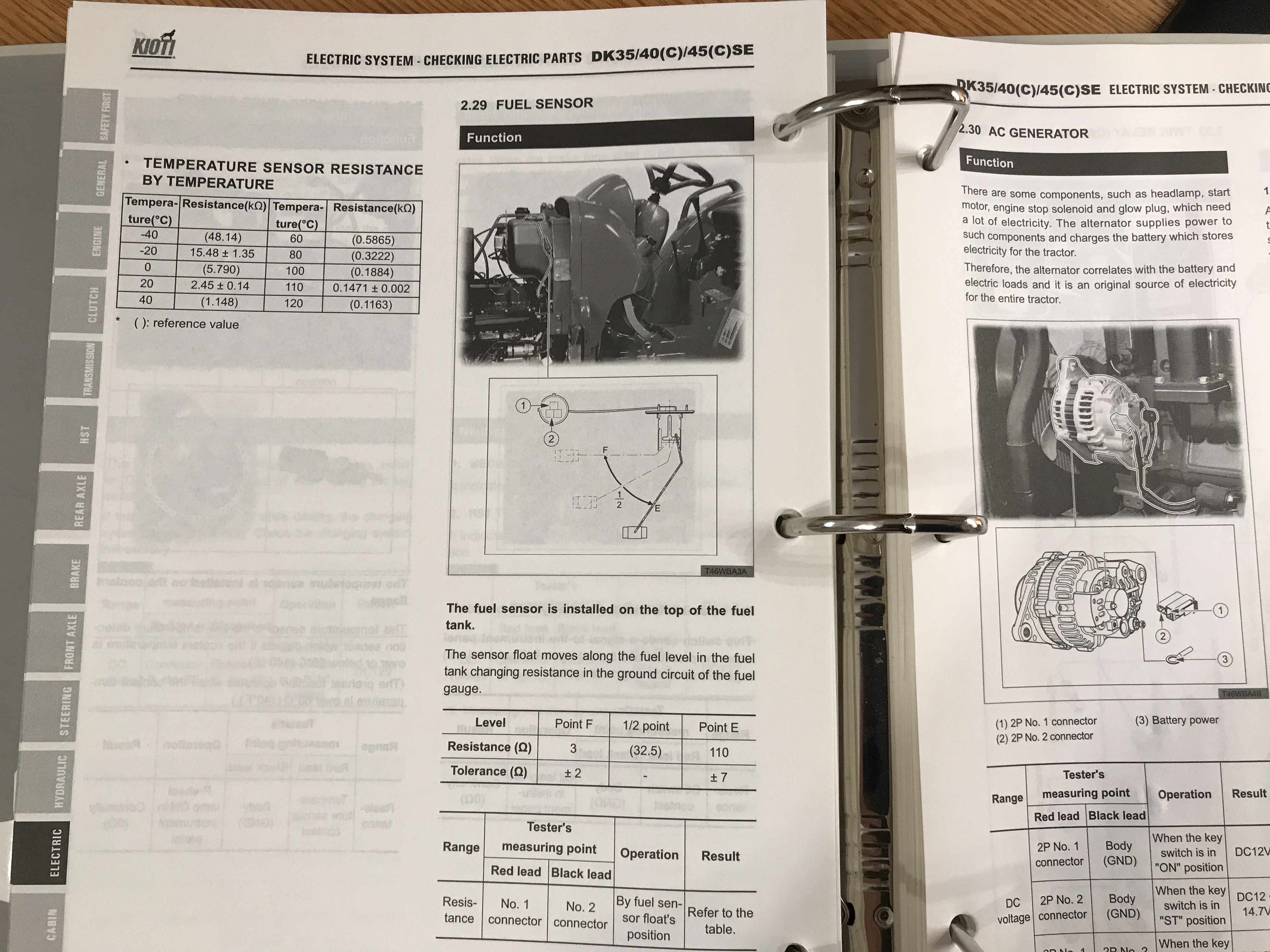

Your tractor is a "re-badged" KIOTI DK45SE. The DK45 is an older model KIOTI and would not be the same as your Bobcat.
/ DK45 fuel gauge sending unit #3
I have a dhop manual for the DK45SE, Let me see what i can find
Thanks for that. Will prove useful.

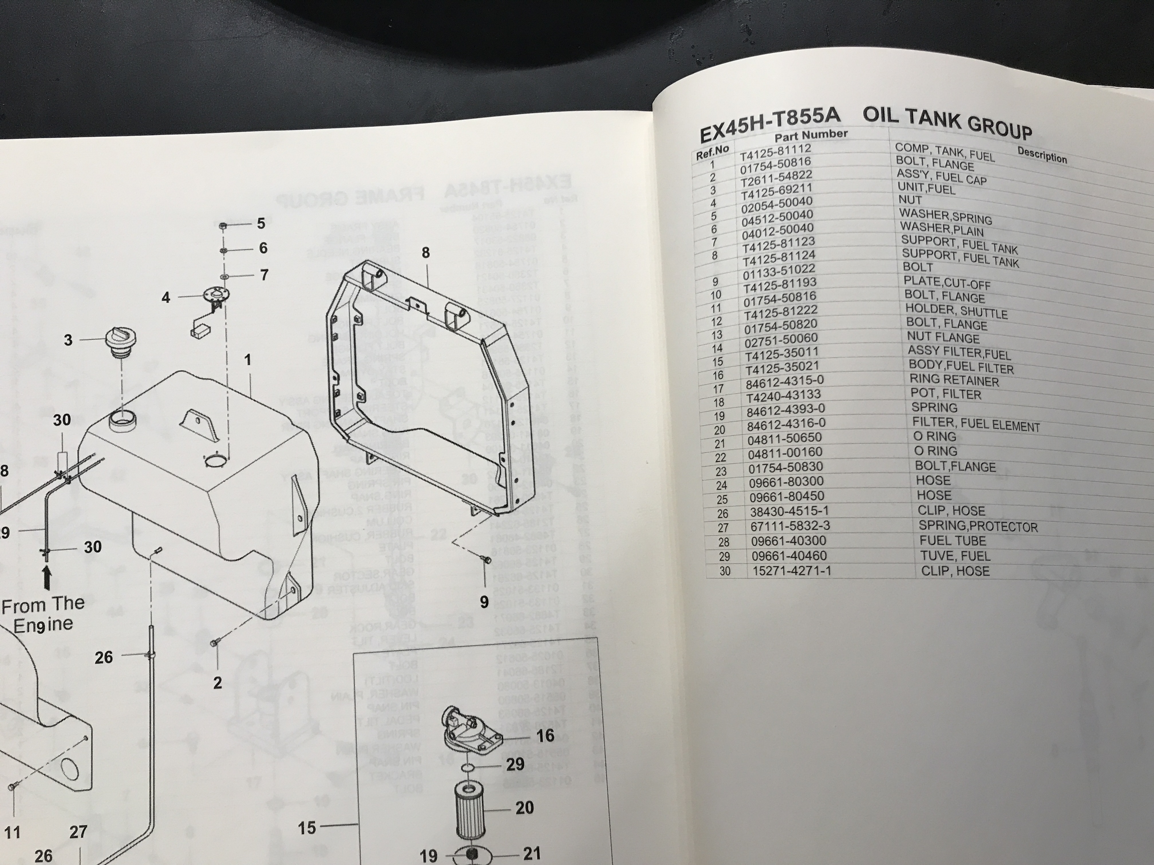

There are 3 different versions of the DK45 The original DK45 has a metal hood and fenders. Then next came the DK45S sometimes referred to as the DK451 which has fiberglass hood and fenders and a 15.3 gallon fuel tank. Then the latest version was the DK45SE which has the 11.9 gallon fuel tank.
/ DK45 fuel gauge sending unit #10
Cant tell if this is the exact part you need, but this is whats listed for the DK45SE
/ DK45 fuel gauge sending unit #11
Michiganiron has them for about $100
Thanks. My Bobcat has the 11.9 gallon tank so that pretty much confirms it equates to the DK45SE.
Thanks a bunch. I think you found what I was looking for.

All, Thanks for the inputs.
The original parts manual calls for Kioti part T4125-69211 which apparently is no longer available. Talking to the good folks at Michigan Iron, the nice lady did some research and found a listing for a replacement part "TE15-0082B" which although not identical, did actually work well as a fix. My thanks to all the especially, Michigan Iron.
