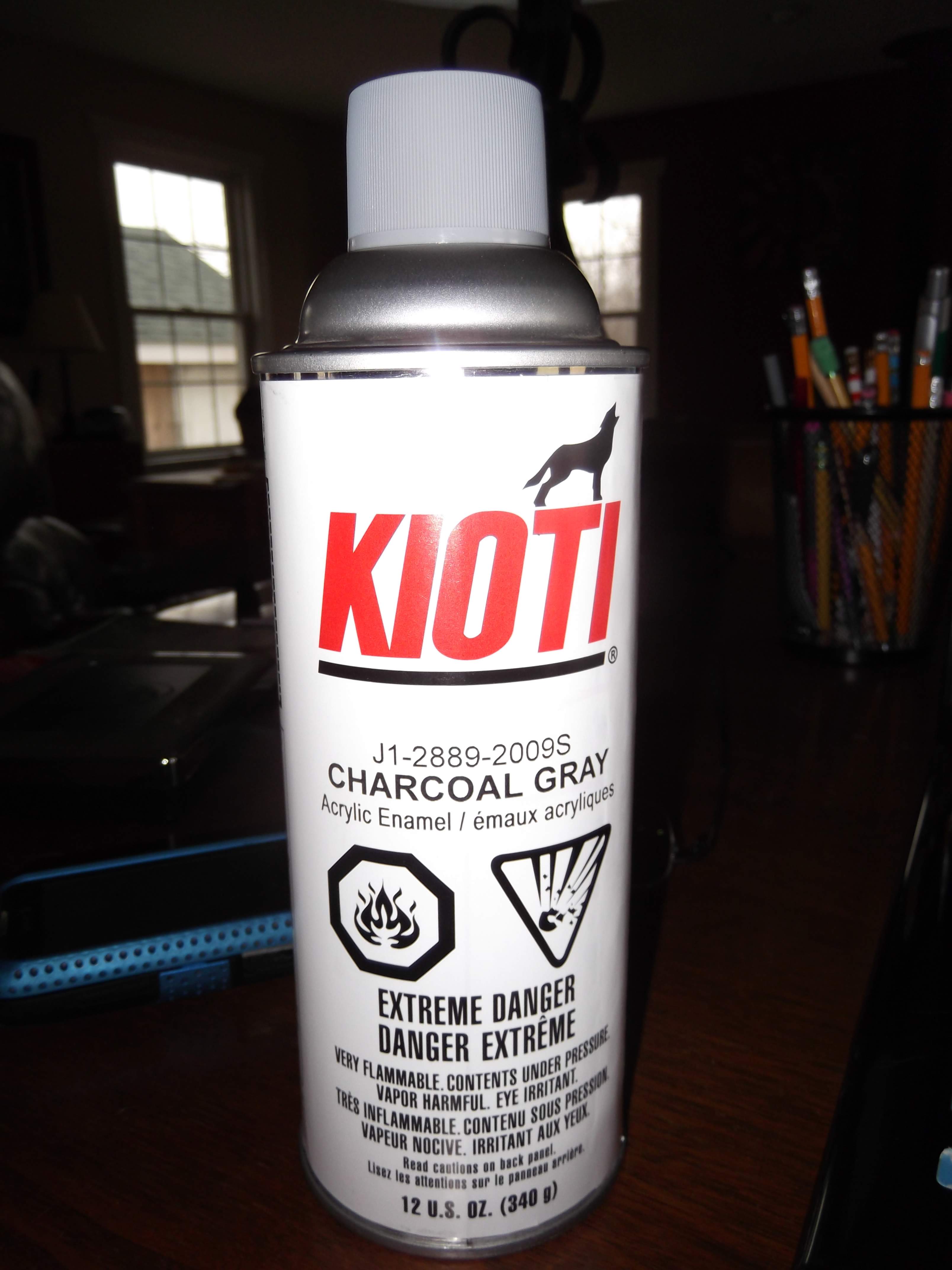

I meant the technician using the wrong tool on the coupler adjustment. I can't imagine not having a 10 mm wrench...it is such a common size. Of course I'm the guy who applies touch-up paint to the charcoal gray on the bottom of his tractor. Funny, all my vehicles are kept outside while my tractor resides in a cozy shed. My wife just smiles at my silliness...
/ Dk40 hst creeping backwards #15
What brand/color are you using for touch up on the frame's charcoal grey? Kioti, or something else that matches?
/ Dk40 hst creeping backwards #16
I use Kioti paint from my dealer. It runs about 13 bucks for a 12 ounce rattle can. I dislike the price, but want a matching paint. Note the color of the cap does not match the paint.
