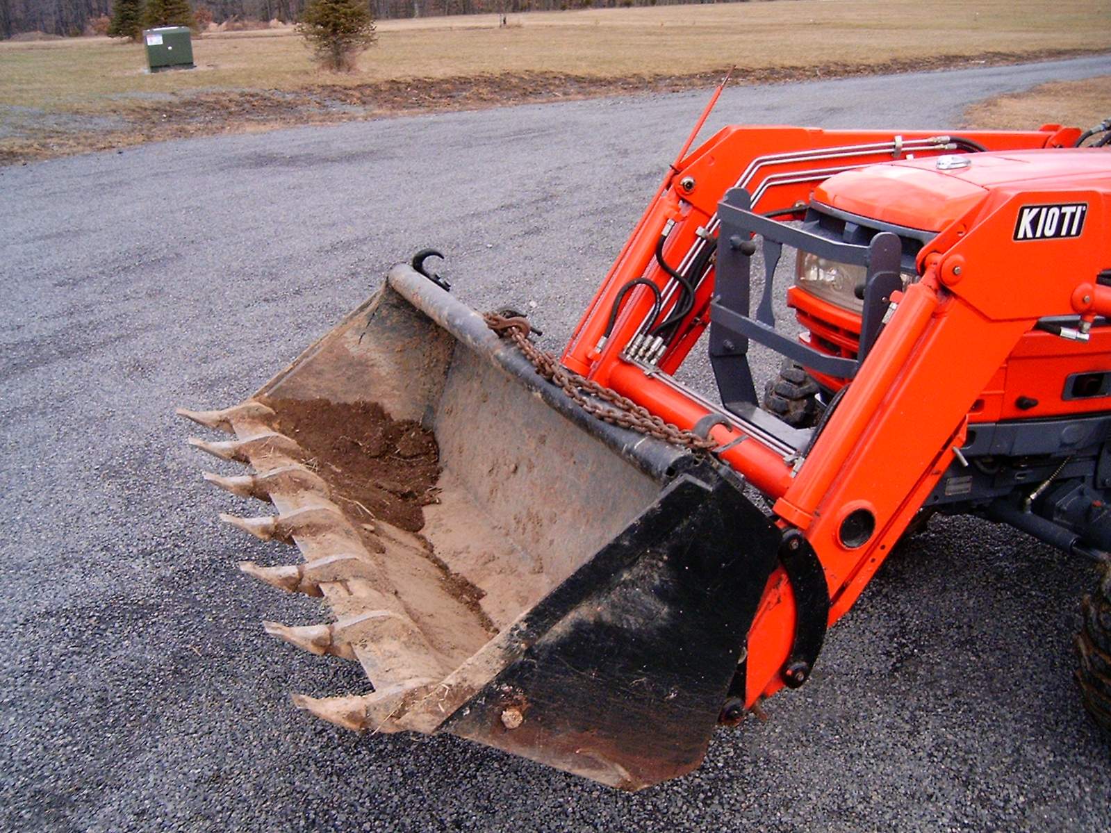

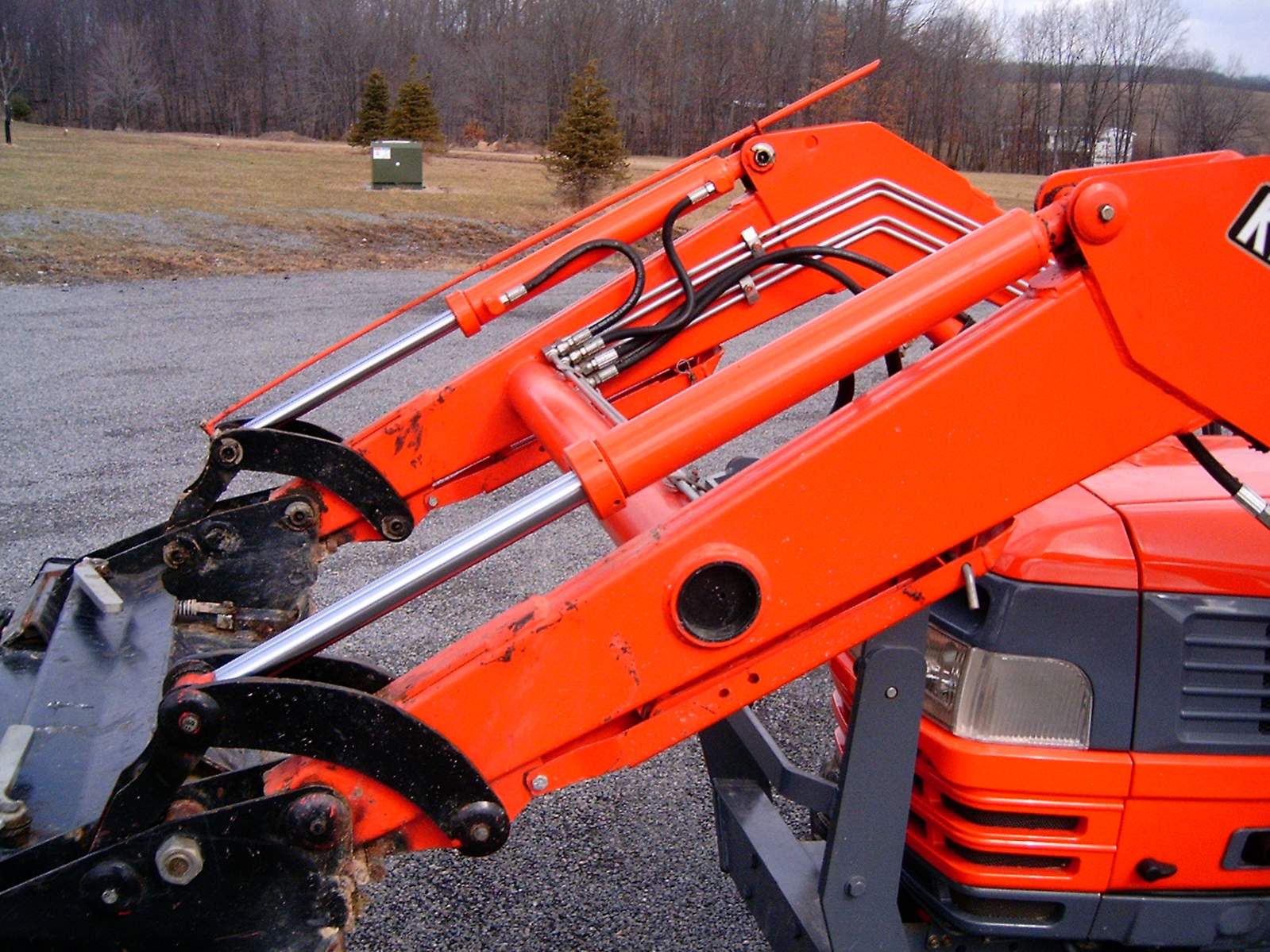

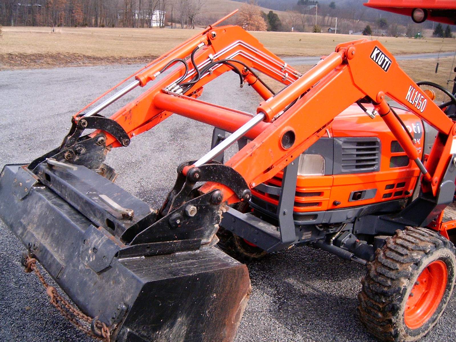

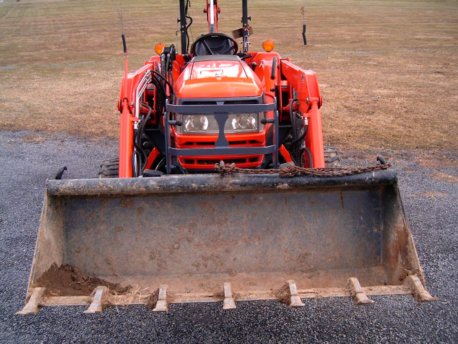

The hydraulics are much weaker than they should be. I know the front loader on these machines are a joke to begin with...
The KL1450 loaders came with very weak roll back power. I've complained about that in the past.
I did a lot of changes to my loader and it is a lot stronger.
Kioti calls for 2300 PSI max pressure. I have mine turned up to just under 2450 PSI, been running it that way for years.
The bucket roll back power was pathetic.
The bucket pins were only 5" apart, I redrilled and moved mine to 8" apart. I also replaced the stock 1.75" roll back cylinders with 2" hydraulic cylinders.
I then had to make new bucket linkage so the larger diameter cylinders wouldn't hit the loader arms in the rollback position.
Took a lot of time,work/trial and error but I think I doubled the bucket roll back power.
My loader works a whole lot better that it did from the factory.

I'd love more info on how you did your upgrades. Doing a cylinder swap doesn't sound too hard but relocating the mounting holes seems a bit more difficult.
/ DK35 hydraulic pump #13
You could try going with just the larger cylinders first to see if you feel you need to relocate the bucket mounting holes.
I got my cylinders from Surplus Center for around $80 each. Can't remember the item #.
I did have to cut the top crosstube off the cylinders that I used, Weld on a 1 1/2" extension, then weld the crosstube back on.
You might be able to find cylinders that fit without needing modified.
