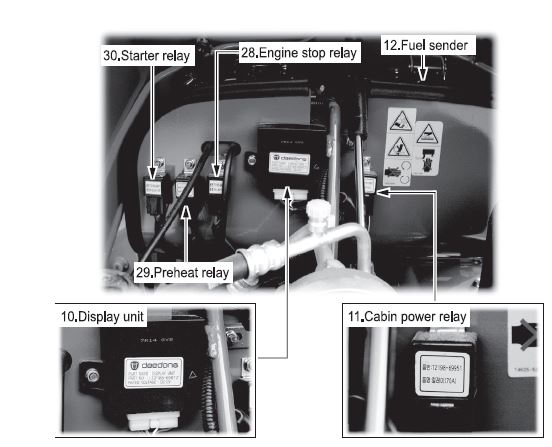

So I need to find out if the glow plugs are working. I have new relays now for what its worth. The preheat controller is still the original one on the tractor.

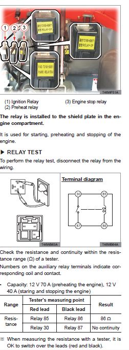

While I have my hands in the tractor is there a way to test the preheat controller while is is disconnected? Its another part that's easy to access figured why not test it as well you know?

In a word no. It is a complex circuit and a special jig would have to be fabricated to substitute for the tractor and all of its connections.. No doubt there is one in Korea...

Well got out to the tractor this weekend with nothing more than a multimeter. Battery is still reading great voltage!
I got a reading on the glow plugs of many readings ranging from 8-10 volts. Not stable to say the least. But the most common was 10.80v
At least current is getting to them and the replaced relays are functioning properly.
