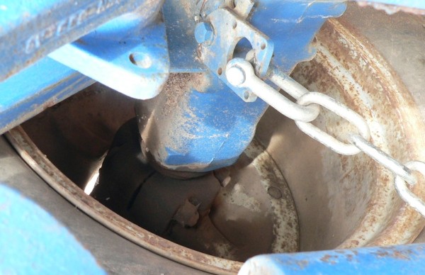

What I would try first is loosen the hub clamps and slide the wheel out 2 inches. They look long enough and strong enough to work that way.
That looks like a bad idea to me. The hub clamps are out at the end of the axle against what looks like snap rings. 2" more would be an unfair load and might come off or break. Look at the hub picture in post 13.
Looks like he'll have to swap sides or make spacers.

This is the picture of the hub that looks like it would be long enough to remove the snap ring and slide it out a little. Hard to tell from this angle, would need to measure the length of the hub.

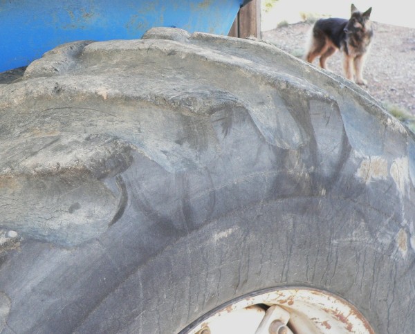

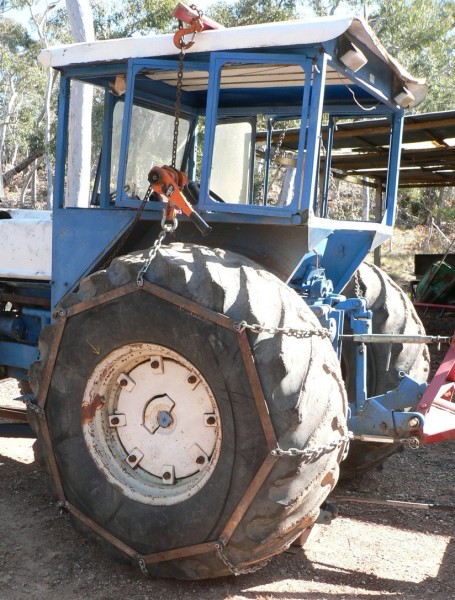

All fixed - what a swine of a job (no adverse comment on pigs)
As noted earlier, the second wheel turned out to be full of water and I was kidding myself expecting 300 Kg - it was double that and actually BENT the jib just lifting the wheel (not the tractor). Fortunately a neighbour had another heavier jib so with many changes of sling positions, much backing and sheer grunt, three of us finally managed to lift, swing and relocate the wheel onto the hub. One of the biggest hassles was getting the locking tab on the wheel lined up with the matching slot on the hub.
The chains are now on - both lateral and around the circumference - I might add more if needed
