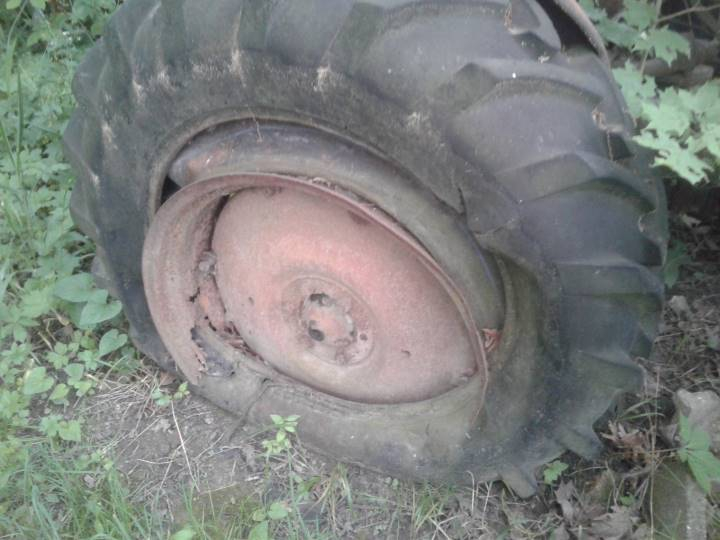

CaCl was the OLD way of tire ballast. Should it leak, the place where the leak happens will not grow grass there for nearly a decade.

It may not be an issue, for your circumstances, but needs to be thought through. Just as the choice of fluid needs to be thought through. CaCl would be a no go in my opinion. It is very hard on the environment when (not If) a tire is damaged as well as very hard on any iron based metal it contacts. Most rusted out rims you will find are due to CaCl.
