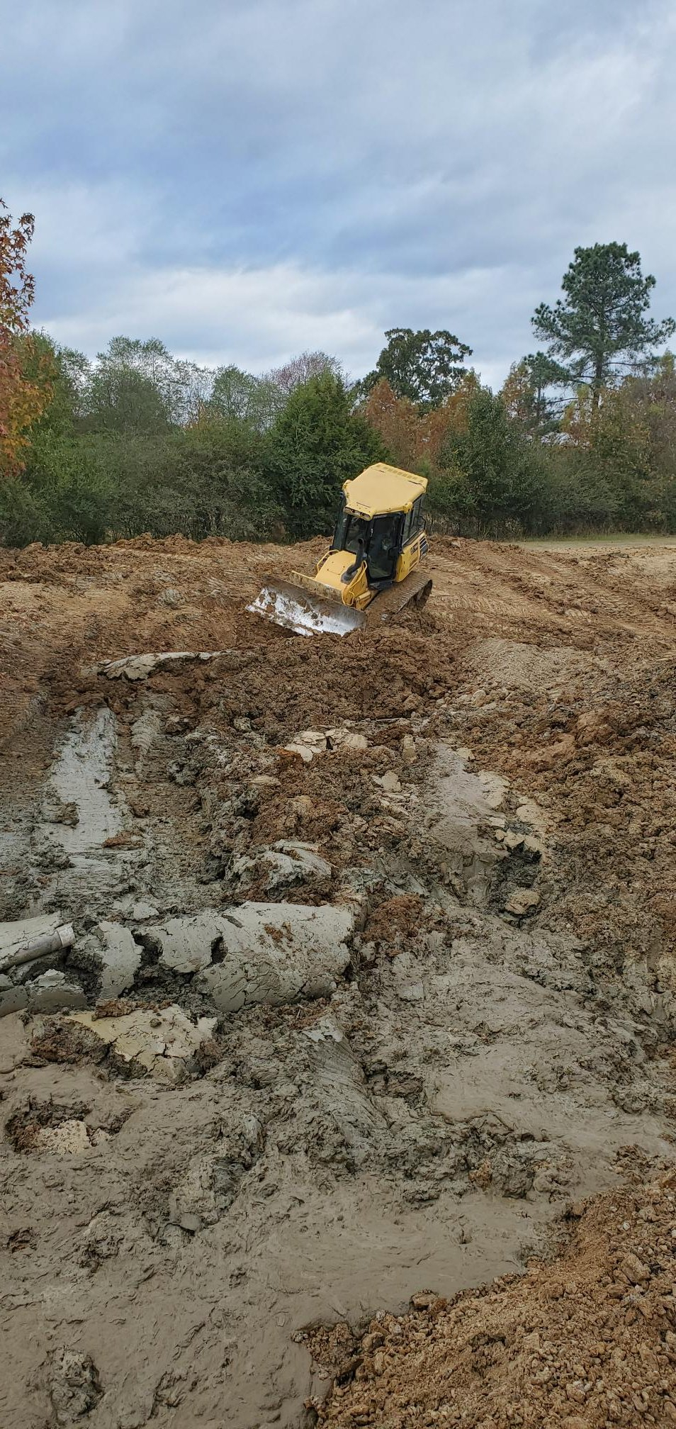

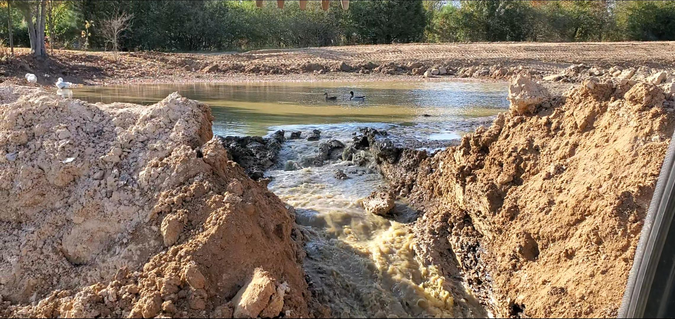

It's already getting a little water. The area closest is about mid-thigh now. According to the laser I should have about 5-8 feet of depth depending on where in the pond. Shallower than I hoped but as you can see by all the water, I only had so many dry days and had to beat the rain. Hopefully I'll be able to get a few drone shots this coming weekend.

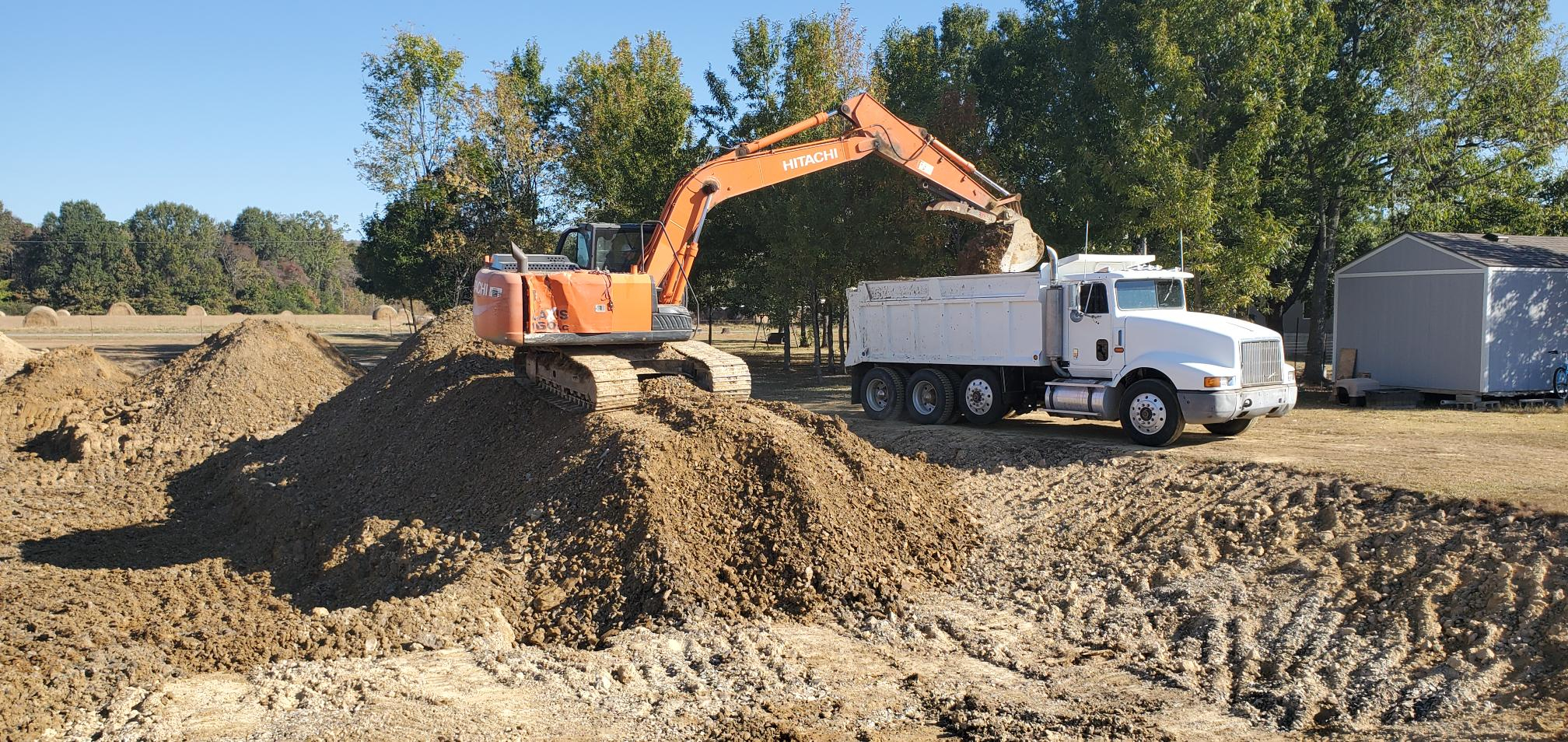

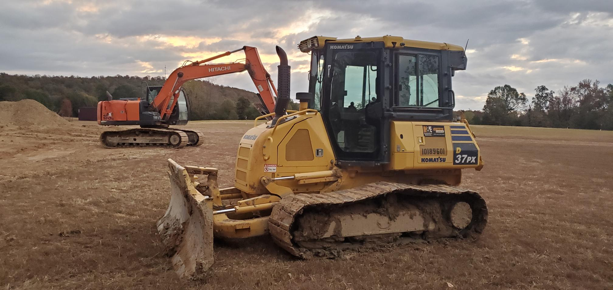

I didn't hang on to receipts but I would guess I spent in the neighborhood of $7,000. The track hoe used probably 5 gal an hour plus or minus a bit. Dozer was considerably less and was used for less time. The equipment did not cost me anything, but to rent it looked like it would have cost about $2,000+ per week each. Probably could have done it in 2 weeks easy with the proper planning. The dump trucks were the expensive part and I could get around 35 loads per day per truck depending on whether it was just loading or digging and loading.
I had one full day that I was paying $2.58 per min plus fuel. I was a nervous wreck that day.

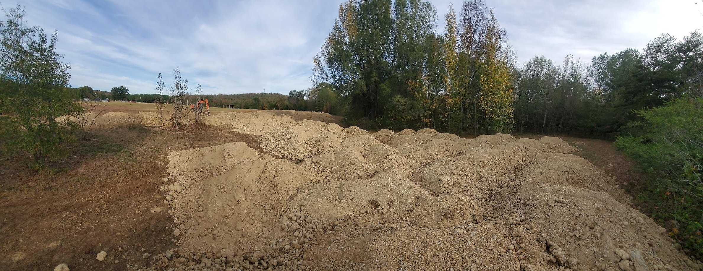

Here is a view from up above of my whole place. Looks a lot smaller from up high.
This is the smoothed out piles of dirt that came out of the pond. It's smoother than it looks. The different color in the middle is the shale that is still piled up for the house build. We are going to put the house right in the middle of the property.
