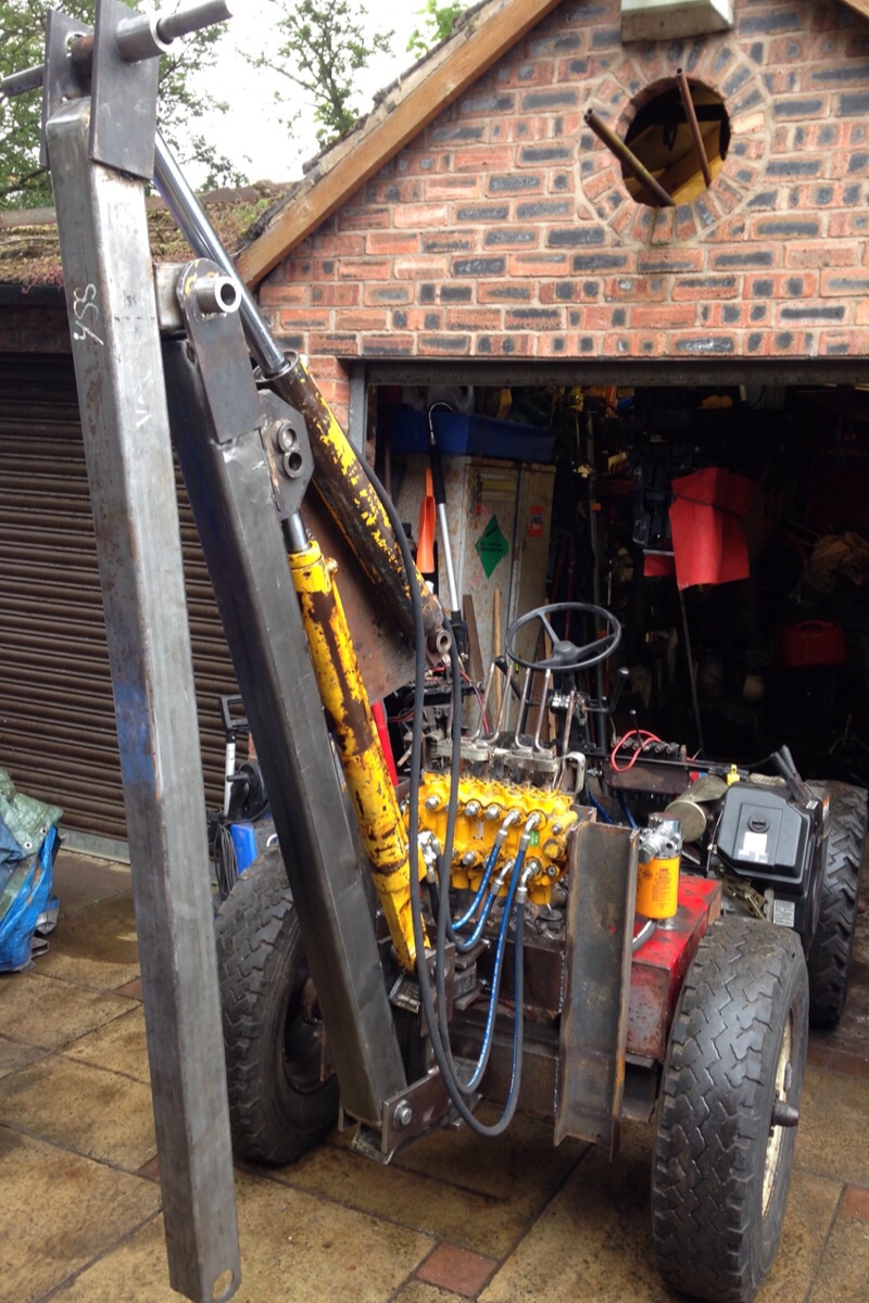

Exploring the limits....

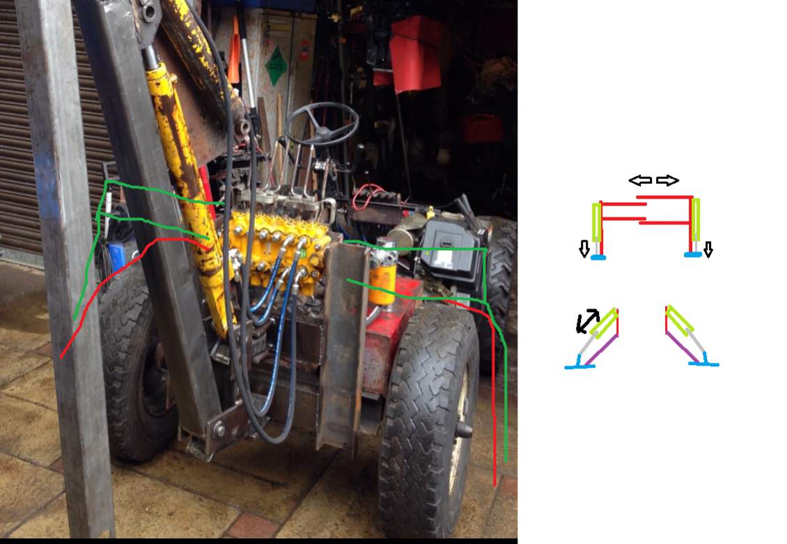

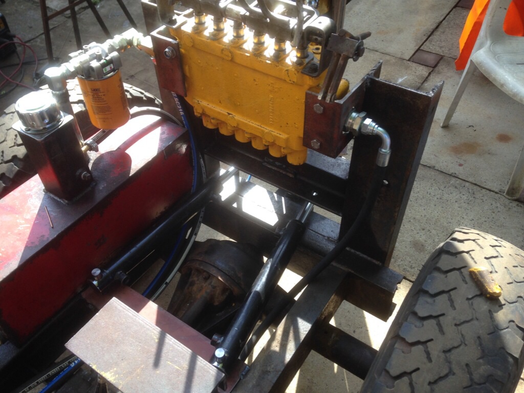

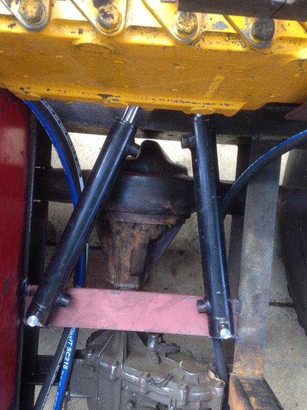

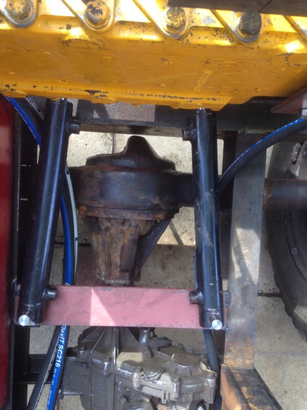

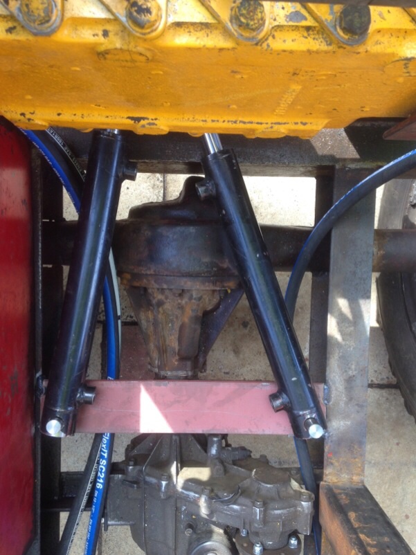

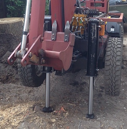

Unfortunately I didnt plan the layout very well and ran out of room by the time I got to thinking about the outriggers. The leg rams sit within the two vertical channels and really should have been spaced as wide as the wheels but it would be a major job to start again. So the plan is now to have horizontal extending legs each side mounted on pivots behind the rear differential and spanning out diagonal as wide as the wheels with the rams bearing down on them at mid point. The rams move in a fixed plane up and down so the legs will have to extend (telescope) between the fixed pivot end and the ram mounting point. That is a job for the summer when I strip it down for fettling & paint.
Here is a photo of what it looks like at the moment, the rams are over kill but I picked them up cheap!
outstanding work and build,:thumbsup:

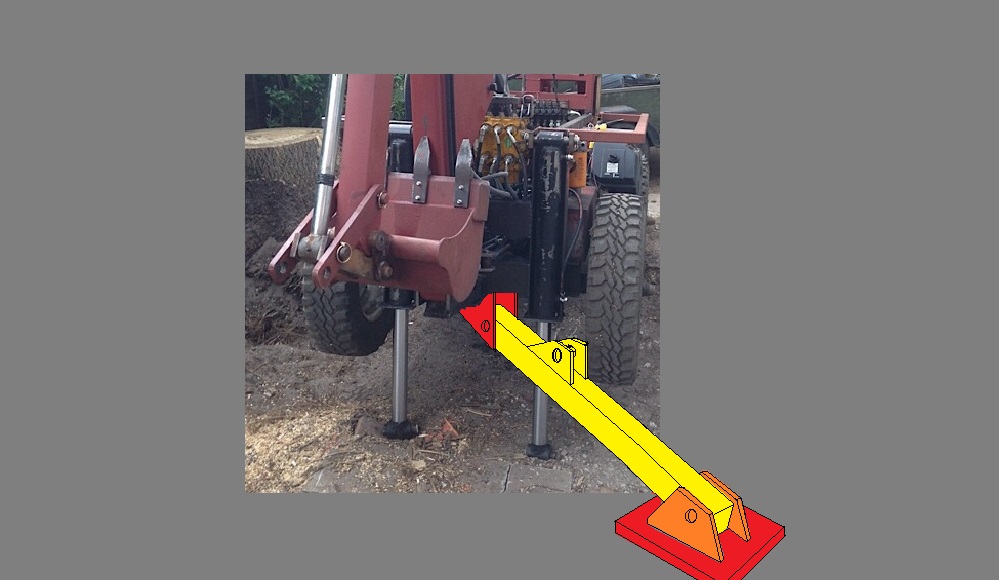

here is a idea for the outriggers , hope it makes sense lol
its way out of scale to your pic lol,

Great work Colcreate. When you built rear bucket assembly you could have contacted me, I would be happy to help with geometry to achieve full 180 deg movement of the bucket without guessing the distances. For the outriggers I believe the folding type would give you great stability and compact design. Something like Huddig uses..

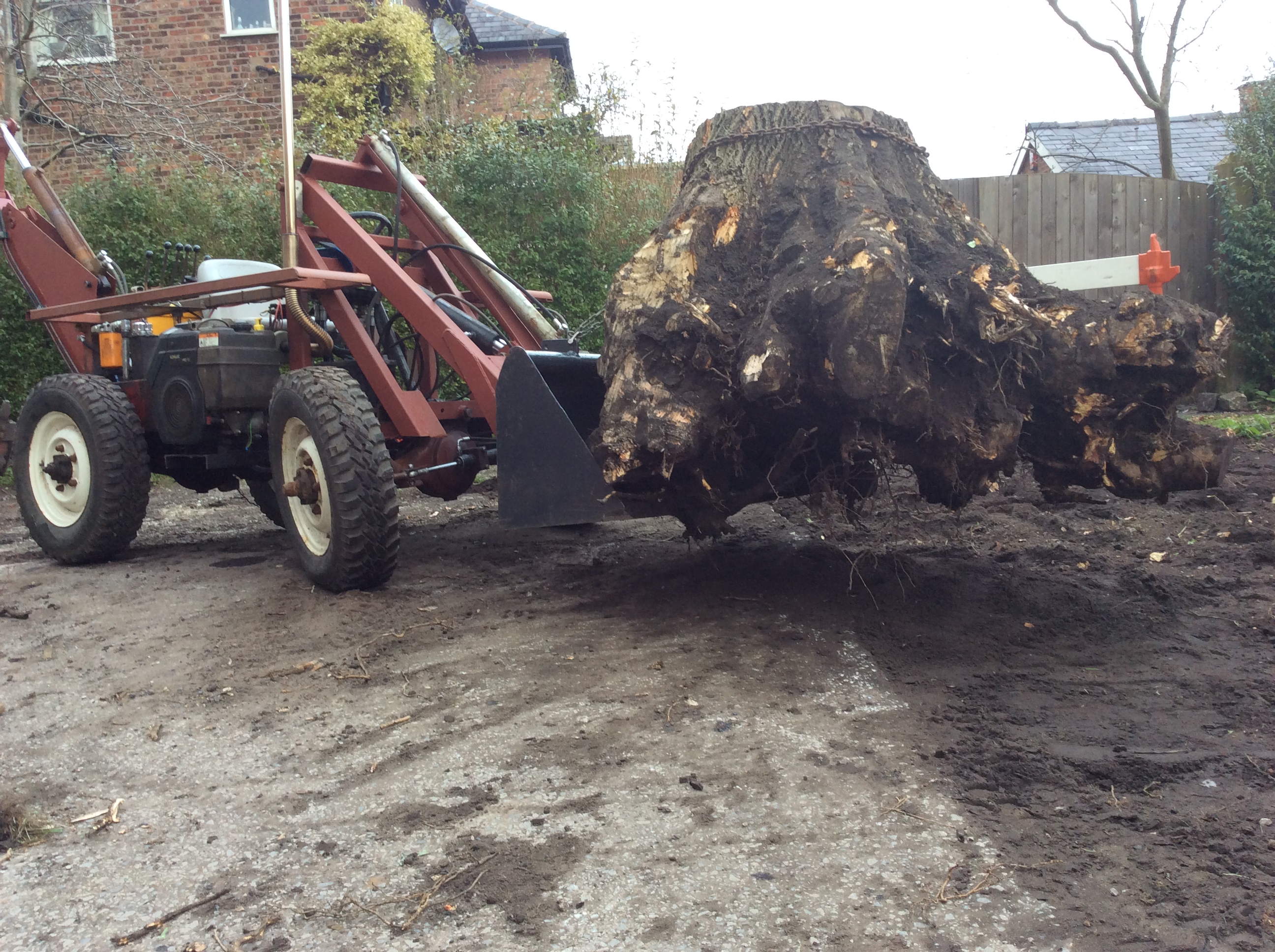

The hydraulic motor is a 160cm3/rev and the overall gear reduction at the wheels is something like 12:1 in Low and 6:1 in high which in theory gives speeds of 3mph and 6mph. I have moved my 18ft boat trailer and also a tipper trailer with 1ton load around with ease over rough ground. The toughest task though is driving the front loader bucket into piles of dirt so low ratio only as it does struggle.
The tree stump shown in a earlier post weighed 880kg which was a ridiculous overload but it still managed to move it!
