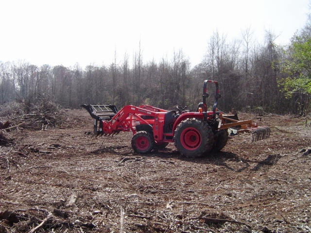

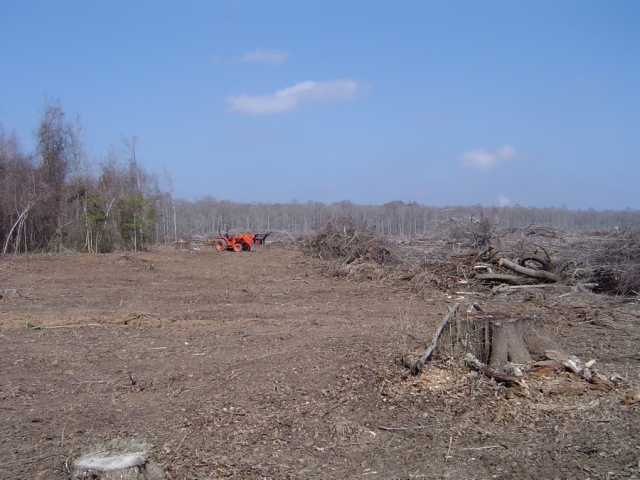

Iron Horse! What did that cost to the land owmer on the 6 acres?? Looks great!
/ DIY Land Clearing #42
$5,500 inc 10% tax , he said it was the cheapest land he's ever bought .
Redbug , thank you for your comment . I allways used to think of it as work , but I am being more positive now , like yourself and am taking the effort to enjoy the task now .
