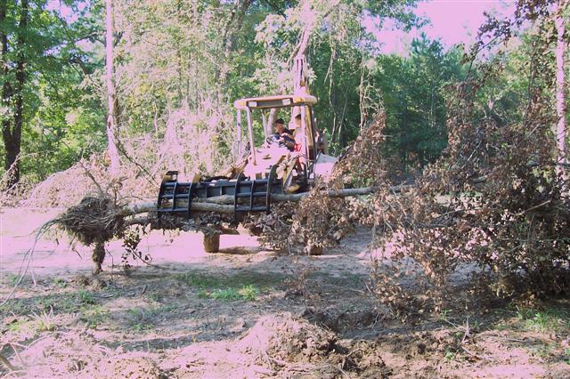

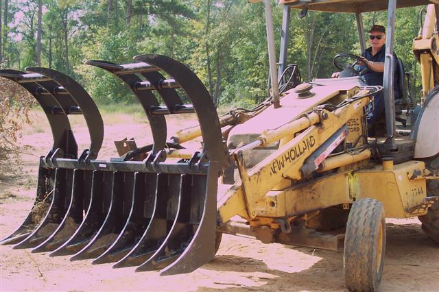

With a "C" shaped root rake/grapple you should be able to move 3" stuff by the roots.

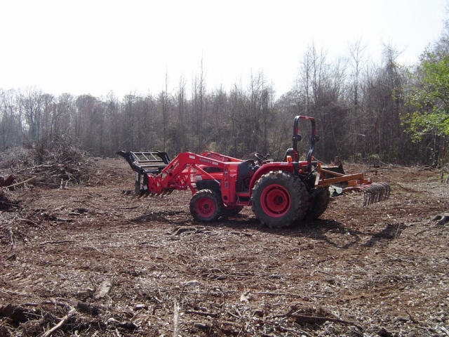

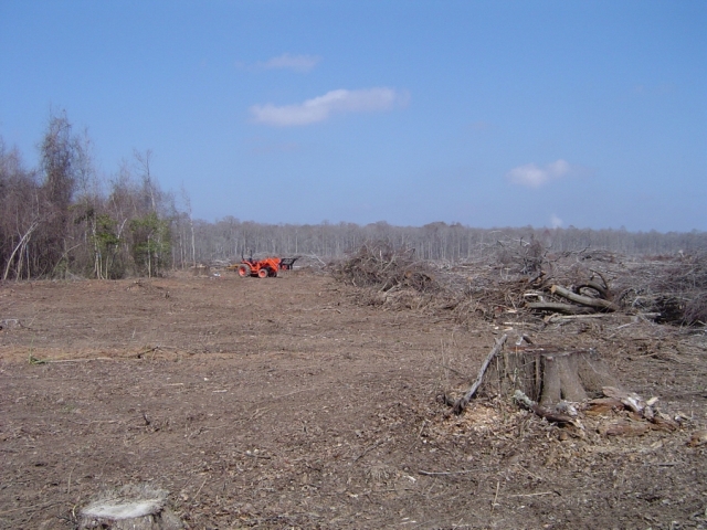

Boy, those are some pretty woods you have there Iron. Some huge trees. Wonderful country! When was it last logged...100 years ago?
A couple pics of my grapple...
