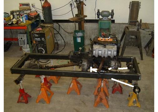

I lucked out on my wheel hunt at the bone yard!
I found two 14"x7" wheels and two 16.5"x9" wheels.
On the left are the orignal samuria wheels and on the right are the bone yard wheels. I start by carefully slicing thru the welds on the back side.
Then I sliced the rim from the back side being carfull not to cut into the center much. Here it is from the outside, you have to connect the slices in the middle.
A couple whacks with a hammer and out comes the center. Here is the backside.
Here I'm cutting the center out of the 16.5" wheel, I'm leaving a small lip in the wheel. 16.5" wheel with the old and new center.
The plan is to clean everything up and carefully weld the samuria center into the 16.5" wheel. It will look something like this.

I wouldn't know how to fixture the wheels to get the center in the uh, well center.
Maybe you can show us how you are doing that? Or is it just +/- 1/8" and call it good?

I welded up the rear 16.5" wheels tonight.
After cleaning up all the surfaces I used thin alum "shims" in three places around the wheel center. I then clamped the center down and put 3 good tack welds in place to hold everything.
I then mounted the wheel up on the front hub and gave it the spin test.
Everything looks good with the spin test so I added 3 more tack welds to the back side and then proceded to weld the front side.
I welded in about 4" increments going back and forth 180* to spread the heat out evenly and hopefully keep the wheel from warping.
I then fliped the wheel over and welded the tacks into 1" long welds. After cooling down I mounted the wheel for another spin test,
and amazingly the wheels came out as perfect as my eye ball can detect!:)

Ya mean ya didn't put a dial indicator on them.:D At tractor speeds a little wobble is no big deal. I have recentered/reversed wheels and trued spokes with a dial indicator (a piece of wire for an indicator works pretty good too) and hub set-up but for what you're doing there is no need. Looks good!:cool:
I thought about breaking out the indicator for about 2sec, then like you said, hey its a tractor! Not going to be breaking any land speed records!
I did cantaliever a 2x4 off the frame rail and next to the rim, its perfect!;)

She's a roller!:D :D
I've got about 10" of travel under the rear tire till the front axle hits the bump stops.

GT2, just one curious question:
Do these axles have different gear ratios to make up for the 2 different size of tires, or does the diff in the VW transaxle need to even that out ?
I'm not sure if the differential would be happy to turn the satelite wheels all day long. I think they are designed for incidental rotation just when you turn, not to even out 2 different ratios... ??
/ DIY Home built compact tractor
#160
Yes I have a different ratio ( yet to be installed ) for the rear diff.
I'm going to eventually weld the "center" diff in the VW trans; If I dont any one wheel that slips would kill power to all the other wheels.
