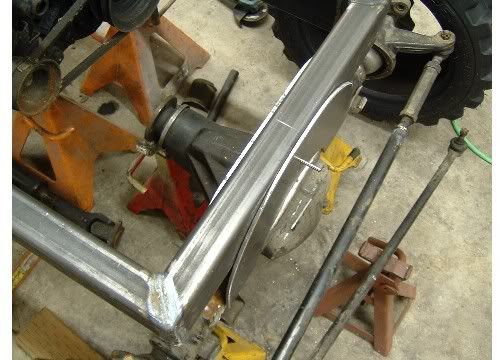

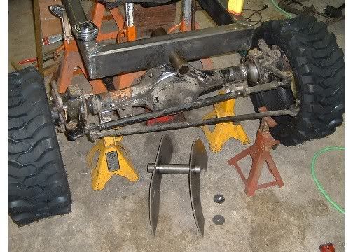

Woo Hoo... I got a little work done on the tractor!:)
I cut some wedge shaped heavy wall rectangular brackets and drilled holes to match the spring perch. I then cleaned and carfully aligned the axle and the pinion angle.
I then bolted the bracket and perch together and placed them on the chassis / axle to be welded.
Here it is hanging all by its self.
Now its off to the wrecking yard to find some wheels worthy of modification.

Any details on the front suspension? I know you were working on a pivot axle with trailing arms.
Nice work.
Doug
/ DIY Home built compact tractor #139
It sure looks like a very solid mount!!
I'm curious about tire size and pressure they will put on the bearings/axles? On one hand, I would think that since you are going slow, it won't matter too much, but on the other hand, larger tires do a real number on pickup trucks and cause all sorts of problems.
Thanks for the updates. It's nice to see progress and that you are still working on it.
Eddie
#140
Doug: Go to page 8, #72 for details on the front axle. I've decided at this point trailing arms are not needed, knock wood:)
Eddie: I'm using relatively ( to tractors) small diam rear tires, about 30".
From what I've read the Samurai use up to about 33" without bearing damage, but they do snap axles.
I'm hoping not to be in a situation that snaps axles, but if I do there are HD axles available that are not too expensive.
