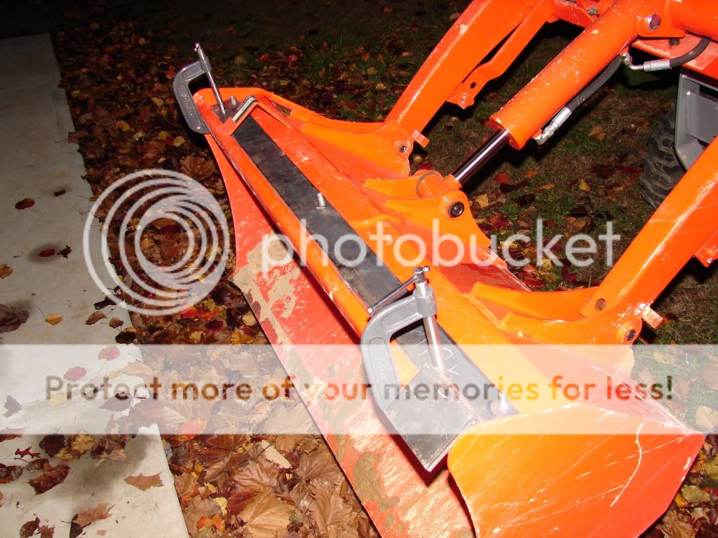

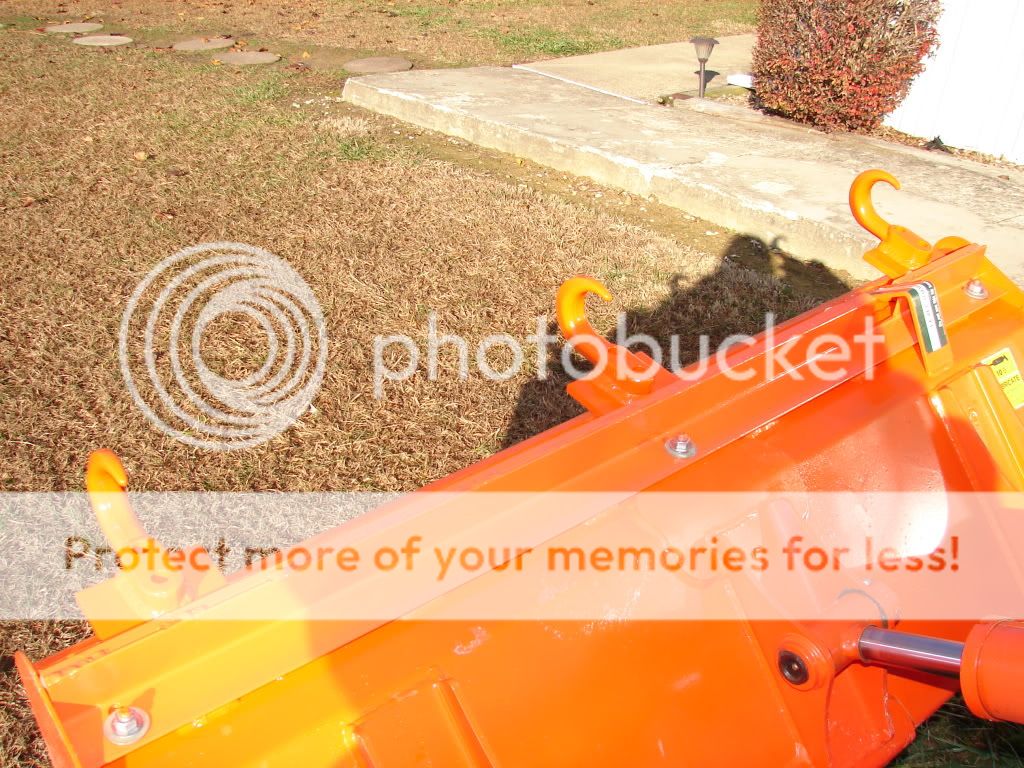

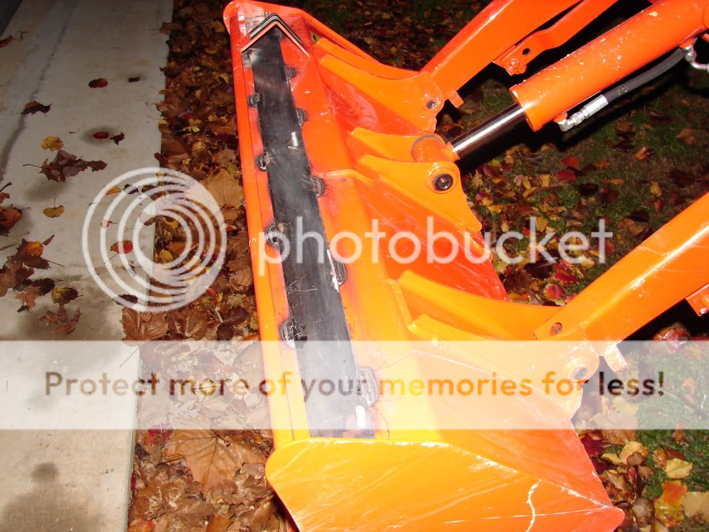

I finished making my adjustable FEL grab hooks and gave them their first workout on moving a 300# weld table. Worked wonderfully on that load. What I wanted was a hook system to be installed on the FEL lip that could be adjustable or removed if necessary.
I started off with a flat 1/4" bar with studs welded in to hold an angle retaining bar. This angle clamps up against the hooks and holds them firm against the lip. I made three hooks from 10,000 rated tow hooks.
Here is the install

/ DIY FEL hooks #2
Looks great, nice work and neat. 1 ?, well they lock themself up if you get a little side ways pull?

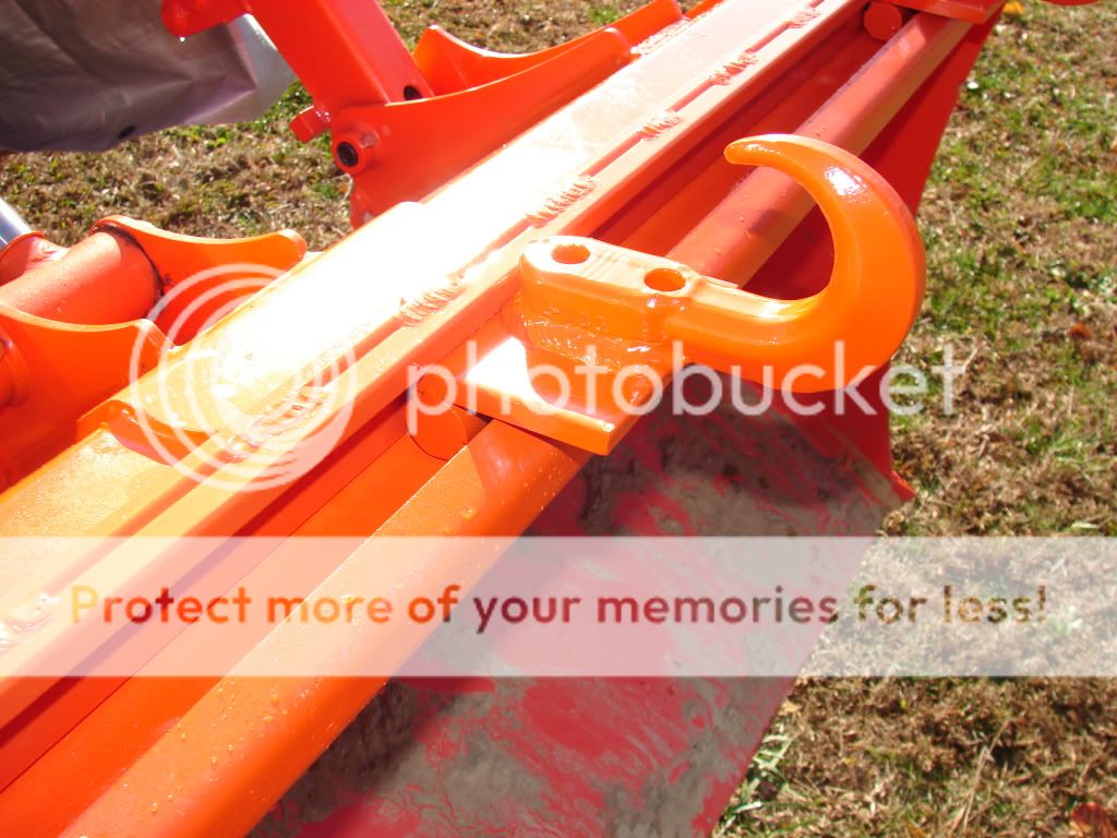

/ DIY FEL hooks #3
Very nice work.
Really like how you can adjust them.
Can they be removed completely if needed? Do they rattle without a load?

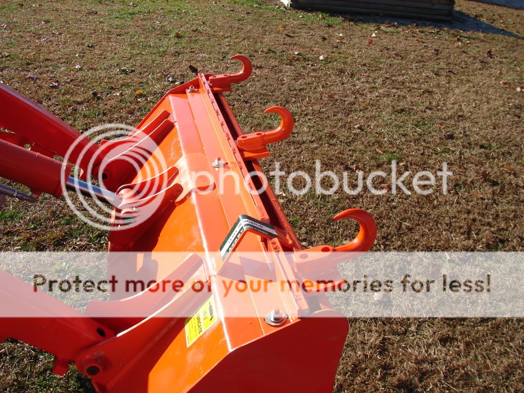

/ DIY FEL hooks #5
Looks like you can loosen 3 bolts and move the bar backwards to release the tension on all the hooks. Then you can move or remove the hooks.
/ DIY FEL hooks
There is no rattles and they can be removed as the gentleman described, three 9/16" wrenched nuts. They lock into place using those 1" solid bars under that lip.

/ DIY FEL hooks #8
That looks like a slick idea, any idea of what the added weight is? I am guessing 10-15 lbs.
/ DIY FEL hooks #9
Heck of good idea.
Keep us posted along w/pics when under load.
/ DIY FEL hooks
They picked up a 200+ weld table and did not budge.
