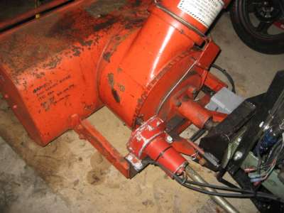

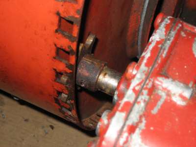

When I decided to add rotation and chute elevation to my Woods snowblower I went the Winch route and ended up buying it off from Ebay for around $30.00 inlcuding shipping.
You can see the connection to the Woods chute rotator.
This winch had a hole in the outside end that I could mill down a 1 1/4" aluminum pipe to fit into. Then I drilled a hole through the winch and pipe to secure it in place.
I used the winch control and wired it so I could mount it on the plexiglas I have mounted across the back of the ROPS (used tie wraps so it is easy to take off in the spring) The yellow one controls the chute rotation and then there is a black box above that controls the linear actuator that is conected to the chute deflector.
This year I picked up a 51/4" stroke 12 VDC linear actuator off from EBAY and it is what I use for the deflector. Works just fine.

Oh Iike that. Looks very factory! What supports the other end of the winch drum though? Did you loose the freespool feature of the winch? Did the snowblower chute rotator already have a U-joint or did you add that yourself?
MORE PICTURES!:D (With less snow blocking view)
I have a Woods SS-60 snowblower and the u-joint was already on the chute rotator. So what I did was add a plate to hold the winch and then adapted the aluminum pipe to fit inside the drum on the winch and the other end to fit into the u-joint.
Last year I purchased the first winch off from Ebay and adapted it to work with the chute. It worked okay, but the winch was really cheap and it wasn稚 easy to connect up to. I ended up using it but this past summer I found another winch, again on Ebay that someone had taken off from his 4-wheeler and it had the opening on the end where that was much easier to modify.
This is the first winch I purchased and used the yellow controller:
eBay Motors: WINCH KUBOTA RTV 500 900 RTV900 1100 JOHN DEERE GATOR (item 300285168656 end time Jan-12-09 22:41:23 PST)
These are manufactured in China, really a piece of junk! But, when I bought it I paid like $35 plus shipping for it, so it was cheap. The second one was much better and about the same price, but it had been used!
