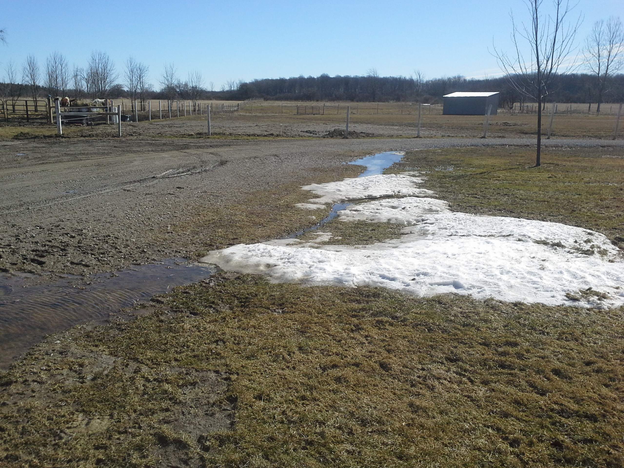

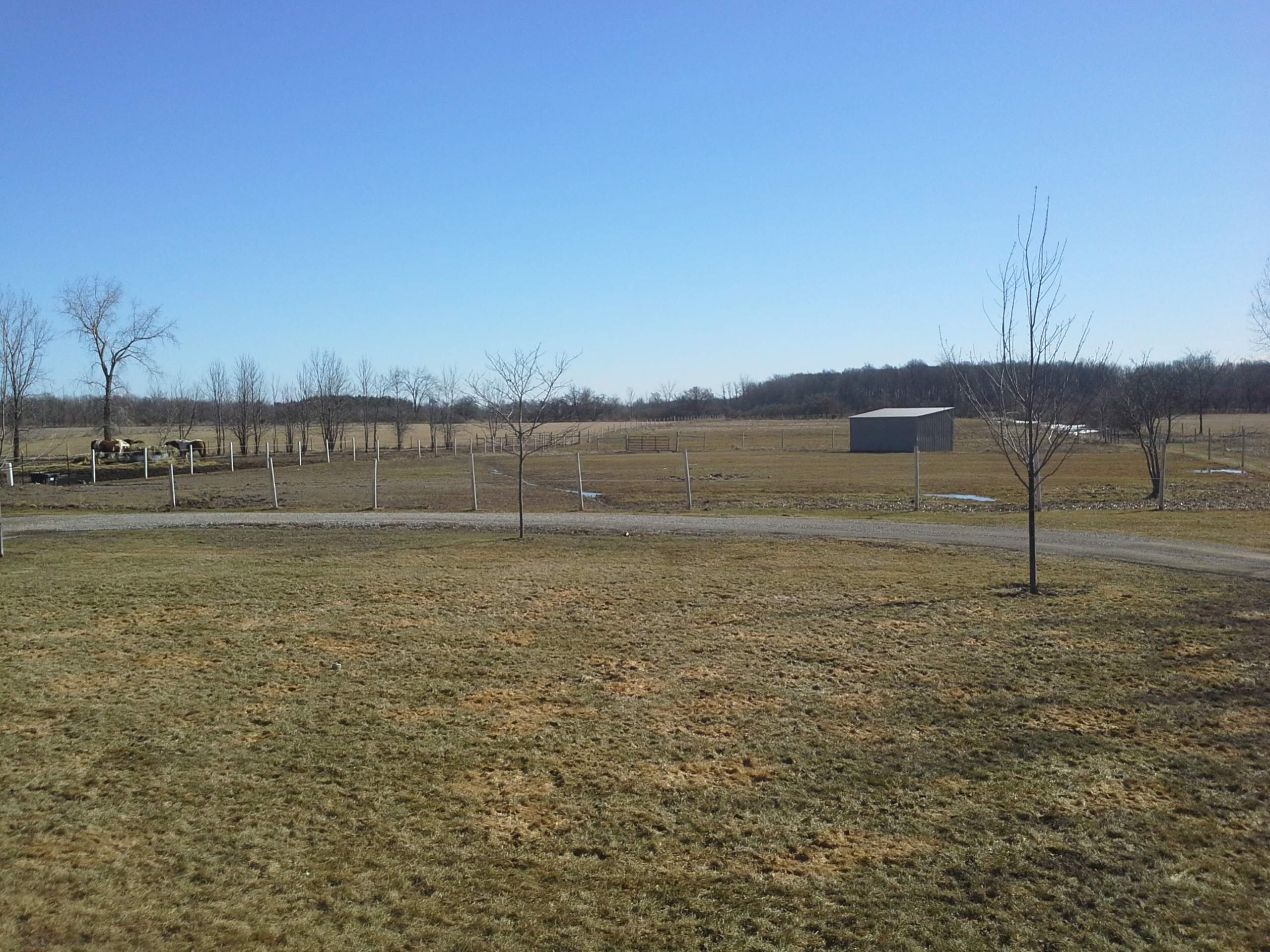

It doesnt take much to get water to drain. I have a relative flat landscape that pooled water. A slightly elevated driveway (3-4") acted as a dam to retain water. The pastures had some natural drainage tendency but there were some rises that captured and pooled water. This made a mess of things.
After some examination of where the ideal drainage should be, I proceeded to attack the high spots. I created a very slight ditch along most of the (gravel) drive and tapered toward a spot along the drive that matched up closest to the natural drainage. I installed a 4 inch pvc drain tube across the drive to act as a culvert. Now this may be considered amaturish but I didnt want to tall a culvert that would necessitate bringing a lot more gravel in and give the backyard a commercial look.
I then kept on with the slight surface drainage in the lawn and then pasture til it met up with the nautural drainage. I did not use transits or laser levels. I let the water tell me what it needed to continue downhill.
In two places in the pasture I dug out enough ground that was a high spot daming up water. I installed 6" double wall plastic culvert and covered it back up. These 2 spots were in an area that we needed to drive the tractor through and I didnt want to continually breakdown a surface drainage with the tires going through saturated soil.
The results speak for themselves. This year with the thaw, the drive is dry and solid and the yard and pasture are no longer lakes. I dont know if a picture will show much but ill posts some later.
This took a , minimum of effort and soil disturbance by taking advantage of all natural "drainage" paths and merely connecting them and removing impediments.
Tools and methods:
I used my loader and backblade for most of it, some but not much manual shovel work and for the 6" culvert placements I used my small backhoe to speed things along.
The method was to approach the desired path perpendicular and scrape with the loader to create or enhance a shallow trench. Later I came back with the backblade to contour the channel into a more natural slope on both sides.

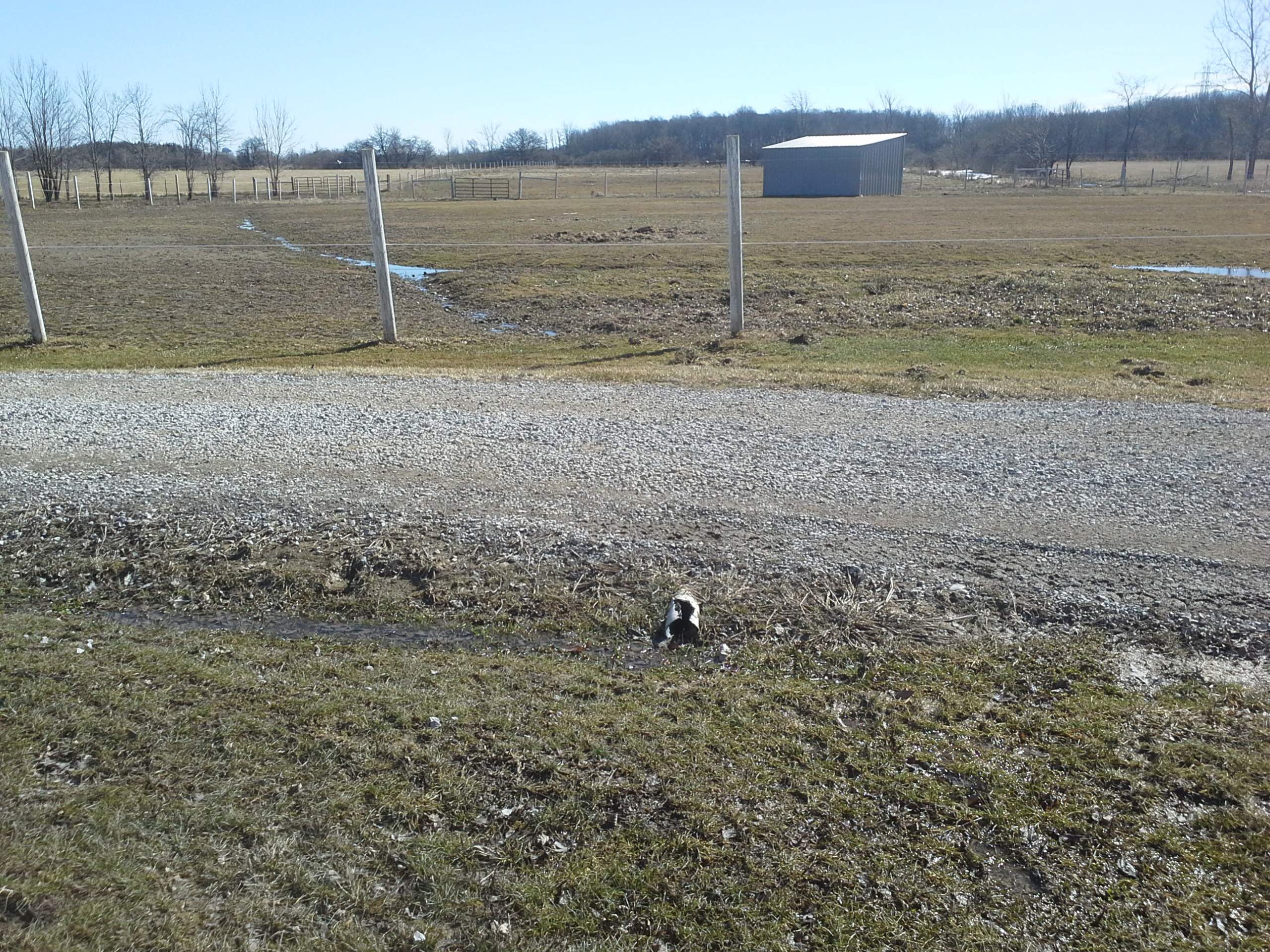

Another tool that could be used is a middle buster to open shallow drain channels. The come back with a backblade to contour the edges. There were times during the project that were dry so ran a garden hose into the channel and let the water show where it needed more slope.
I need to do a little more to smooth some things out and make it look better and clean some areas that I didnt widen enough but it works. Also some areas need more work because I installed a buried water line in the area late last fall.
Before I did this the drive and backyard would get flooded and water stood in parts of the pasture. The drive and the yard in the area pictured with snowpile remnants were flat with no ditch. Also I have since build up the drive with more gravel where the 4" pvc pipe is so I could remove that and replace it with a more suitable culvert. But it works asis.
The picture with the corner of the concrete and gravel drive use to have about 4 to 6 inches of water. Here is where I installed a 6" black culvert that is in the picture but hard to see. Its real rough here because it is also where I buried a water line. Culvert was installed after the water line late in the fall so it need some attention there.
