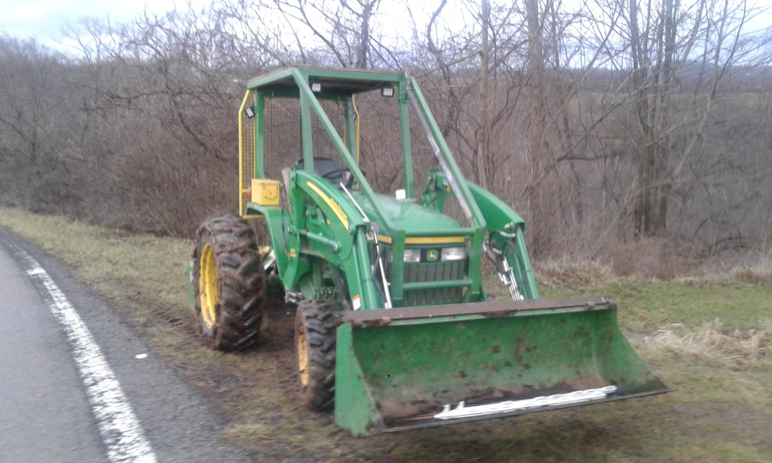

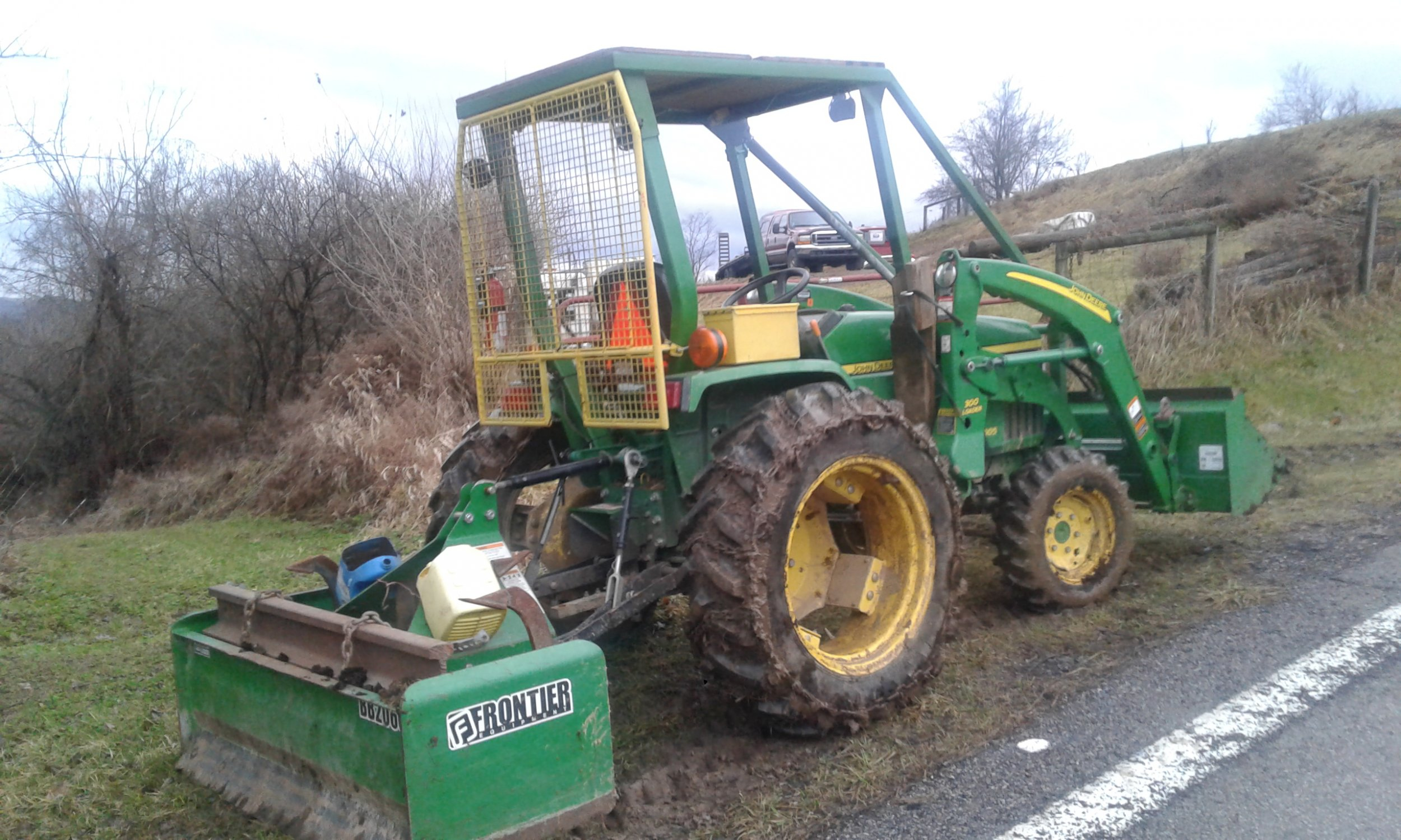

For me, the first objective was rollover protection and brush deflection, the FOPS was an added bonus. Full roll cage with limb risers, rear brush screen. There's a sheet of aluminum in the barn slated for use on the roof... the temporary 3/4" plywood is nearly rotted out... *grin*

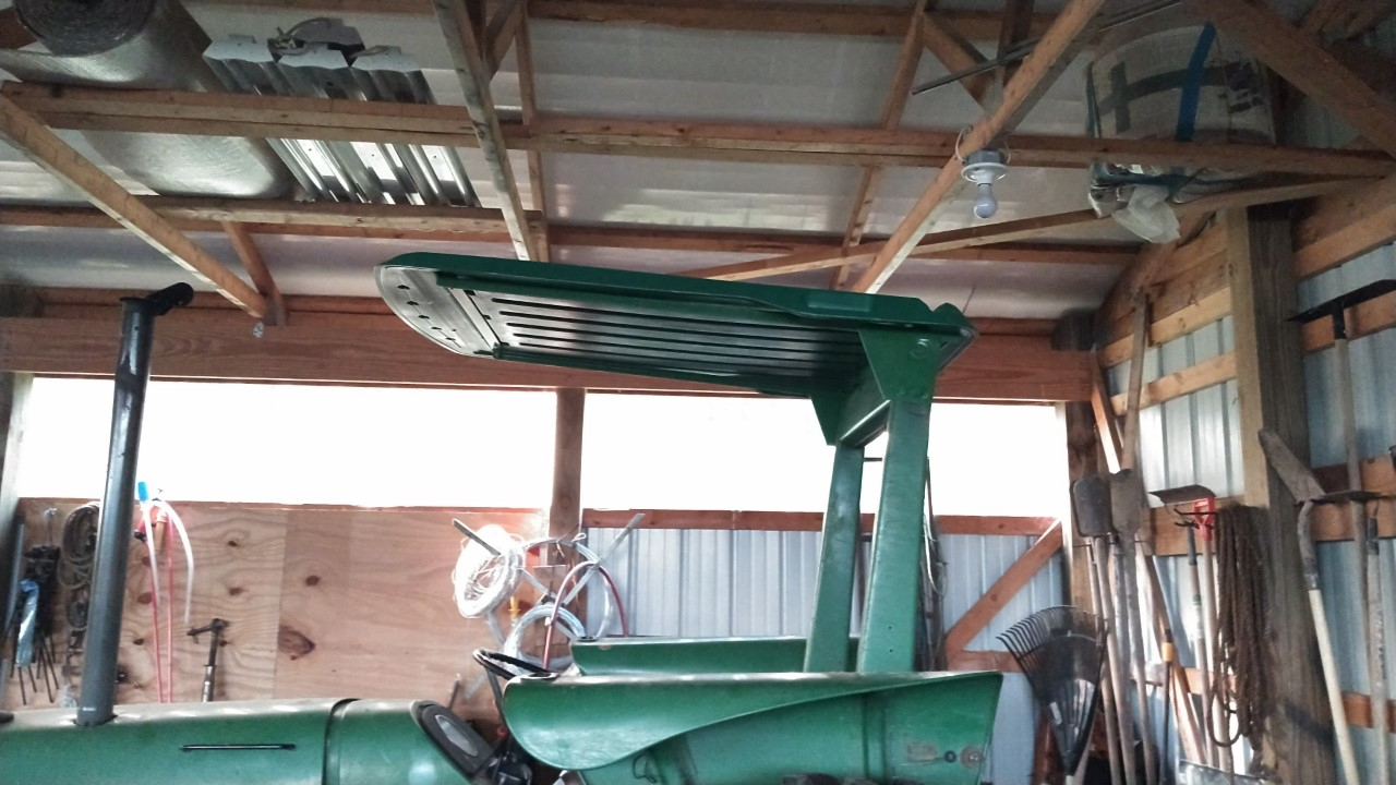

$50.00 golf cart roof for the one old tractor

More than once I've seen a branch coming and wished I had something other than my arm to deflect it. lol I see you've added weight to the gannon too. That definitely helps them cut. My old Terex had a 1000 pound box that sunk like a stone in water on most material.

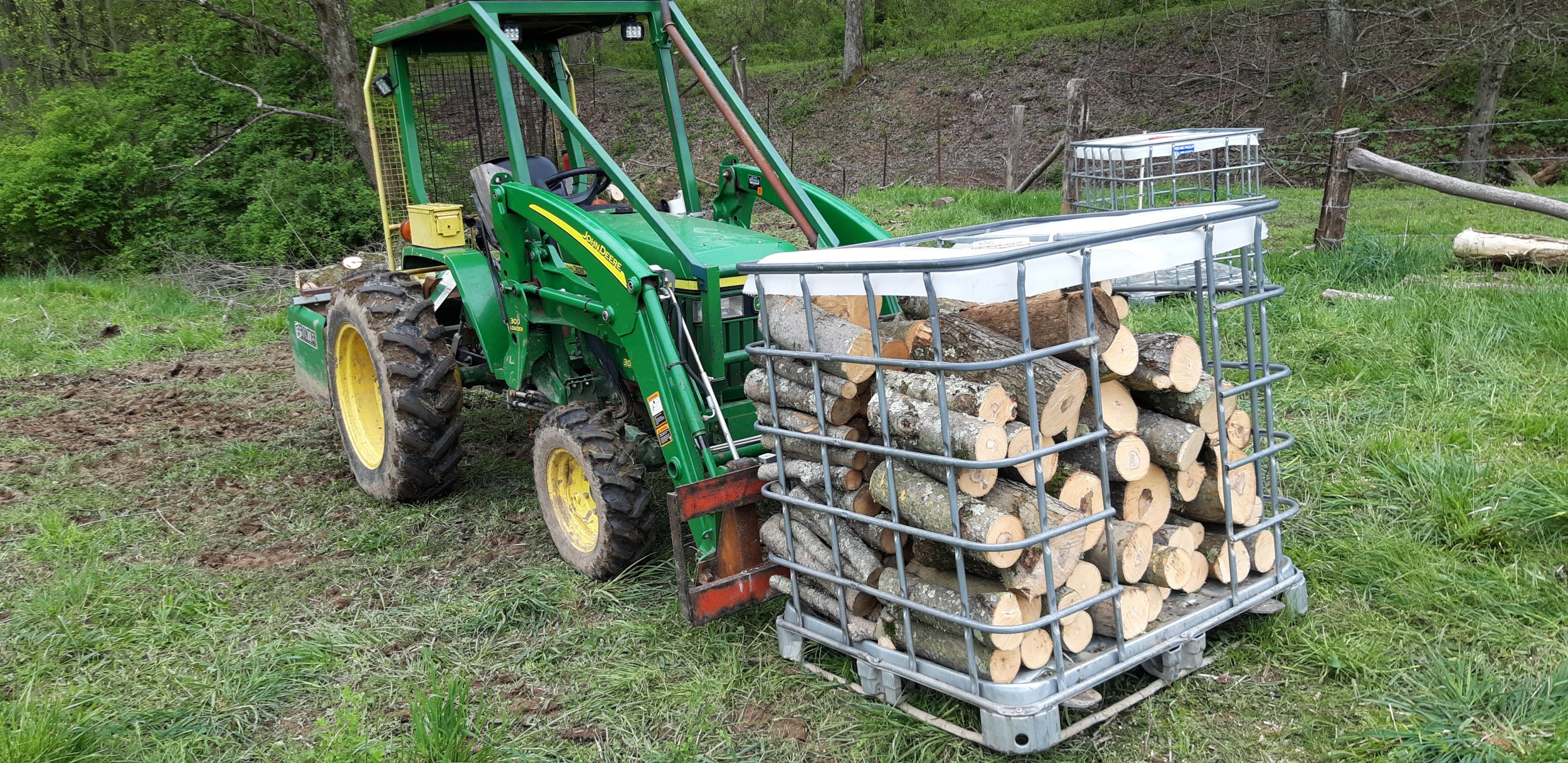

Extra ballast out back is mandatory, I have forks on the loader 98% of the time. I put anything I can on pallets or in IBC tote cages. We recently moved to a new farm, I've got 14 of the cages in the barn waiting to be unpacked. They work great for firewood under normal circumstances.
