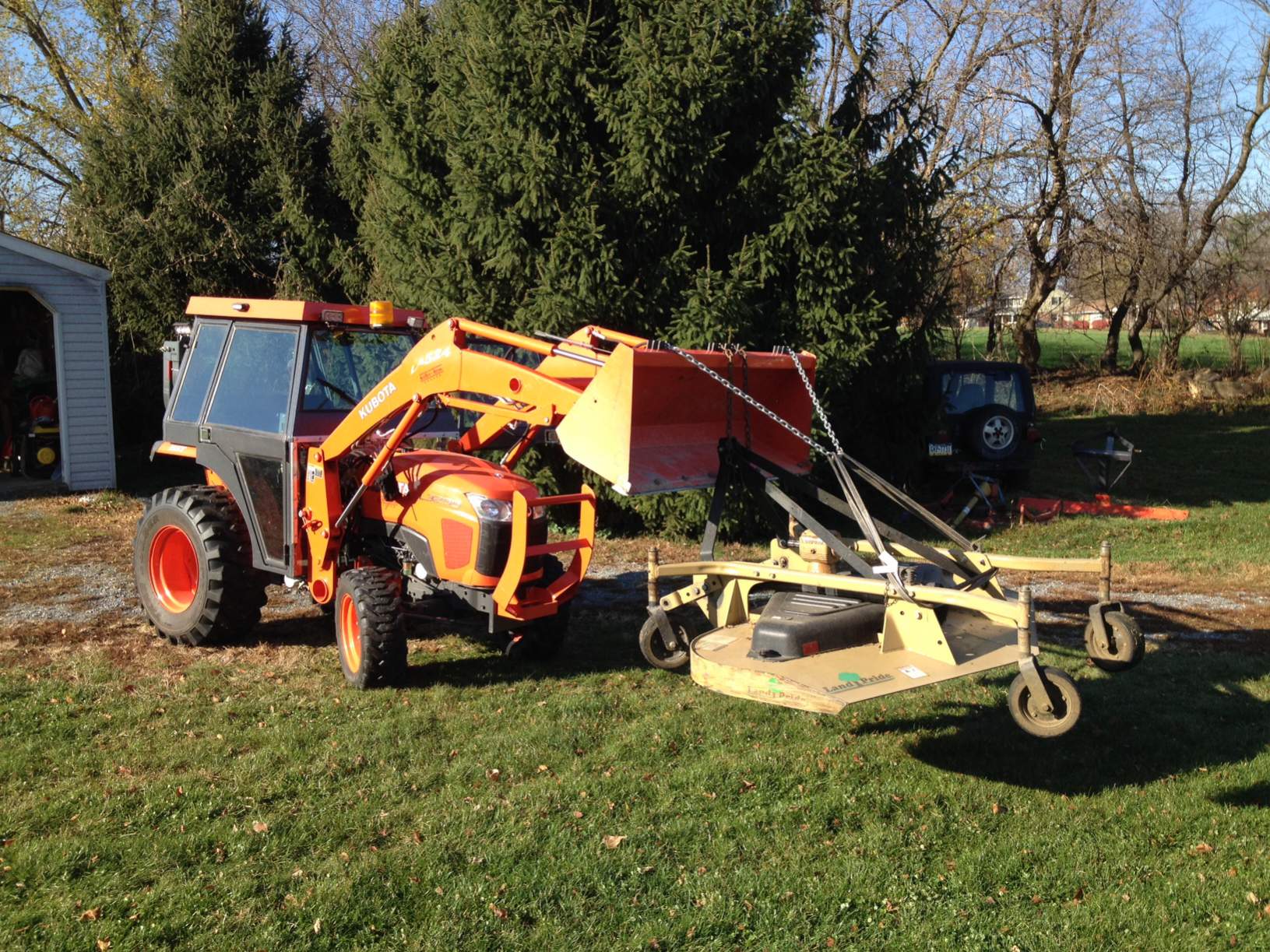

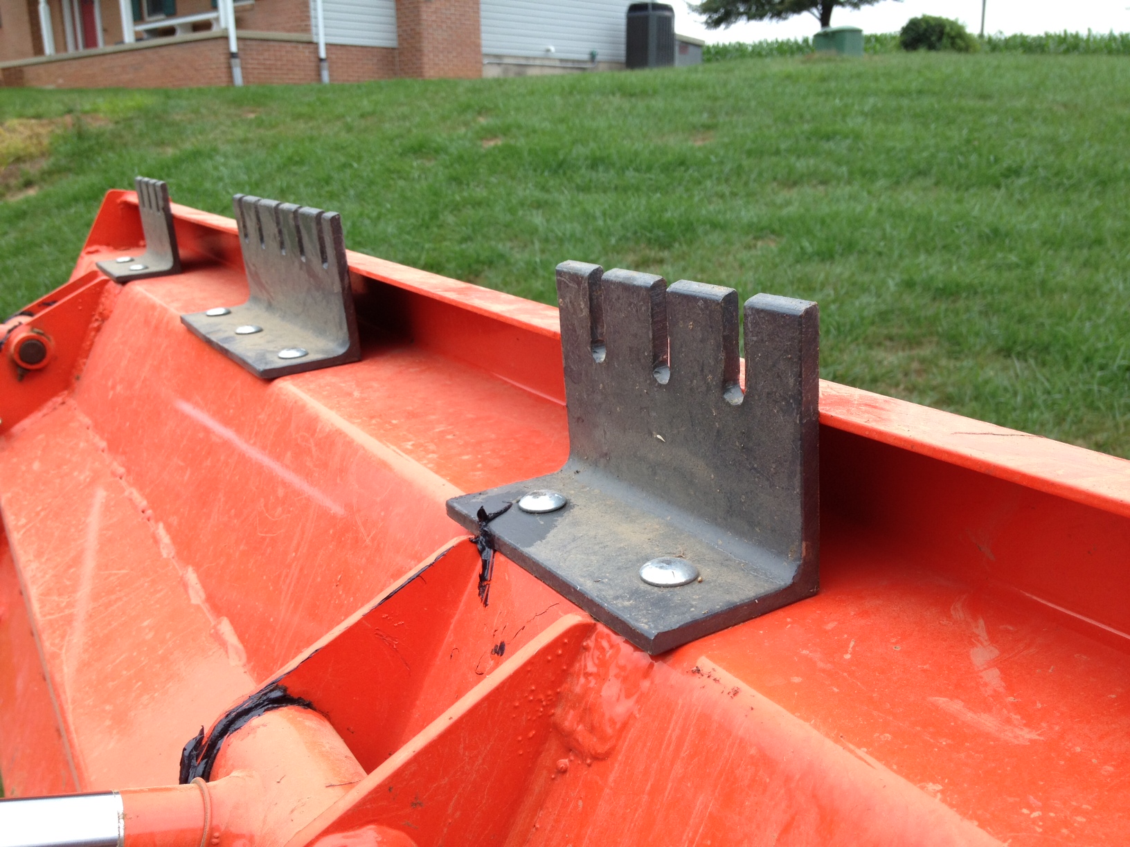

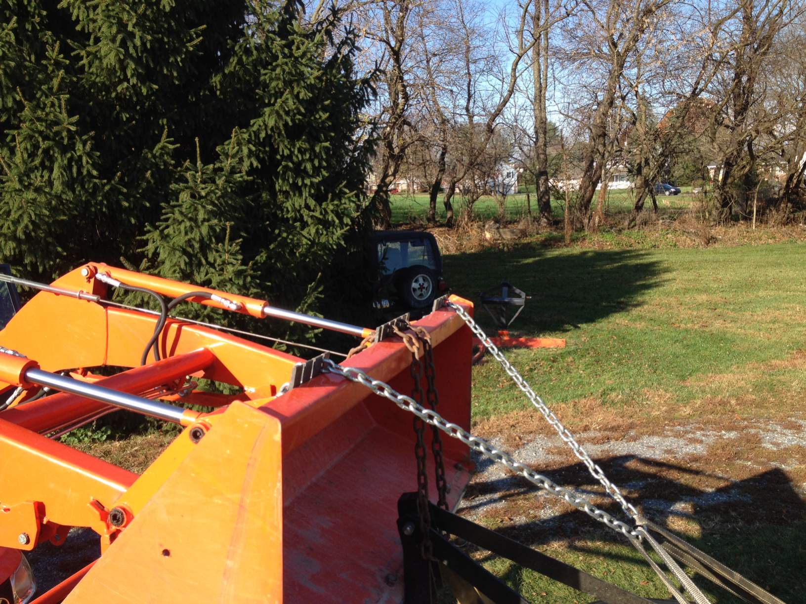

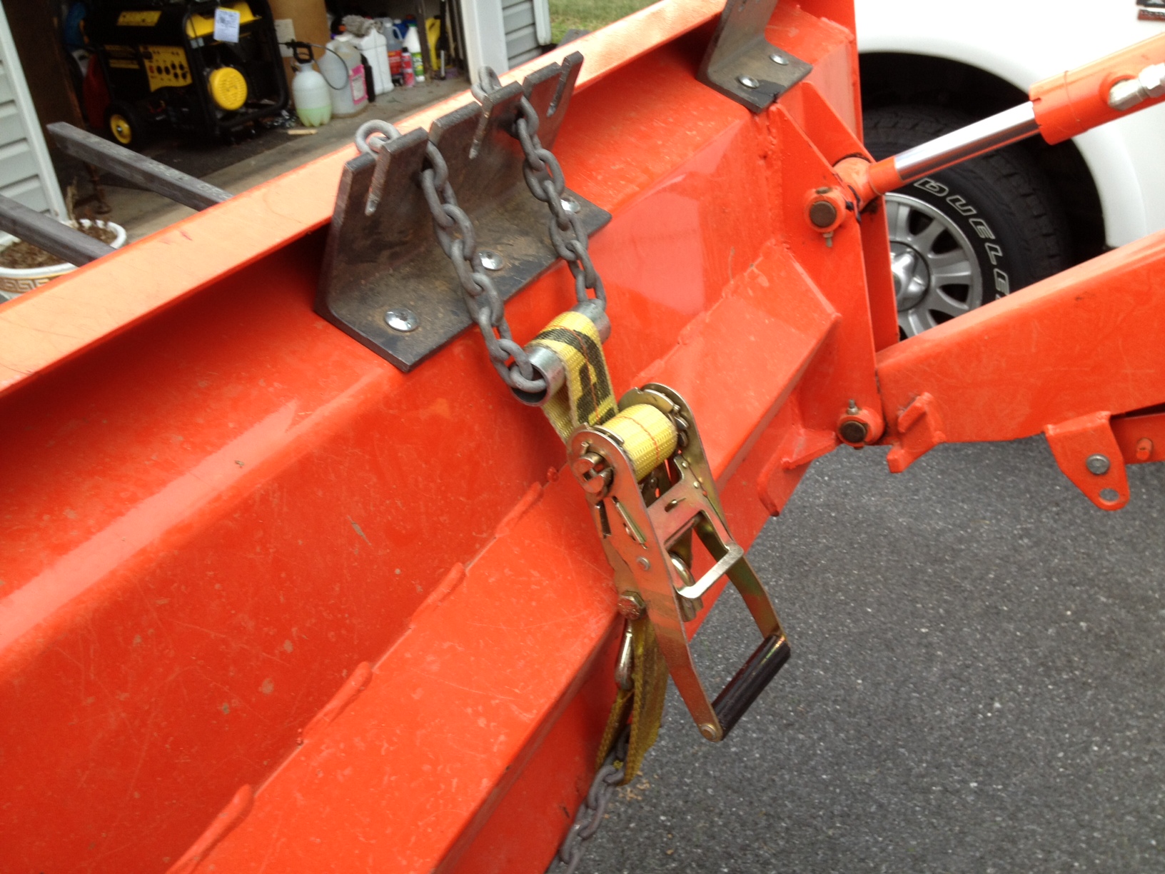

As far as convenience, I prefer to have something already there and not needing to hammer them on and off. I started using heavy angle with slots back around '02 or so with the first Kubota. The chains can be used either in front of the bucket or behind it. Having slots distributed on the bucket allow flexibility for different load connections.
I can set and unhook a load by lowering it to get all the pressure off the chain, then dump the bucket all the way, lower it as far as possible and back away from the load. The chains stay in the slots until I make them come out. Extra chain not needed for loads can be dropped into the bucket or tossed into the remaining unused slots.
The fourth picture shows the load binder adapted to hold the forks on the bucket. The slots accept 3/8" and smaller chain. Strength has never been an issue The picture on the right is from a few years ago when the Ford had a broken wire and wouldn't start. It was easier to pick the front end up and play "wheelbarrow" using the L3200 to bring the Ford to the tools

Plus 1 on slots for chain. :thumbsup:

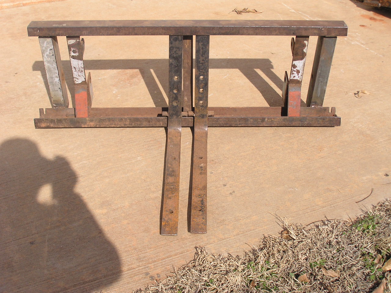

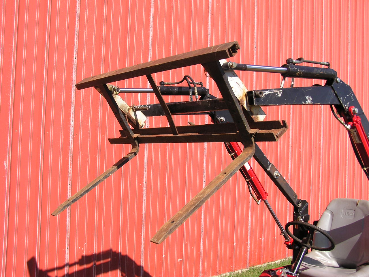

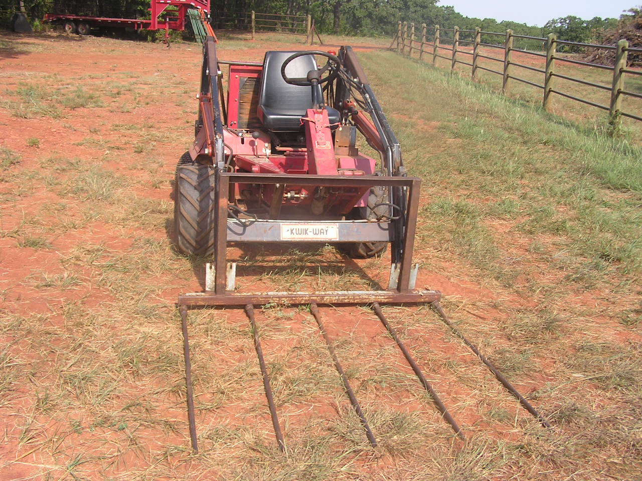

I put 2 slots in the bottom channel iron frame about 34 years ago, when I built the fork frame for a loader on a Sears garden tractor.
It fit on the TORO+Loader when I created it in June 2005:
Added the outside angle to make it work better on the TORO+Loader:
Put 4 chain slots in the brush fork frame when I built it 12 years ago:

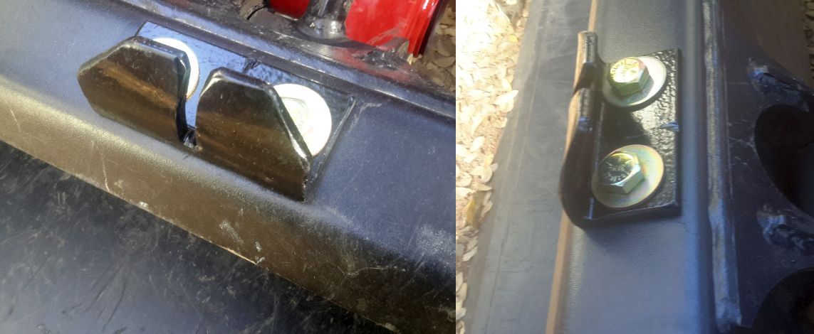

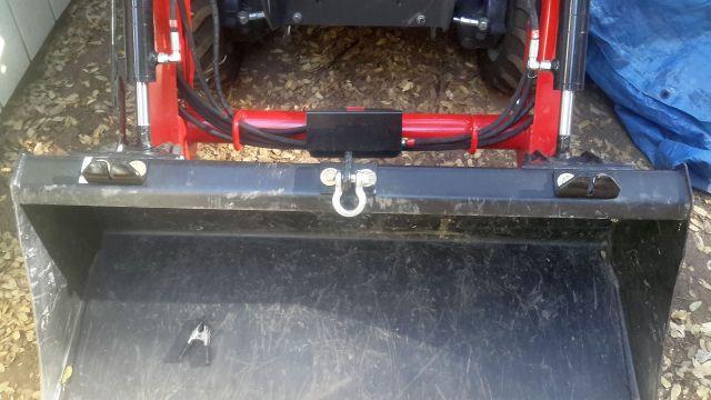

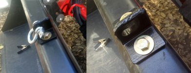

This is what I did...Thought long and hard about adding "bolt on hooks" and just could not seem to make that purchase...
Materials are 2 x 2 x 1/4 steel angle and all bolting materials are 1/2 inch Grade 8... Slots were drilled 5/16 about 1/2 inch from edge of angel (targets for saw work) and hacksaw was employed to cut slots... Angles were also heated and curved over a bit for for better chain retention (I hope)...
Center "eye" is two pieces of angle welded back to back to form inverted "T" and drilled 11/16 for 1/2 inch shackle... Funny part is 1/2 inch shackle has 5/8 pin...
Since bucket materials is actually thinner than brackets I have no fears in brackets failing, my only concern will be not bending bucket lip....
And if you were wondering spring clip holds tarp in place when tractor parked...
