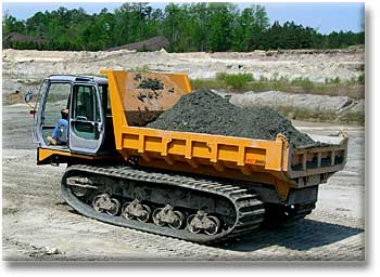

I have done some investigating into a crawler carrier. Has a bed about the size of a full size pickup.
$3,000 for a week rental. Looks like it’ll carry about 5 tons of dirt at about 6MPH. Much slower than farm tractor with high cap 1.5yd bucket, but probably carries 3-4 tractor scoops at a time.
